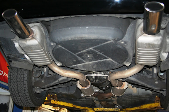

Just got POS back from some blessed xwarranty claimz - ROI's never cease!
After nuking bank2 coilpack daze after ECUflash, it's sister up and f'd ze pooch a few weeks back. Both 'covered' - muwhahaaa.
A case of while-you're-in-thar sets in, and a TCU flash / lowering / resonator & Ypipe delete ensued.
Now... just look @ this disaster (note OEM ball/socket joints, we cut/reused them):
The thought of touching the wheels back down off the lift w/ this clusterfuch of design simply nauseated me. 2 into 1 into "u" crimp into 2 w/ each of the 2 squished flat and 1 of the two into a hard tight 90 into resonators? (that 2into1 center pipe was a rather hilariously enormous whaledick looking gargantuan near square tube)
fuchthat
clusterfuch, begone! (craaapy cellshot sorry):
Cats into (near) straight back straight thru to dual mufflers. Seeing full F to R 3" piping which goes on seemingly forever is a chuckle unto itself, John's work pure artisan...
JNR!
Resultant flow is s0o0o0o0o0ooo exploited, the whole tq curve shifted left - throttle response now near retahded. It's like gaining 1/2 a gear.. insaneo.
and the sound - oh the sound
Power deployment is like igniting a pair o' nuclear reactors - I've never heard one (or 2), but I'd imagine this is what they sound like...
vaWOOOOOOOOOOOOOOOOOOM!!!!!! (squared)
to me, the sound now is spot-on - decels are nearly more giggling than accel, imbibes the beast w/ desperately needed character

You've heard it before but I cannnnnnot say enough about working with John @ Broadway Performance. UDAMAN, Johnny!
Worked the big picture from start / finish in such seamless ease and pleasure. Aside from just being a cool car dork (good to be among fellow geeks!), his passion to accommodate please execute deliver shows in every aspect of his work.

it is much better, but there are still a few leftover software gremlins I'd prefer gone (shows 4 but then grab a downshift and it goes to 2) - but it is much (much) better overall
heh, yeah... I too am sooooooooooo glad I did the exhaust - WHAT A DIFFERENCE it makes!!!
