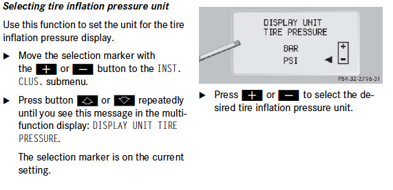

My '05 owner's manual shows this (click on image to enlarge):
Reply 0
Apr 29, 2015 | 01:34 PM
Thanks for the reply. Yes, you are correct. 2005 and 2006 are OK. 2005 S-class Operator's Manual page 308 says you can select the unit of measure and page 162-164 show how to do it. Same for 2006 S-class Operator's Manual page 309 and 162-164. 2003 and 2004 seem to have a conflict in the Operator's Manual. 2003 manual page 274 says you can select the unit of measure with reference to the Control System menus and page 275 shows a picture of the display in PSI, but page 148-150 (Control System submenu for Instrument Panel) doesn't show anything about it. The 2004 manual is bit more confusing since page 285 says October 2003 and older cars can select the unit of measure with reference to the Control System menus, page 287-288 doesn't show this choice for October 2003 and newer cars, page 288 shows a picture of the display in PSI but page 153-155 (Control System submenu for Instrument Panel) doesn't show anything about it.

I referred to my electronic copy of the '04 owner's manual in response to your post at 7 above; most puzzling, indeed.
Likely, as you said, there was a change, either in the TPMS computer (controller) or in the display software. Irrespective of the manual, to which you have obviously paid close attention, are you able to locate a menu in your car using the '05 instruction above? I ask because the COMAND electronics in the later production '04 were shared with the '05 and '06 (though the phone systems were quite different), and I had hoped perhaps the menus might also be shared.
If you're like me, you have already done a number of TPMS system resets. If you haven't you might try several. And the last alternative MIGHT be to deflate your tires, then re-inflate to at least 37 psi (the pressure needed to activate many brands of TPMS sensors). Once that is done, try a reset; and if that works out, deflate your tires to the proper pressures.
Beyond that, I'm out of options short of having the dealer try to reset the reading using DAS.
