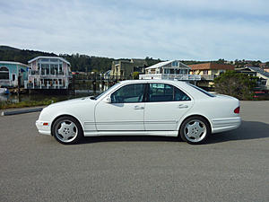

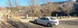

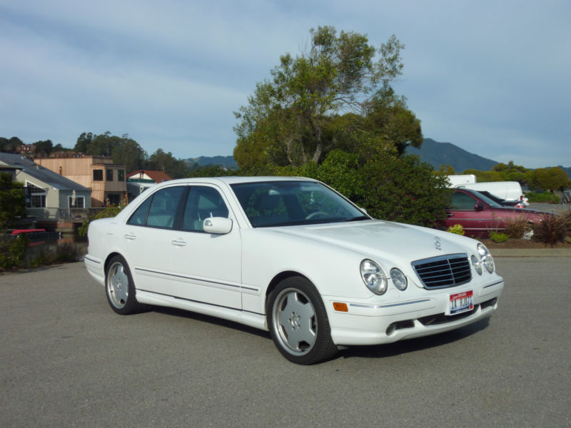

Pix for clicks attached.
Attached Thumbnails An interesting warning against an S600 (w220)?-045.jpg   An interesting warning against an S600 (w220)?-040.jpg   An interesting warning against an S600 (w220)?-041.jpg
