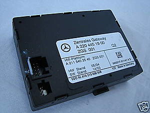

My 2005 S55 AMG had a battery drain. At first I would pull the neg cable off every night. Then I bought a battery disconnect switch from harbor freight for $10. That was better. Then I traced down the circuit in the can bus that was keeping the car "awake", and I would unplug that. I ended up installing a relay {under the diver side floor} that would open the can bus circuit that was keeping the car awake. I used a normally open, double pole double throw, relay that broke each wire {2 of them} feeding into the can bus, {the command unit circuit, in my car}. I wired the coil of the relay to power up whenever the key was on. That solved my battery drain.
You could also do the same thing, with a relay, to kill the power that feeds the central gateway under the dash, or unplug the central gateway over night. It is under the drivers side kick panel to the far right. I think, if I was you, I would kill the power to the central gateway with a relay. That central gateway is the "master" to the can bus. Kill the central gateway power supply and it can not keep the car awake when you shut off the key. The lower plug in the central gateway is the power supply. Use a relay SPST to open the ground {brown wire}. I have not actually tried killing the gateway to stop the battery drain, but I'm pretty sure it would work. The canbus circuits feed into the gateway. Disconnect the lower, two wire plug on the gateway overnight. If the battery did not drain, then my "fix" , a relay cutting power to the gateway, will work. I'm almost positive it will work. I know this because I forgot to reconnect my gateway one night and the battery did not drain.
