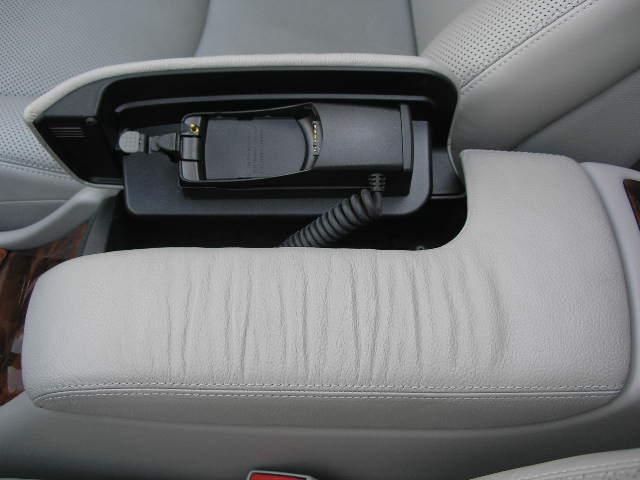

This is what mine looks like in the S500 as it came from the factory. It has a Motorola V60 blue tooth puck that sits in the empty slot. Has worked with every phone I have owned via the command and/or voice commands.

I do not have the cradle. I plugged the "puck" into the connector below the shelf floor. It seems that I may need version coding. Thought I am still researching. The puck and my cell phone have found one another; Command says no telephone. Thank you for the picture and the response. John
