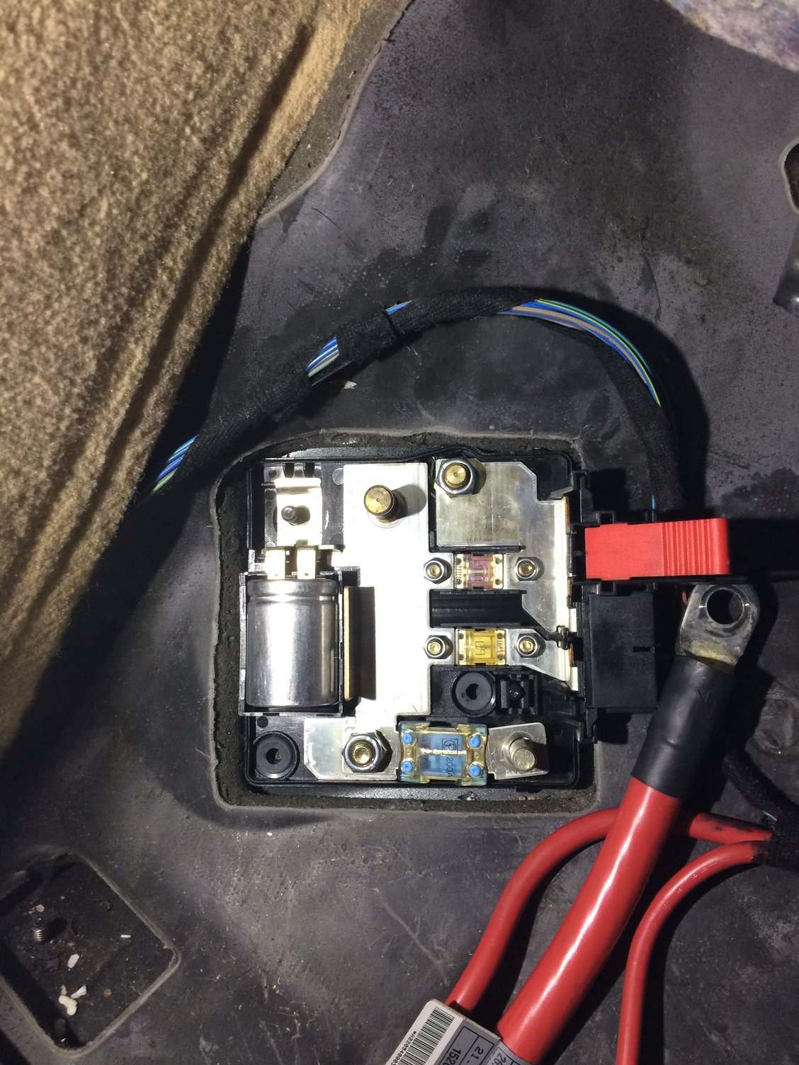

Old Dec 31, 2019 | 11:41 AM
wallyp's Avatar
Joined: Dec 2012
Posts: 2,473
Likes: 439
From: Ball Ground, GA (N of Atlanta)
2003 S500 2007 GL450
Old Dec 31, 2019 | 11:48 AM

Dear all, there is a fuse in the back, right side. A 60amp and 100amp. I broke it when I should control it, so I replaced them. Simultaneous I made a new ground from battery to the chassis and clean the others. This help a little, but I am not finished. Now I have to move forward. I will write back 💪🏻
