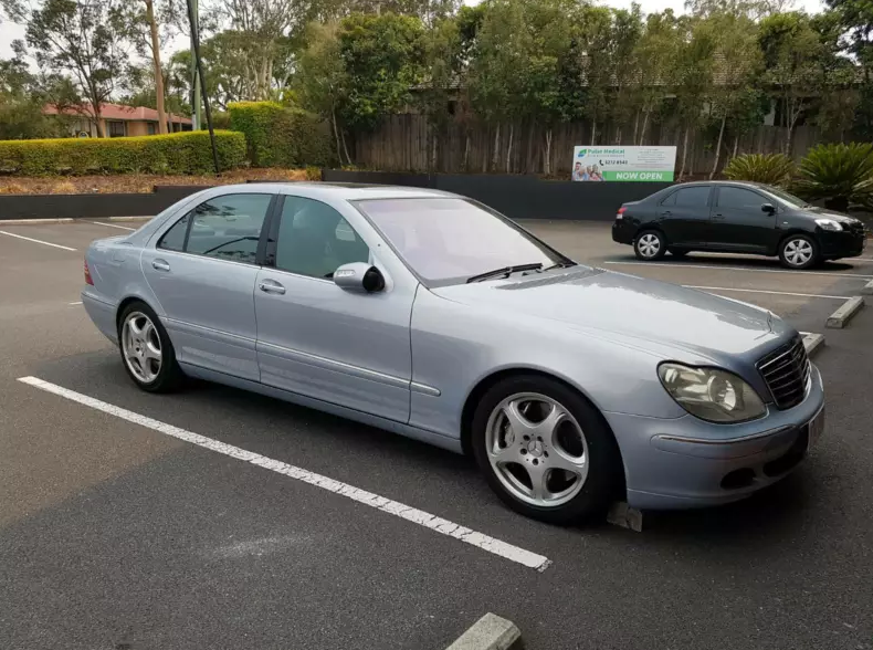

Hey everyone! Exciting times, I've just bought my 4th merc.
Previously had an R170, R171 SLK55 and a junk E class.. Now, W220 S600 biturbo... something I've been chasing for a long time.
Firstly, I have a youtube channel (https://www.youtube.com/c/QUICKSHIFTtv) where I'm covering the build of a V12 twin turbo Supra... and the idea was to grab this S600 as a tow car for taking it to events... why not?? We are going to cover a heap of things in videos about the S600 too, in case anyone is interested in following along with the journey. I expect the car to arrive next week (it is being transported ~4000kms to get here)
The purchase itself was a fun story. I bought it non-running... had it towed to the depot but the ABC suspension had sagged too far and they couldn't load it onto the truck. So I had MB send a new genuine (omg $$) ignition voltage transformer to the depot as that was my best guess for getting it running, and whooo it worked! So now my broken S600 is fixed before I even receive it.
Naturally I'm already planning what to do with it but theres so little information out there about how they're built.
First question, can anyone tell me if the transmission differs in internals / strength to the S65 models, or are they the same? I'd like to know how much torque I can push without being worried.
Second question, do they have a limited slip differential or is it one of those fake LSDs that squeeze the rear brakes like my SLK55 did? I saw ONE video of an S600 taking off abruptly on youtube and it left a single line, which makes me assume the latter
My VIN for reference is WDB2201762A352608
Should be some fun things going on. I own a workshop with a dyno and tuning, modification and fabrication facilities ... so the first thing I'll do is shove it on the rollers and see how much power it puts down. Then start playing.
Thanks for your time!
ps. God damn blue is ugly.

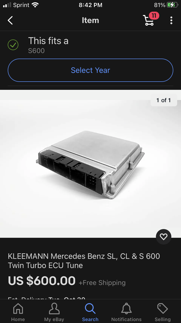

the best tune module is the kleemann tune on eBay , kleemann sells direct
where is the car located ? I’m in California. Seems like you might be in Europe which would make a trade impossible lol
Thanks for the tip on the kleeman tune! I'm in Australia, even harder maybe haha. I love black but I've never had any love for the CL chassis.
