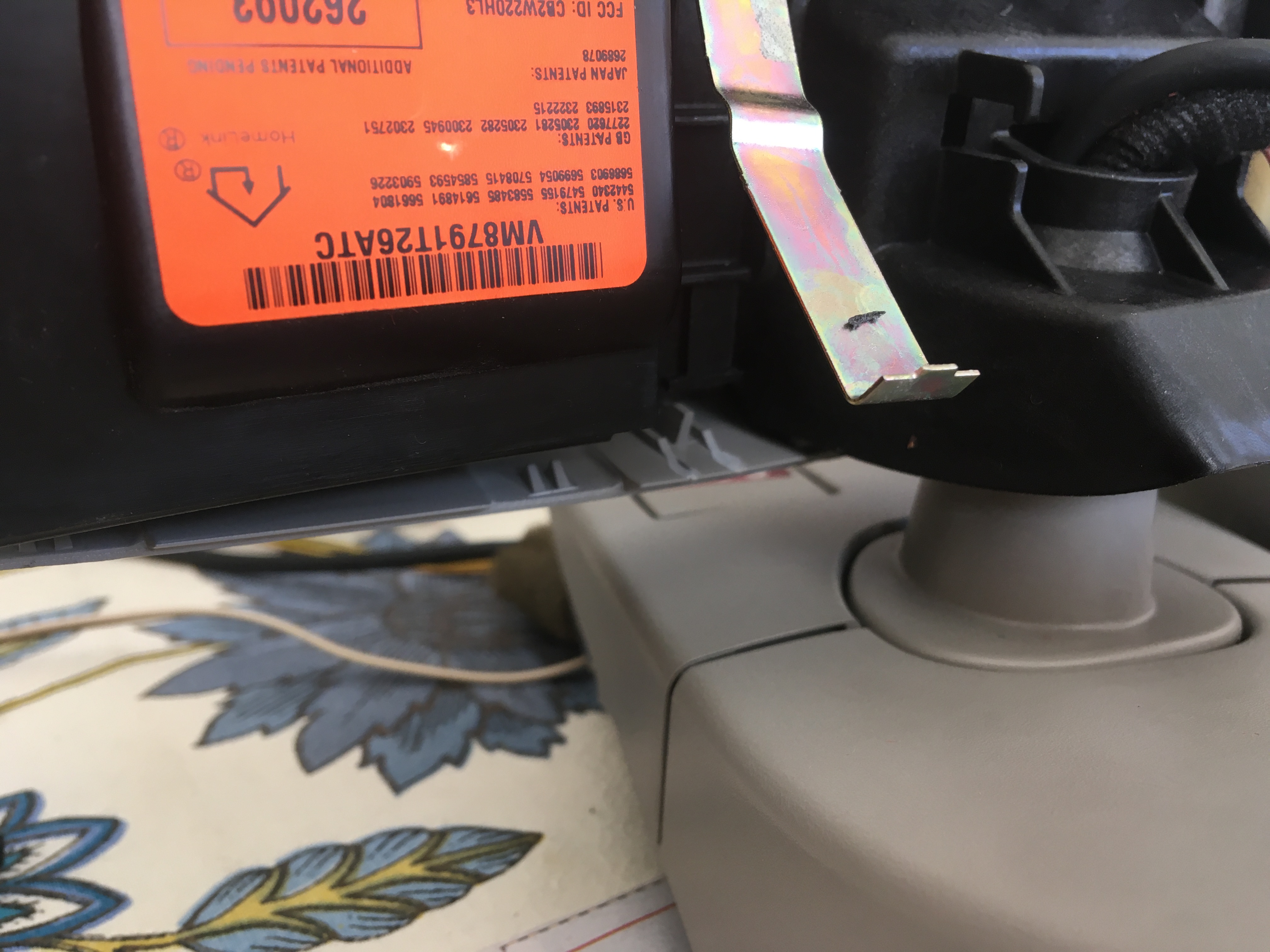

Found the problem, and came up with the most ridiculous solution but I think it'll work. You can click all the pictures to get a high resolution version.
The mirror (actual glass mirror) is held onto the manipulating mechanism by two metal spring/pressure plates held in by clips in the outside plastic:
As you can see, my top tabs (on the bottom of the image) are broken making the whole thing loose.

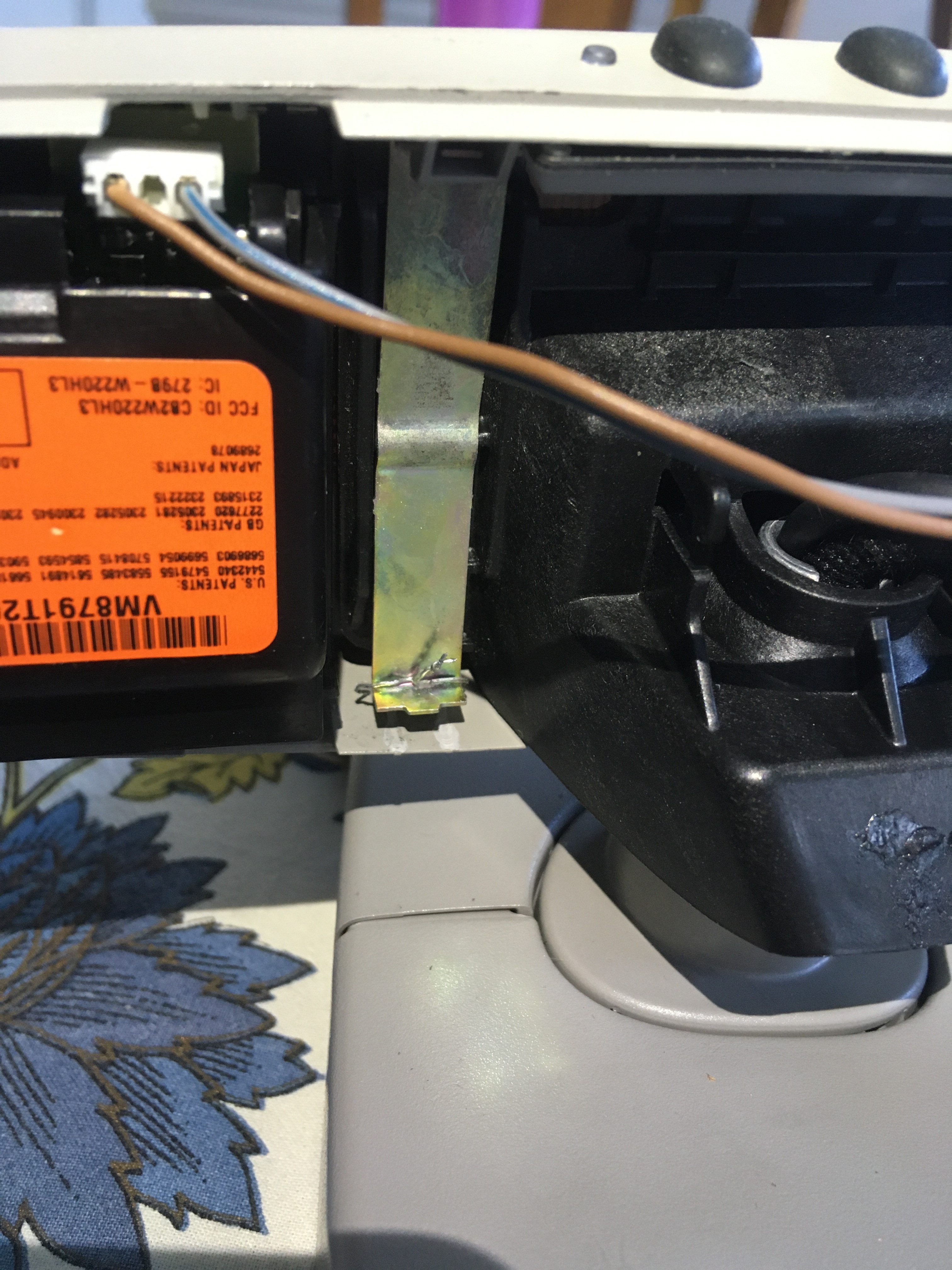

What I ended up doing was drilling two small holes into the plastic, and then used a metal wire that held together a bundle of spinach I bought earlier at the grocery store. (You know what they wrap like bunches of vegetables in? Those metal wires that often have paper attached to them? Those. I took off the paper with my needlenose pliers).
The spinach I made into soup and salad for anyone wondering.

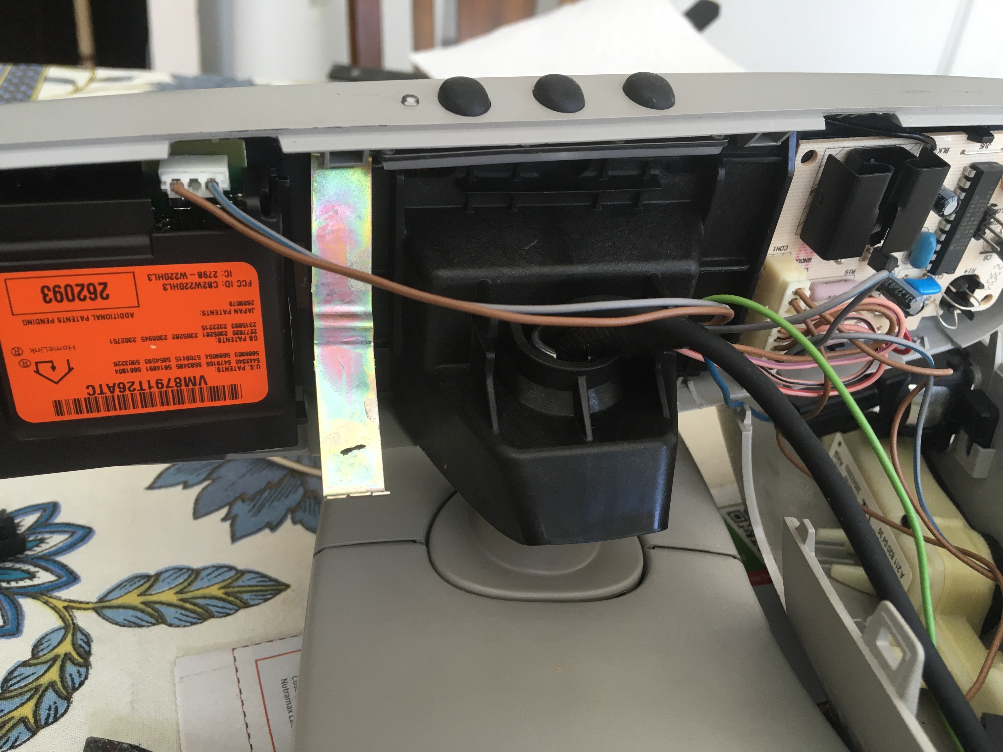

Anyway, I then ran that wire from the outside into the housing and twisted the two ends together so that the spring bracket could sneak in snugly but firmly:
The bottom clips (at the top of the image) weren't broken, and hopefully won't break. Time will tell, if they do break I can repeat the process for the other side.

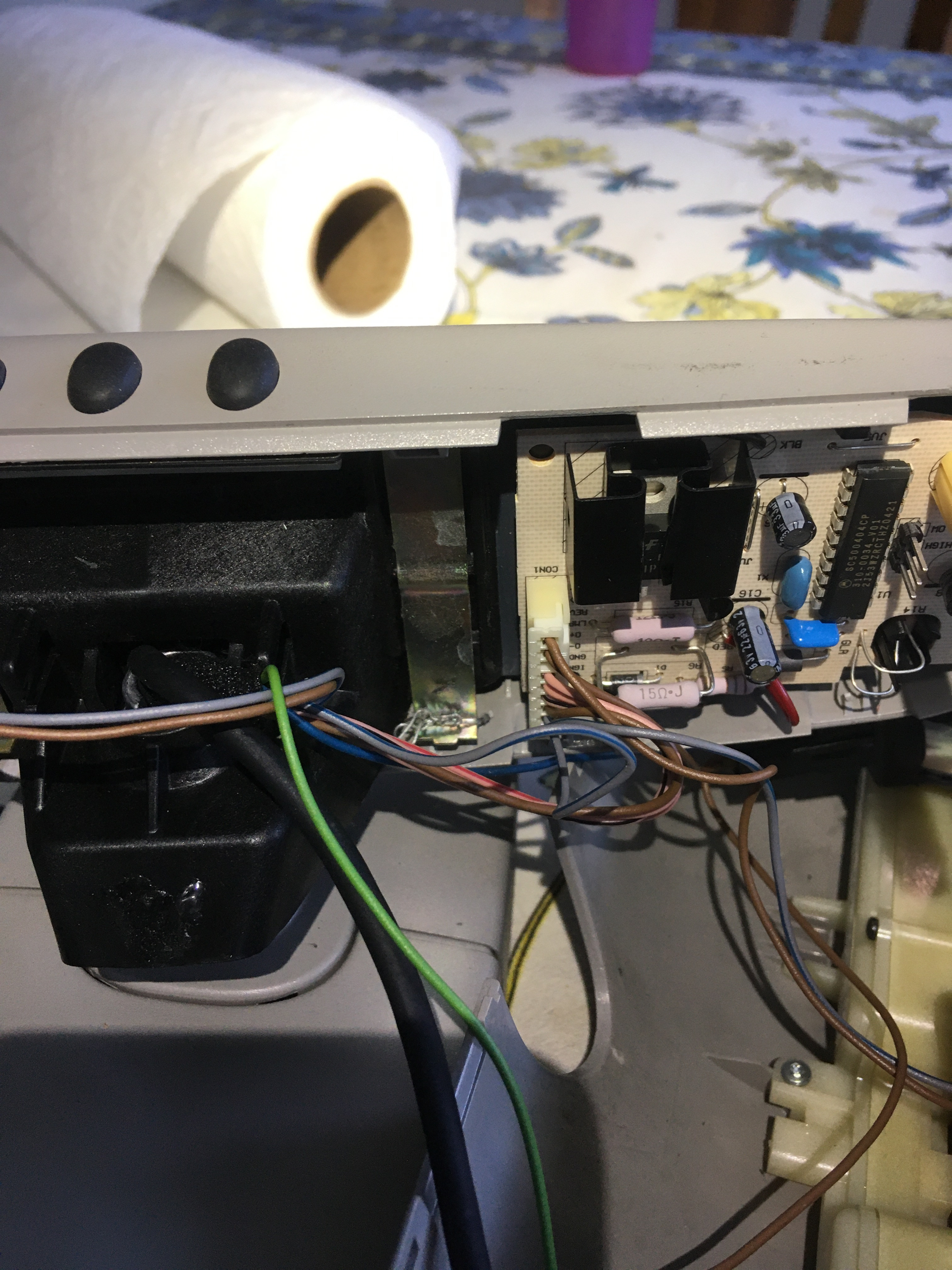

You also have to disconnect a bunch of wires which are underneath the overhead panel. To disconnect that, first remove the plastic lens coverings for the light bulbs, then use a flathead to unpin the 4 tabs.
Procedure here: https://w220.wiki/Overhead_Control_P...P.29_.28N70.29
