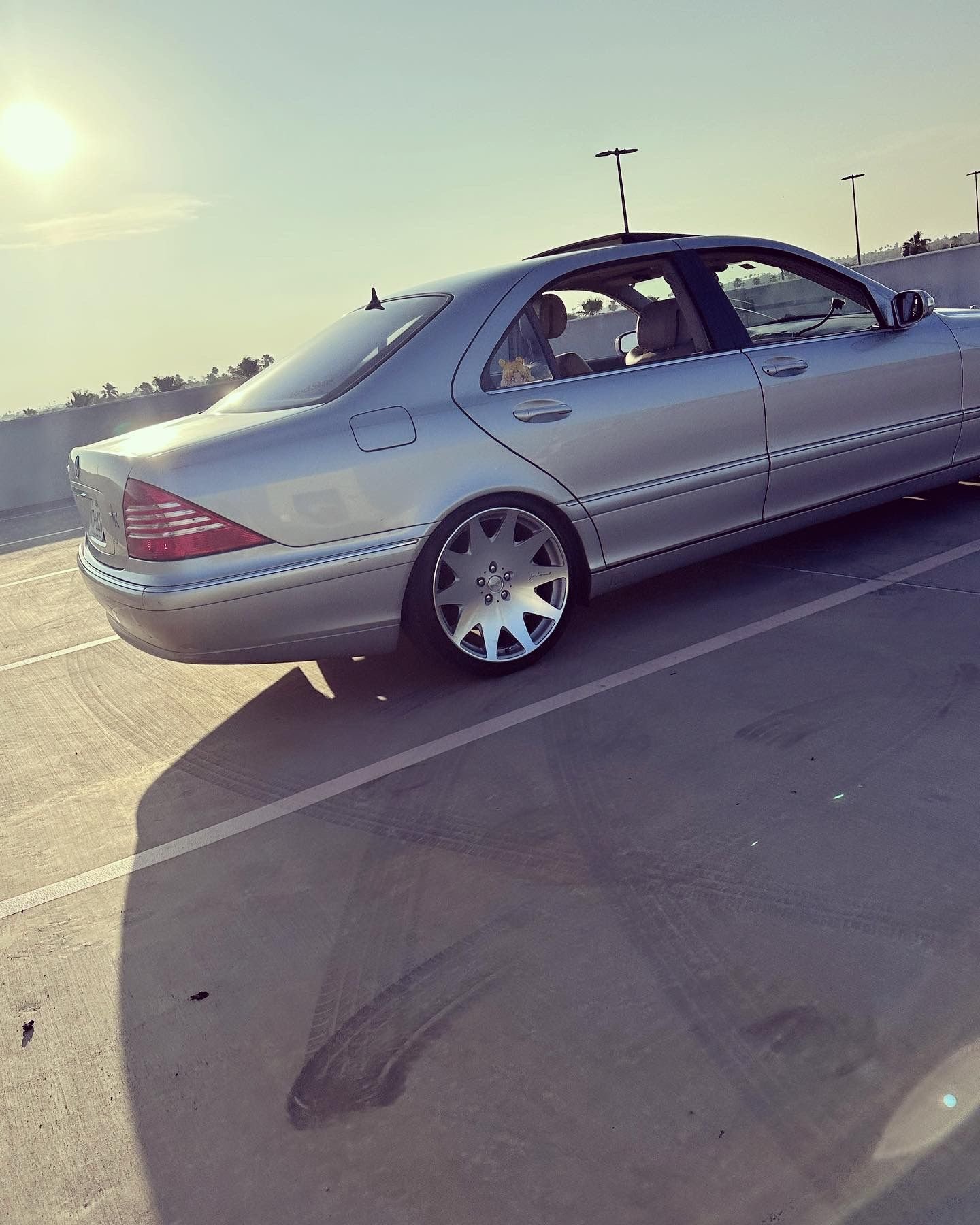

Attached are some pics of my ride. Been planning on wrapping her glossy black because the paint is fading. I'm also planning on upgrading the media components, I already bought an aftermarket bluetooth head unit, and I'm going to get a sub and amp. Also going to do a muffler delete and maybe cut the secondary cats so I can xpipe/dual tip the exhaust system. Also, I know the wheels are a bit crazy, I like it like that lol

Love those rims those are the MRR rims. Most likely you have a small leak at your valve cover gaskets, a rear main seal and you’re seeing smoke from engine oil hitting the hot manifolds. It is very common for them to leak, and not cheap to fix.

I love these wheel too, they almost look OEM. Thanks for the advice, will check out the gaskets. Already ordered an OEM replacement that came in this morning. hopefully his new gasket does the trick.

diagnosing oil leaks from the top is kind of difficult, oil cooler, valve covers, cam sensors, you'd get a better angle from under the car with the shields removed. I love your W220, badass car
