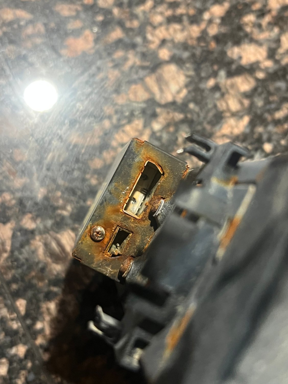

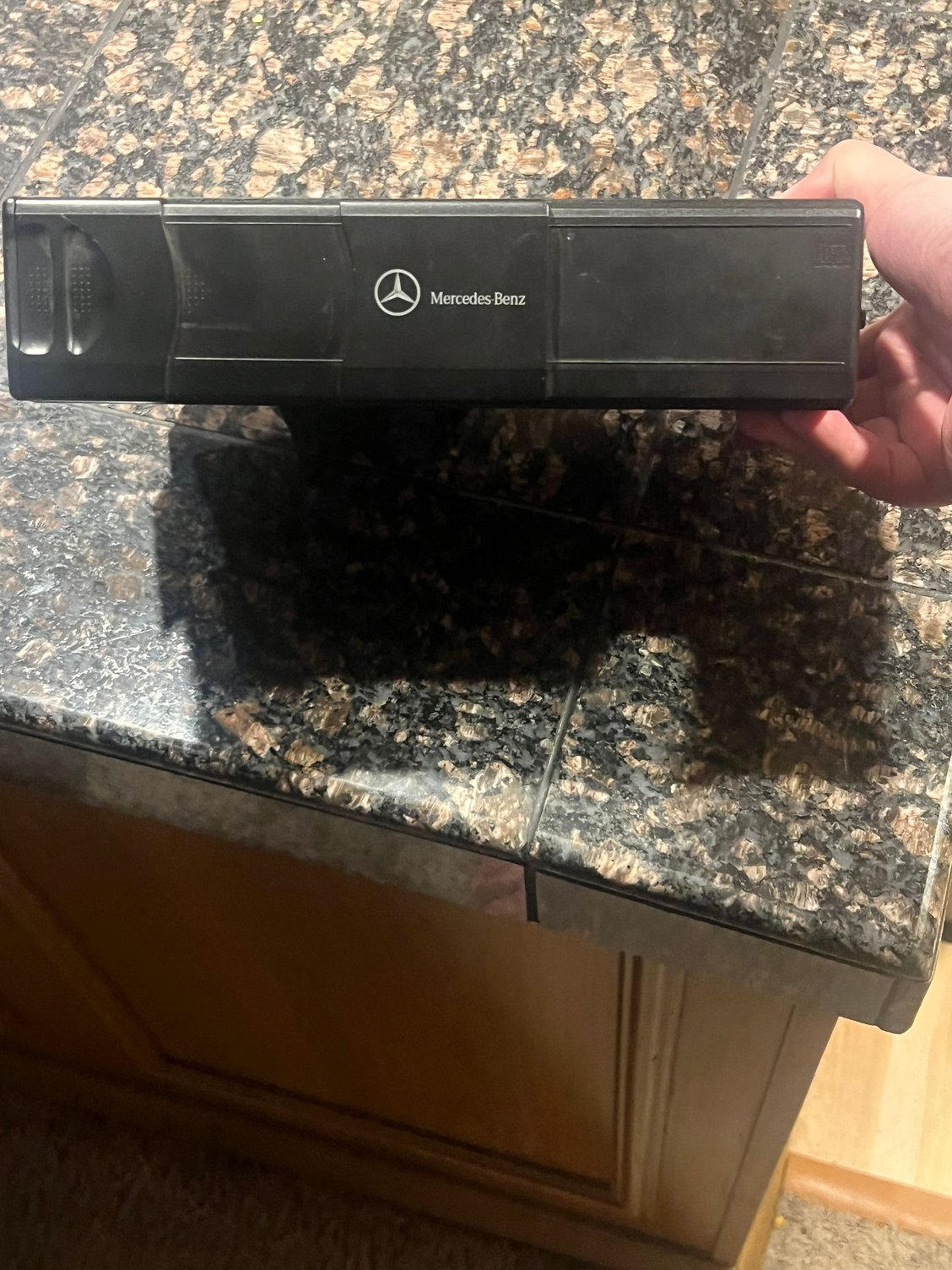

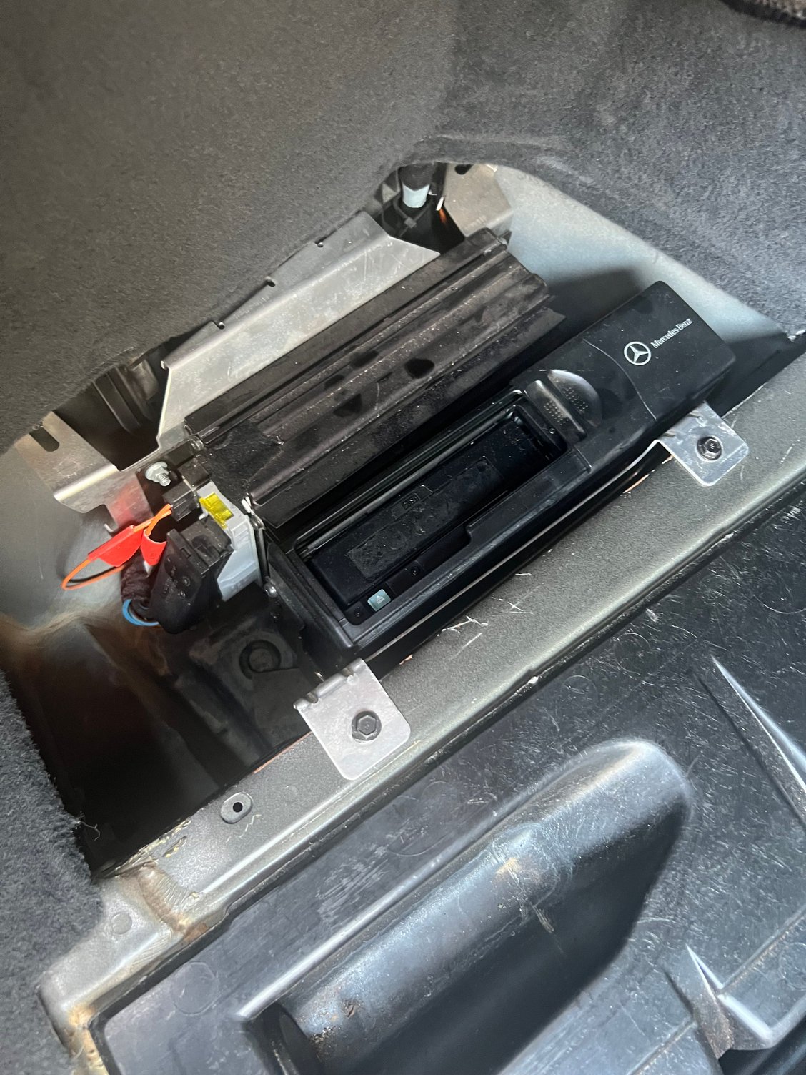

Hey guys so my audio went out a few weeks ago in my 2002 Mercedes s500 and I’ve been dying without music. So finally I went to the trunk tested the yellow 20 amp fuse and it’s all good. So I ended up taking out the amp and cd changer because that’s all my car has. I tested the amp by seeing if the red light blinked when I turned the car on and it did blink red so I know the amps good. But then I looked at the cd changer and holy shi* it’s rusted to a**hole. And also when I pulled the power cable out came two of the pins attached to the cd changer went with it. I’ll include a picture. So the main question I have is, can I have the radio working with just the amp by bypassing the cd changer somehow, and if not does anyone know the part number for the power connector for the cd changer I need? Thank you for any help!!!

I had to change my audio gateway it usually be all the way at the bottom and it gets submerged in water that leaks in the trunk. My cd changer doesn’t work either but my radio and satellite radio worked since changing the audio gateway. Is there any water buildup after a heavy rain in the compartment?
