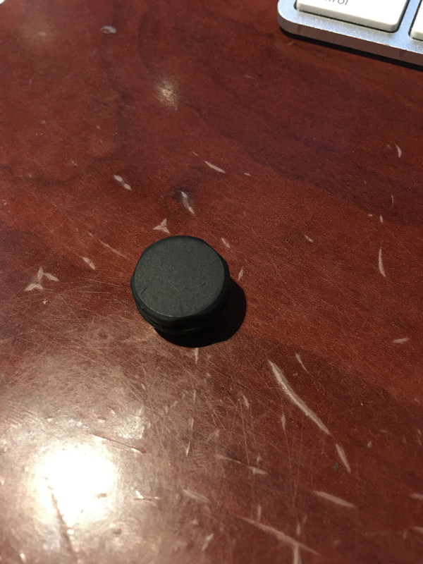

Found in the front left of the engine bay, W215 CL-Class, M275 V12 engine.
It looks like some sort of vent device or one-way valve?

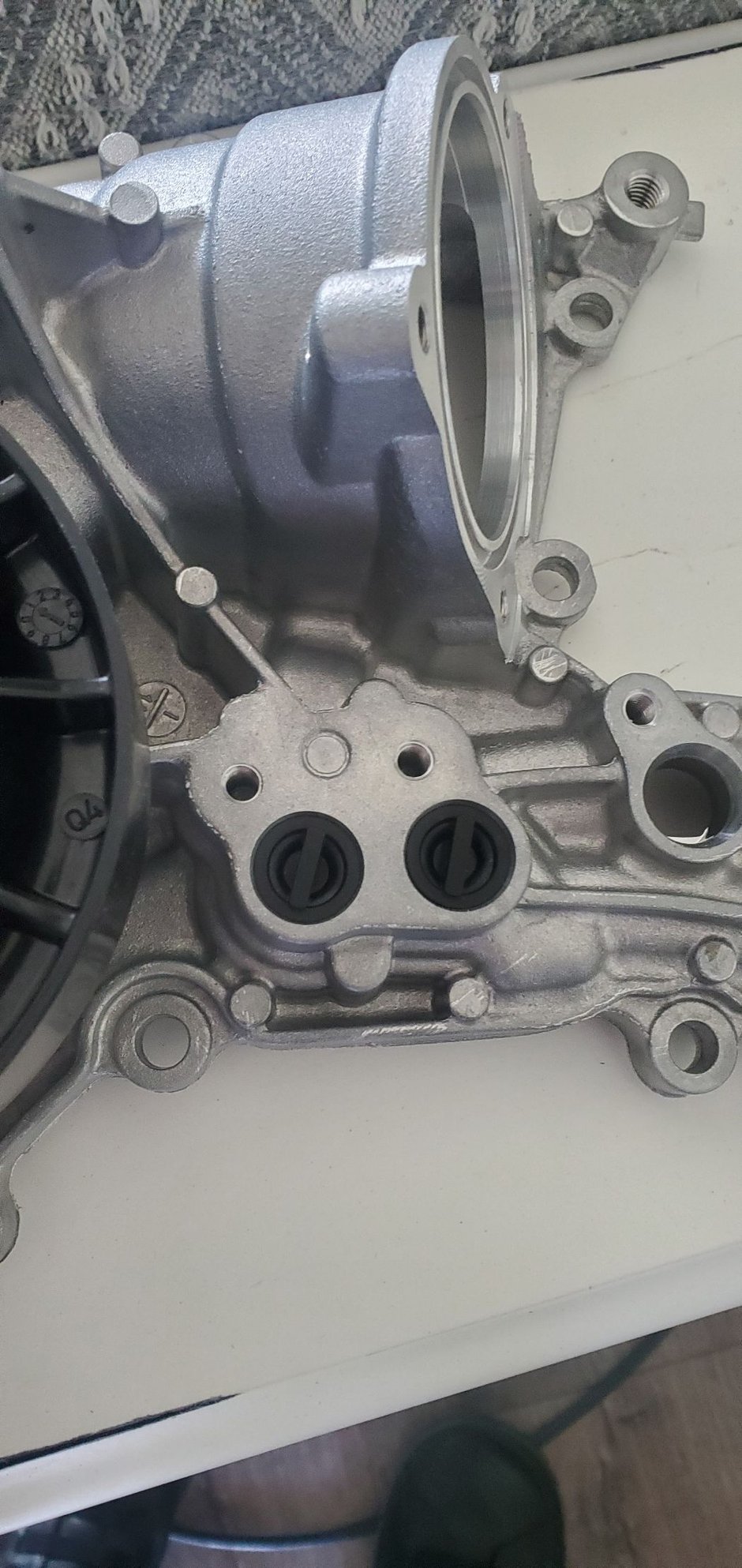

That looks very much like the two plugs I just got for my water pump.

It is definitely some sort of one-way valve that relieves positive pressure

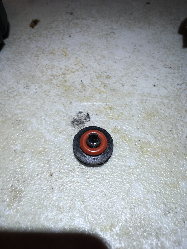

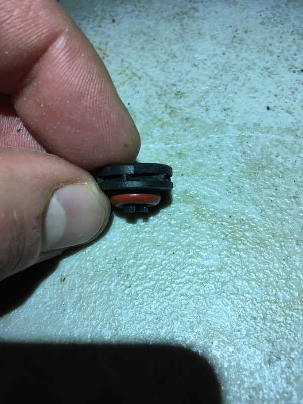

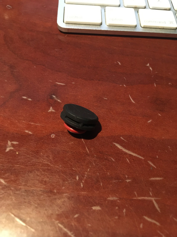

More pictures:
It looks like the plastic clips holding it in the middle broke off causing it to pop out.
Maybe a part from the radiator? An air valve? I just pressure tested and vacuum tested the cooling system and found no issue.

Yours looks a ton like this one....
https://www.fcpeuro.com/products/mer...lug-0009985590
Mine are -

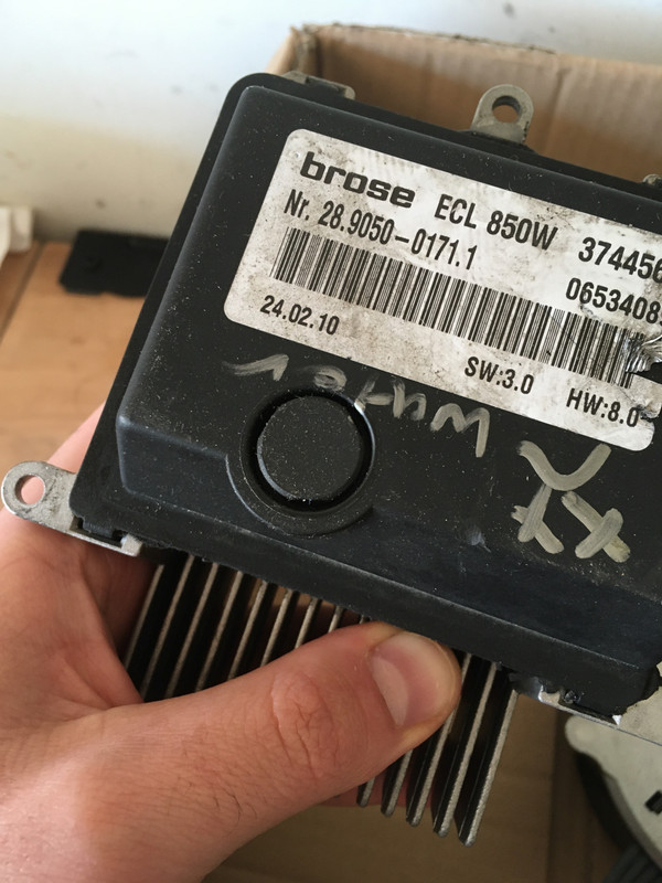

I think it might be off the cooling fan for the radiator. It is a vent for the ECU that drives the fan, mounted on the fan pack.

Boom, this might be it! Wow good job. Location tracks as well. I'll see if I can find it.

And here it is (from a parts fan I have):
Well. ****ing. Done. AdamGdefender! You get a Cookie!
