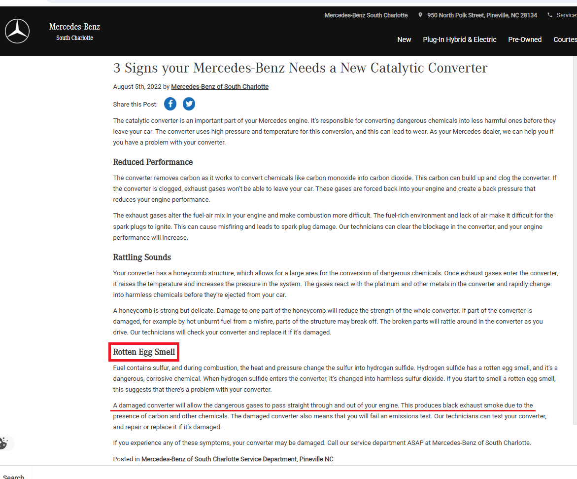

I was thinking about the issue of the cat being blocked causing it to glow red. Then from searching around its said that there may be a sulfur rotten egg smell if it were blocked. May also see abnormal looking smoke coming out the exhaust.
I highlighted the part where MB says if the car detects a misfire it shuts down the cylinder. This action should prevent fuel dumping into the cat causing it to over heat. But then again there could be an issue with the injectors themselves.
