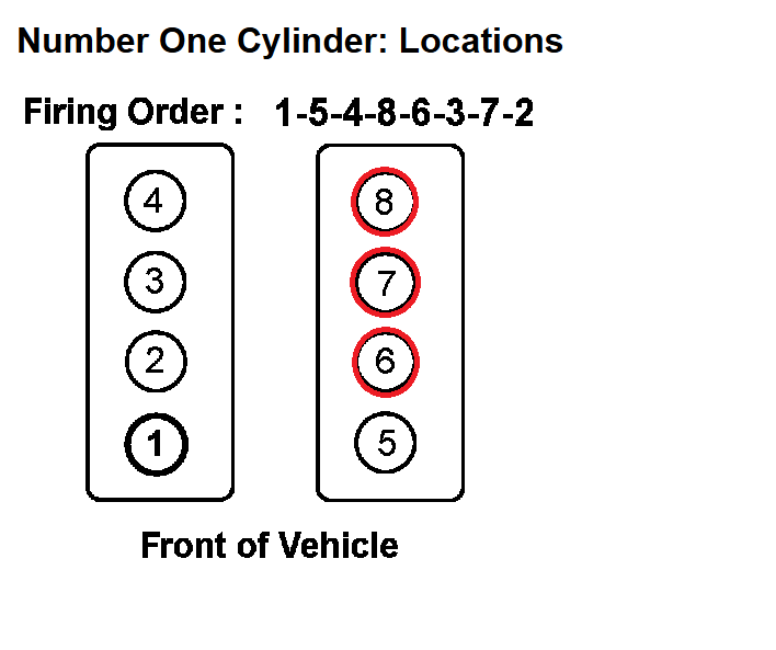

Following the installation of a brand new battery / OBD Scanned to find 3 dead coil packs on the same bank cylinders 6, 7, & 8 all dead or misfiring / while examining this in the night I noticed Catalytic Converter glowing red hot - so I unplugged the injectors to these dead coil packs - Now I am parking the car until I can perform the necessary repairs - Problem is that I am not in a city that I a from nor am I able to afford to live in a hotel indefinitely while I examine and fix these issues concurrently. While I am ordering the plugs and packs - I have to wonder what more I should be doing to examine the ground wire and or wiring that may have lead to all 3 packs on the same bank failing simultaneously.
The car was only driven a few miles before I parked it to find the dead coil packs lead to raw fuel dumping into catalytic converter which prompted me to unplug the electric lines to the injectors 6, 7, & 8. Now I am in a situation. And Time is not Friendly for me to be parked for such a length of time. First I need to diagnose my catalytic converter without any special tools to do so. Then I need to diagnose the reason why these 3 coil packs next to each other all died simultaneously.

Cylinders 6,7 and 8 are the back three cylinders on the drivers side. The "O2 sensor position 2" appears to be the drivers side down stream O2 sensor, which is the side where the catalytic converter was glowing.

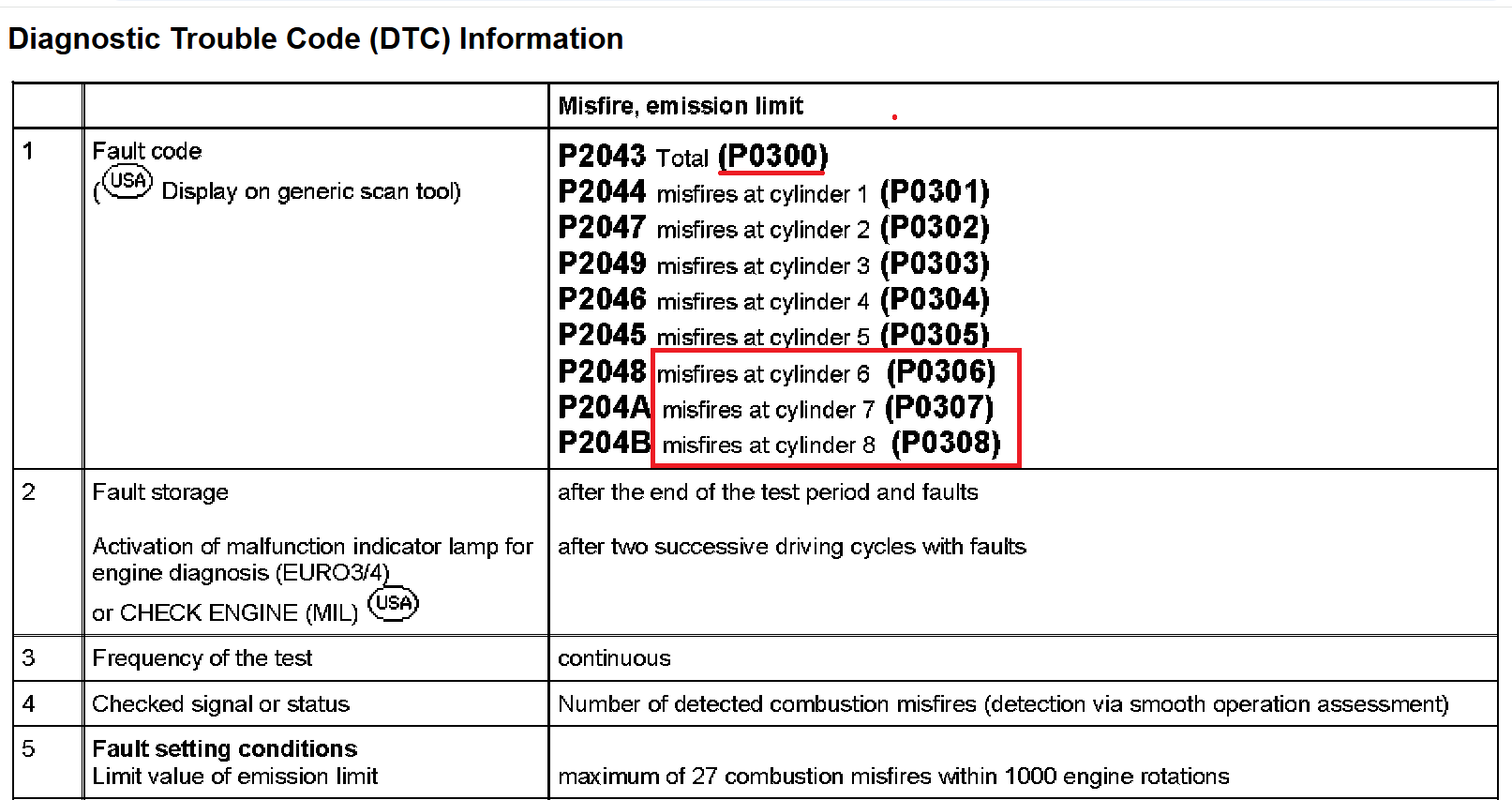

Fault Codes from Scan were as Follows:
PO300
PO306
PO307
PO308

To look up the meaning of fault codes look thru the very top selection ALL Diagnostic Trouble Codes (DTC).
The P0300 just means misfires detected. The P0306, P0307 and P0308 point to which cylinder. This is where an OBD scan tool comes in handy to be able to see live data.
