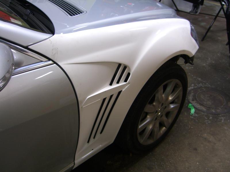

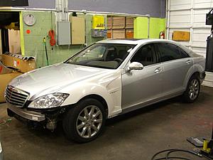

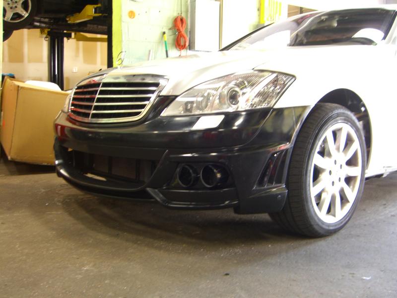

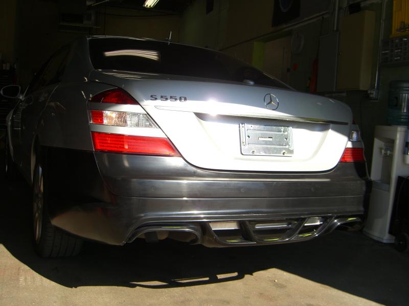

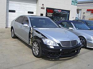

car being tore down... test fitting panels... fenders first....

How bout some '10 headlights
Old Mar 11, 2009 | 03:56 PM
s600ed's Avatar
Joined: Sep 2008
Posts: 299
2007 s600 2007 cls63
What are the pieces made of? Fiberglass of PolyU?

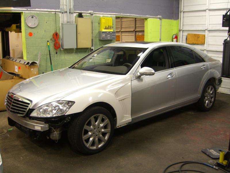

A little more done today...

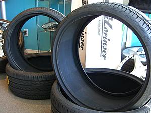

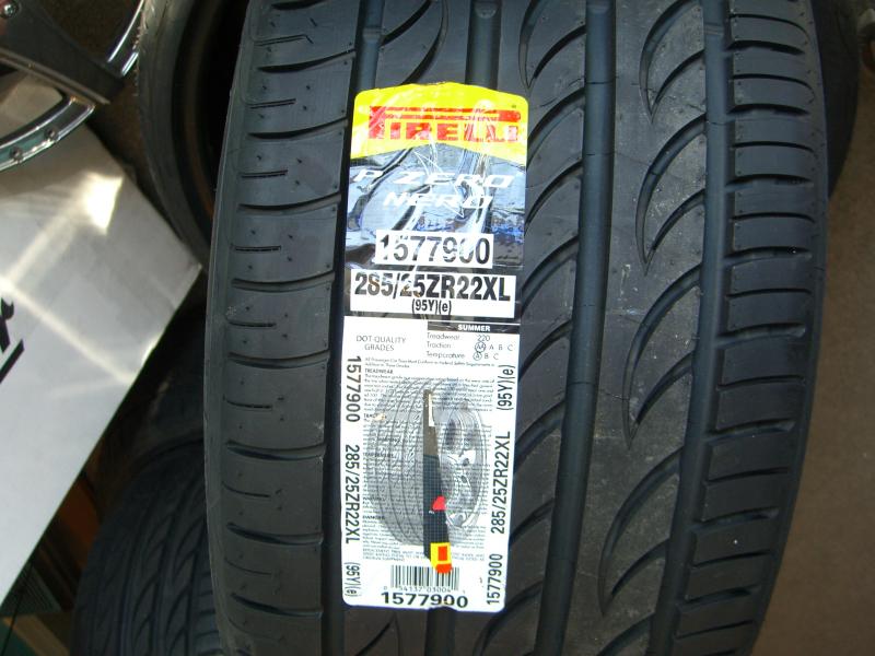

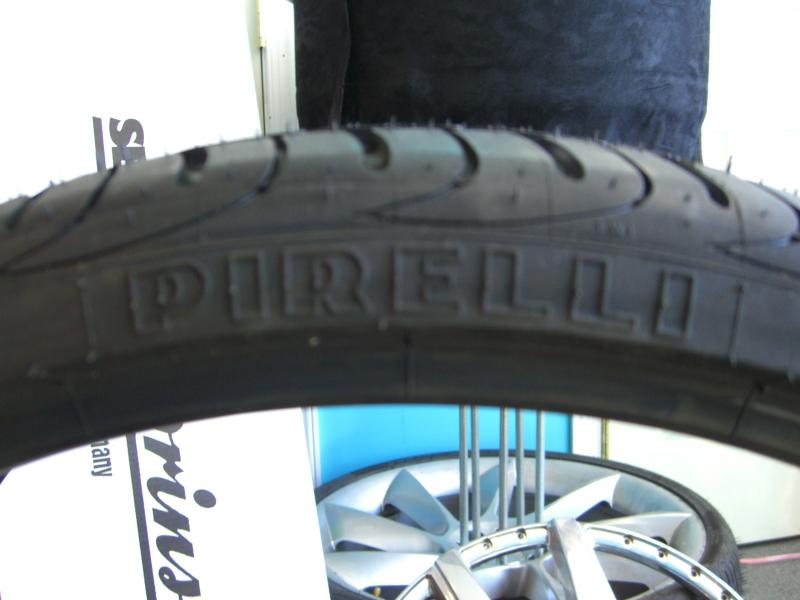

Tires Arrived....

The Car was silver in the first post, now its white?
lol... its the camera ..... its silver..

What's the advantage of running 285 in the back instead of 295? Is there less of a rubbing issue?
yes.. i usually like to go as wide as we can.... but there are little tabs on the back bumper and the inner lip of the rear fender that rub, i do trim the tabs and the inner lip... But to be perfectly safe i like to go a size skinner.... if he puts 2 people in the back and stuff in the trunk its going to sit lower..... It also depends on the Offset of the wheel (how close it is to the fender)...
I have used the 295's... just depends on what wheel im using and what brand tire... all 295's are not the same all the time.... and a few millimeters can make a huge difference...

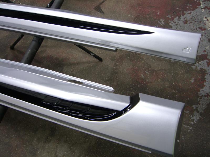

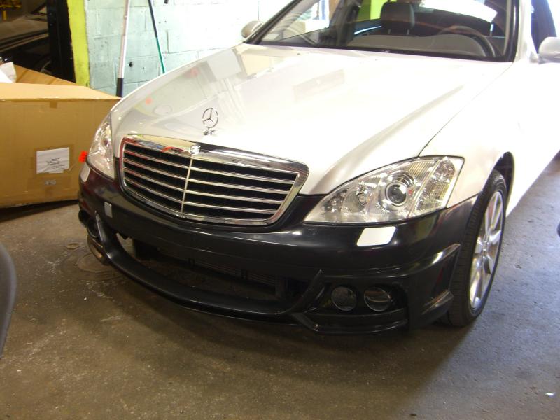

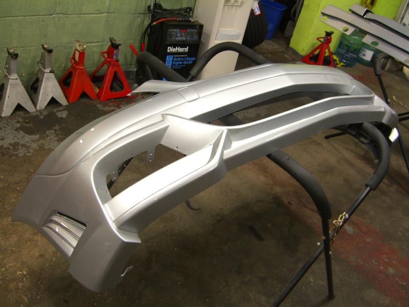

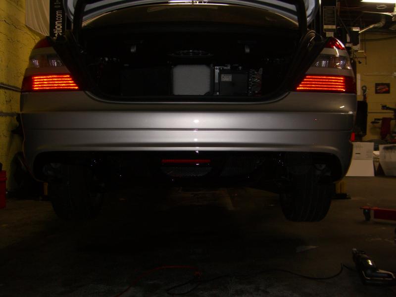

pictures of painted side skirts, front bumper and a dark picture of the rear bumper..
Tomorrows another day.....
