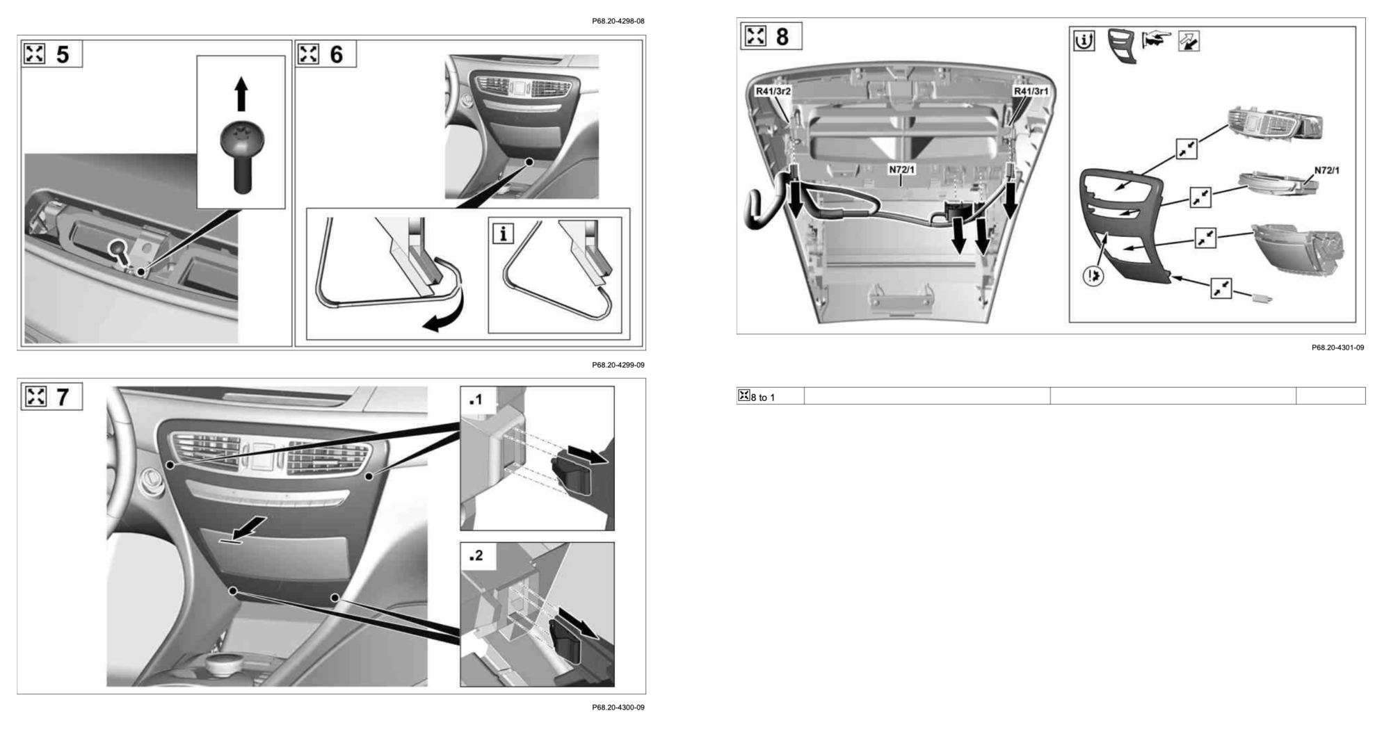

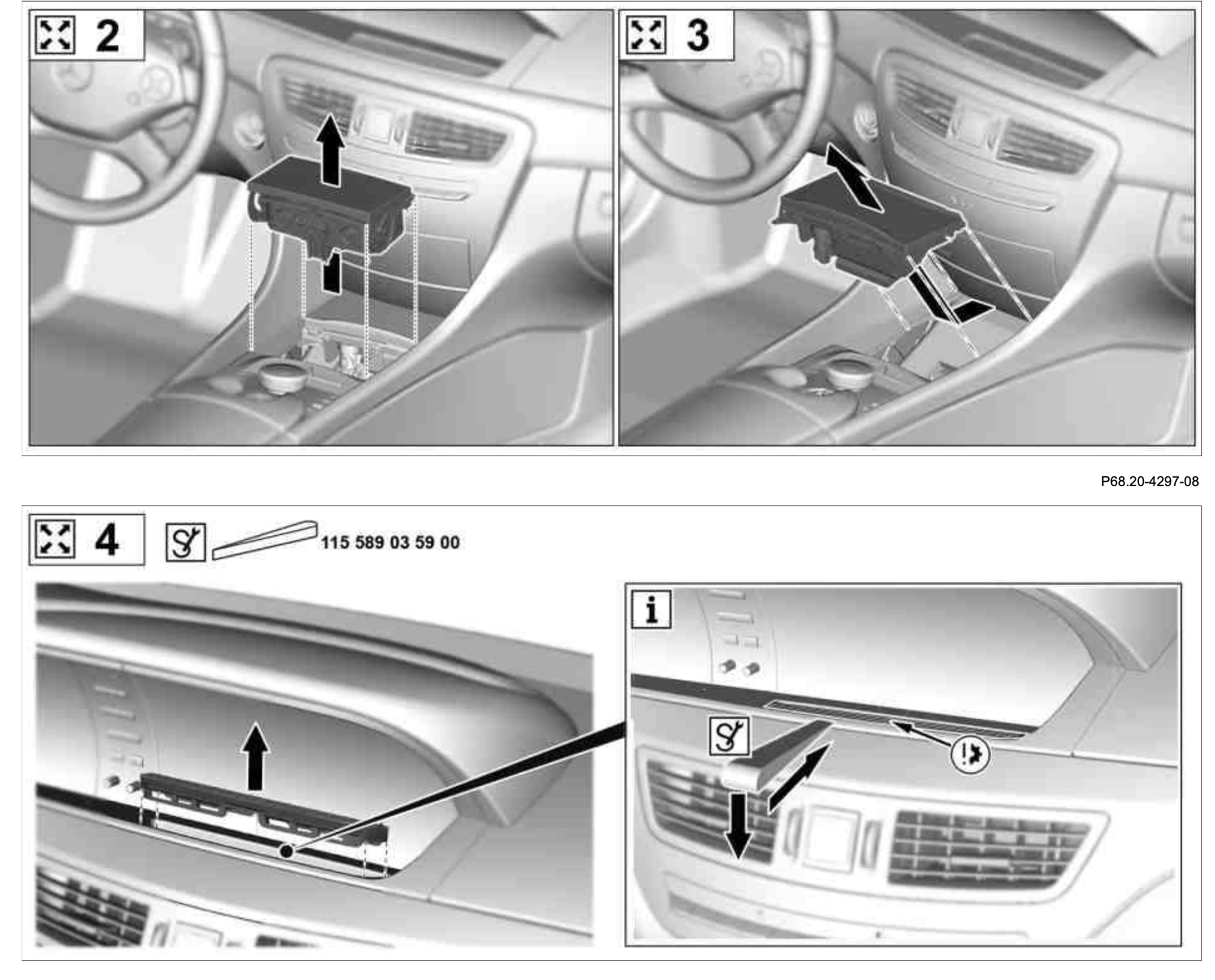

Old Oct 18, 2019 | 11:50 AM
  #139
HerAMG's Avatar
Joined: Oct 2019
Posts: 9
CL63 AMG
Hi All,
Guys, I have one related question regarding the installation. I drive 2007 CL63 AMG. I've watched a video showcasing COMAND system removal, however, it seems that it is based on S-class and on CL it looks a bit different. I've consulted my WIS system and found this kind of procedure:
So, basically it means the removal of the WHOLE front cover, instead of just one panel in case of S-class. Is this a correct procedure to follow on CL?
Thanks a lot.
Old Oct 18, 2019 | 12:08 PM
  #140
megacrazy's Avatar
Joined: Oct 2012
Posts: 1,401
Likes: 312
CLK55 W209, CL63 W216
The entire piece needs to come out on the CL. A bit of a pain to take out but not too terrible.
Old Oct 19, 2019 | 08:24 AM
  #141
HerAMG's Avatar
Joined: Oct 2019
Posts: 9
CL63 AMG
Oh, thanks a lot for the swift reply. The guide will be much better if they've added a bit of text description as well. Three more questions (bare with me, please):
1) Step number 2. I could only take the internal part of the cup holders out, not the whole unit. Should I apply more force?
2) Step number 4. I just take the plastic panel remover and take this vent off? It is not being hold by something like a screw?
3) Step 8. Don't really understand what is going on here. What are these wires in the center of console?
Thanks a lot.
