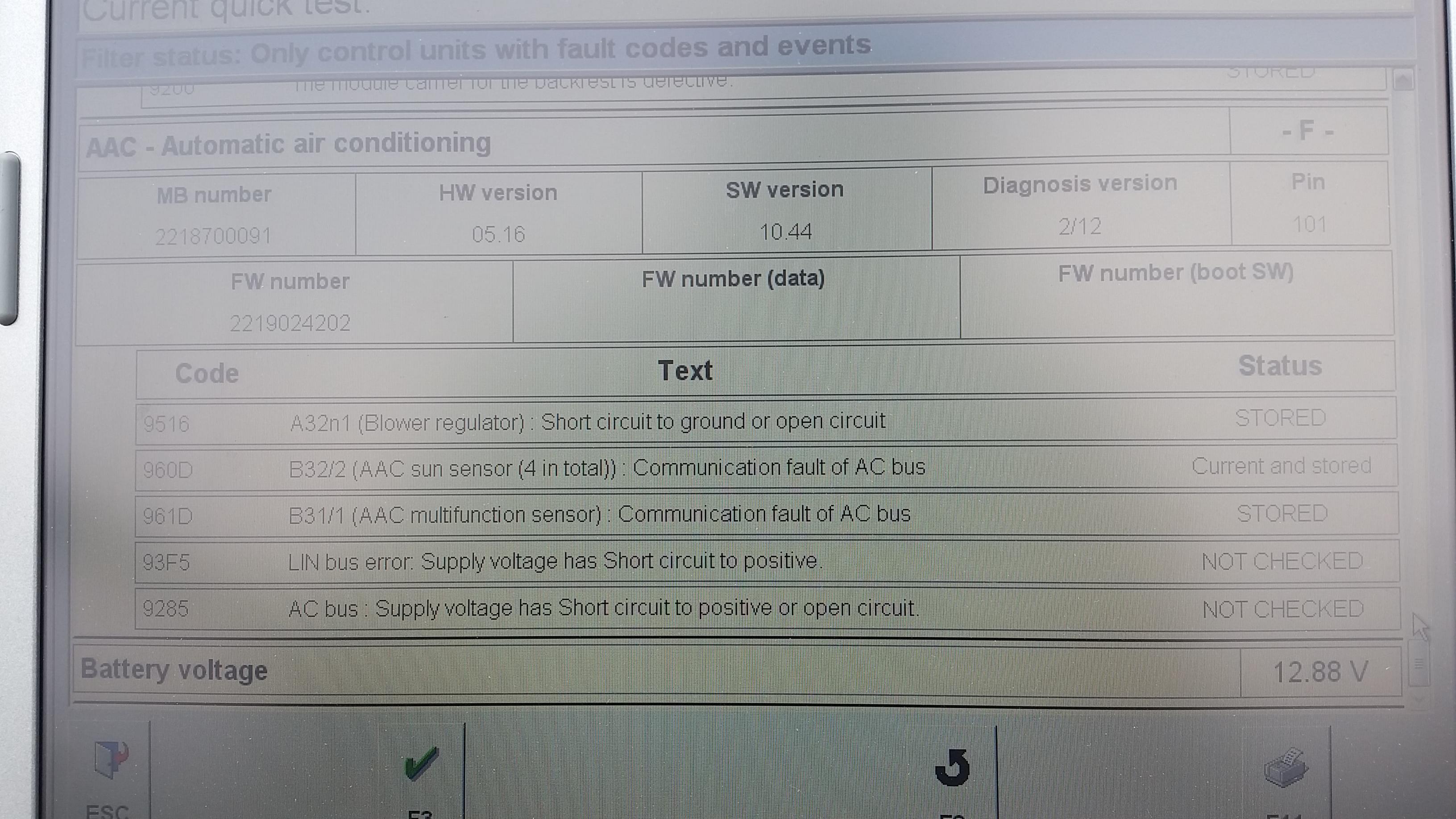

Ran the car on STAR this morning.. This is what I got.

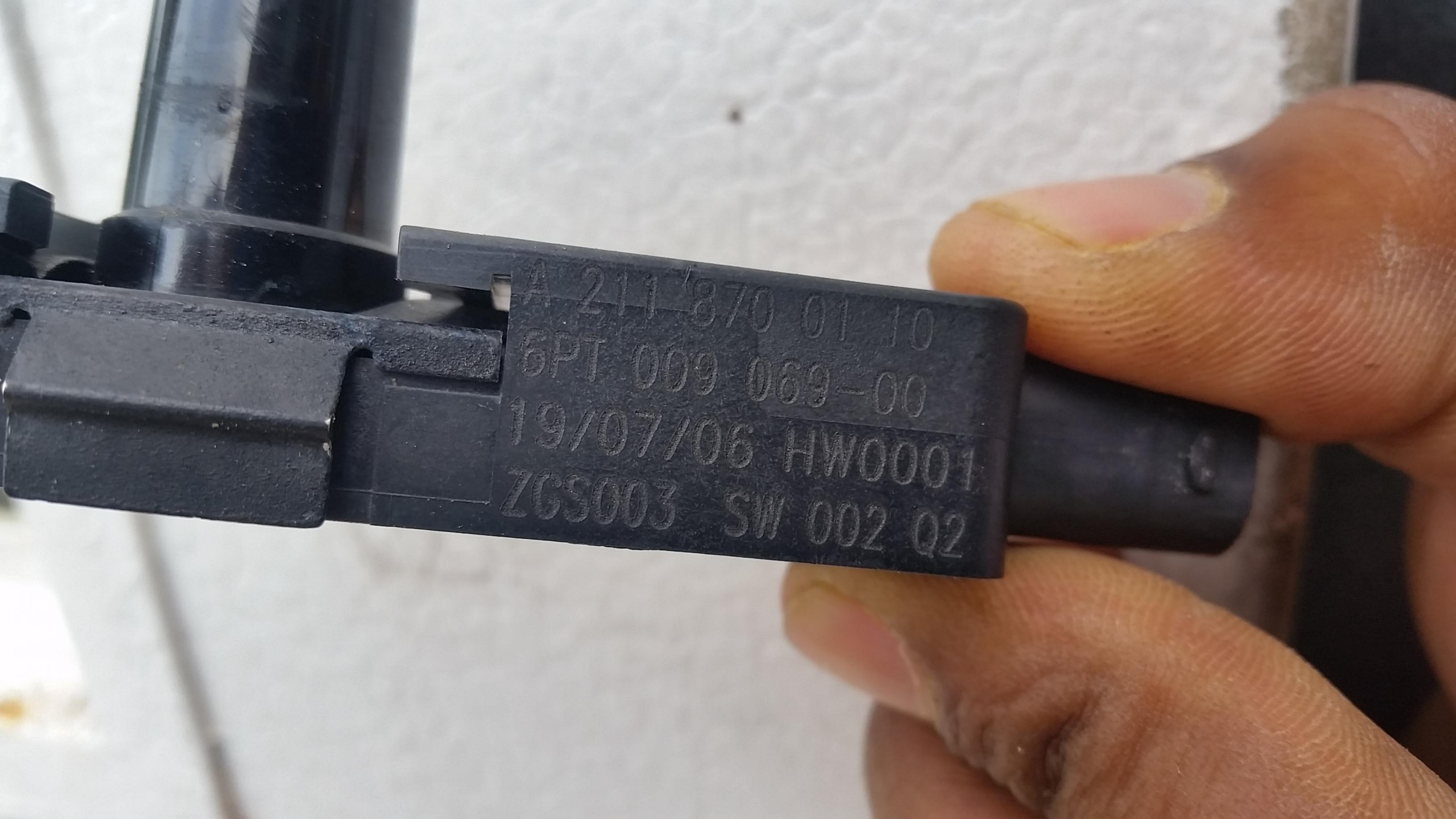

I pulled the sensor and it had cracked and was filled with water. I emptied it, but I think the sensor is fried, because even after getting the water out it still doesnt work correctly. Let me get the sensor (pictured) ordered and in, then we can check it out.
Do you know if there are any resets for climate control units like on the W220?
Attached Thumbnails Rear AC tempermental??-2014-09-17-09.05.43.jpg   Rear AC tempermental??-2014-09-17-09.35.34.jpg   Rear AC tempermental??-2014-09-17-09.35.38.jpg

Put the new sensor in, and cleared the codes via STAR.
Still working intermittently... Any suggestions?
Currently STAR is not throwing ANY codes
