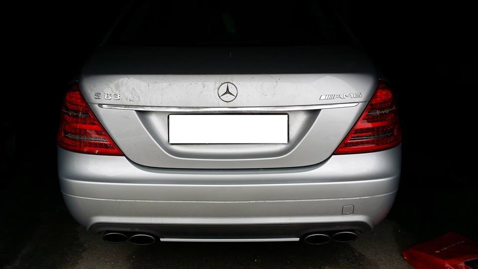

THIS IS ME!!
WHAT I WANT - The rear look! (not the pipes, they are conneted)
WHAT I WANT - The TIPS!!
I think the pics speak a thousand words. I ready to do this.

The S63 have the separated 4 pipes. And the S65 have the conected pipes.
