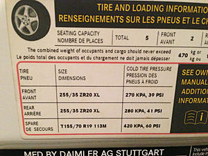

Does anyone know what the sticker on the door says for the 19" wheels on their s550?
Reason why is my car shows the info for 20". Original owner had 20" and didn't like the ride and had 19's put in soon after he got car. I'd like to know correct pressures for 19" AMG. As you can see here, mine only shows info for 20" on my door.

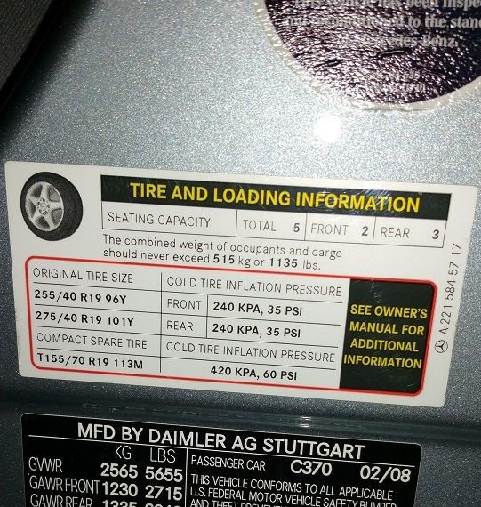

Mar 29, 2015 | 08:58 PM
Think its 34 ill snap I pic for u tmrw

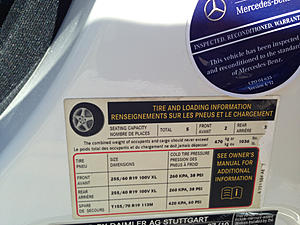

Mar 29, 2015 | 10:39 PM
Here:
https://mbworld.org/forums/s-class-w...ld-34-psi.html
My car came with the 19" AMG setup and that exact sticker. My dealer sets it at 38 too. I presume 34 will give a more compliant ride while 38 will give more rim protection. If most of your driving is highway, 38 will yield lower tire temperatures.

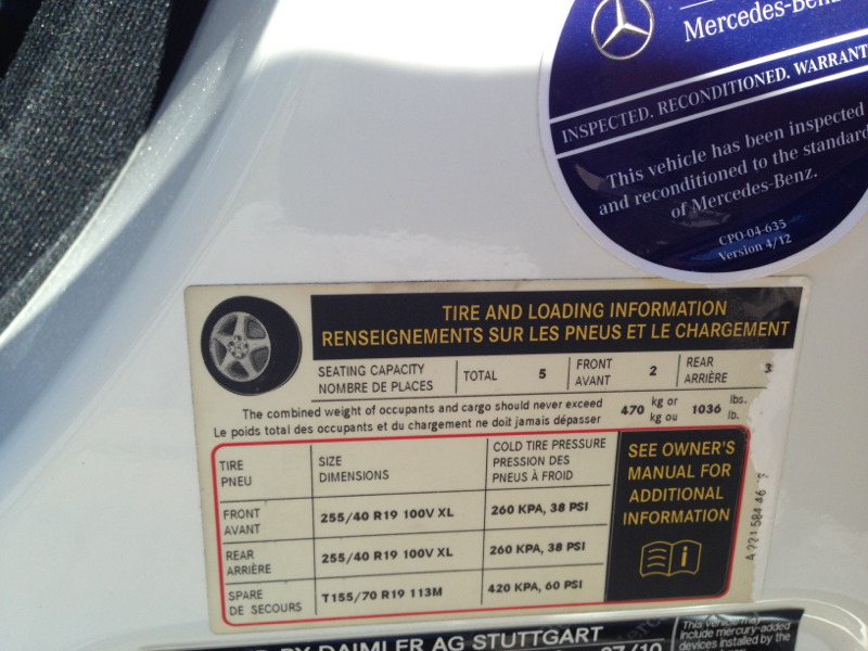

Apr 1, 2015 | 04:03 PM
1bad540 just sent me his factory non staggered 19" specs from his door, which are the same wheels I'm running and it says this. Now I'm confused why Atcpup's staggered 19's show less psi.

Apr 1, 2015 | 05:18 PM
Jason...Look at max combined weight difference! Almost a 100lbs.
