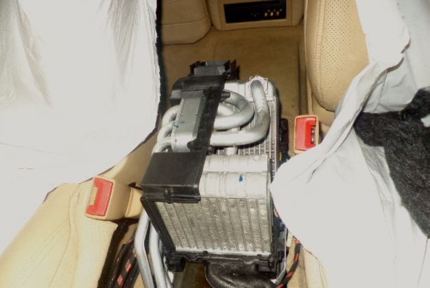

I suspect my rear A/C evaporator is clogged with bacterial/fungal/mold growth. I get bad smell from the rear vents. Dealer cleaned it once but the smell returned after a couple of months. Looking to replace it. What is the part number?
Here is the opened up rear A/C if anyone interested. The front core is evaporator and rear is heater core.

Holy crap! No wonder that option is like $5k. Cool photo!

Evaporator 2218300258
Heat exchanger 2218300261

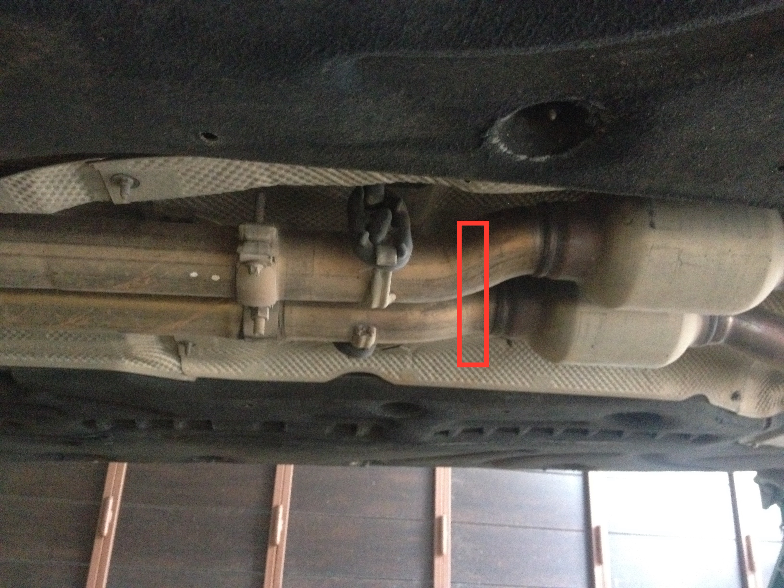

Jacked up the car to find the rear A/C drain. Could not see anything that looked like a drain hole. Squirted some water on the cooling coil and then found the tiny gap in the underbody shield though which water was dripping out. So the drain is working fine, but I was hoping to find a drain hole through which I could pump A/C cleaner foam. Also found out there is a nice jacking point between the front wheels.
rear A/C evaporator coil price and part no?-img_2223.jpg
rear A/C evaporator coil price and part no?-img_2220.jpg
