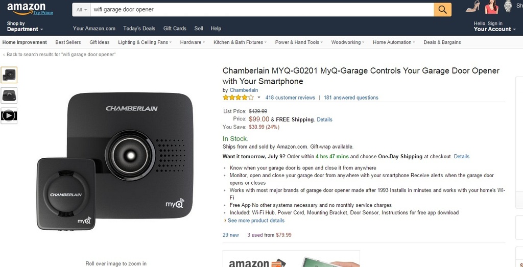

Thinking about getting this wifi garage door opener so I can open my garage door with my phone from anywhere. And to solve the issue with my garage door opener only working 5 ft from the garage door.
Anyone using a wifi garage door opener?

I have that unit. Took about 15 minutes to install and another 15 to set up the account. I have a remote starter with a cell phone app so I needed to be able to open the garage by remote smartphone app when I start the car to pre-warm it in the winter.

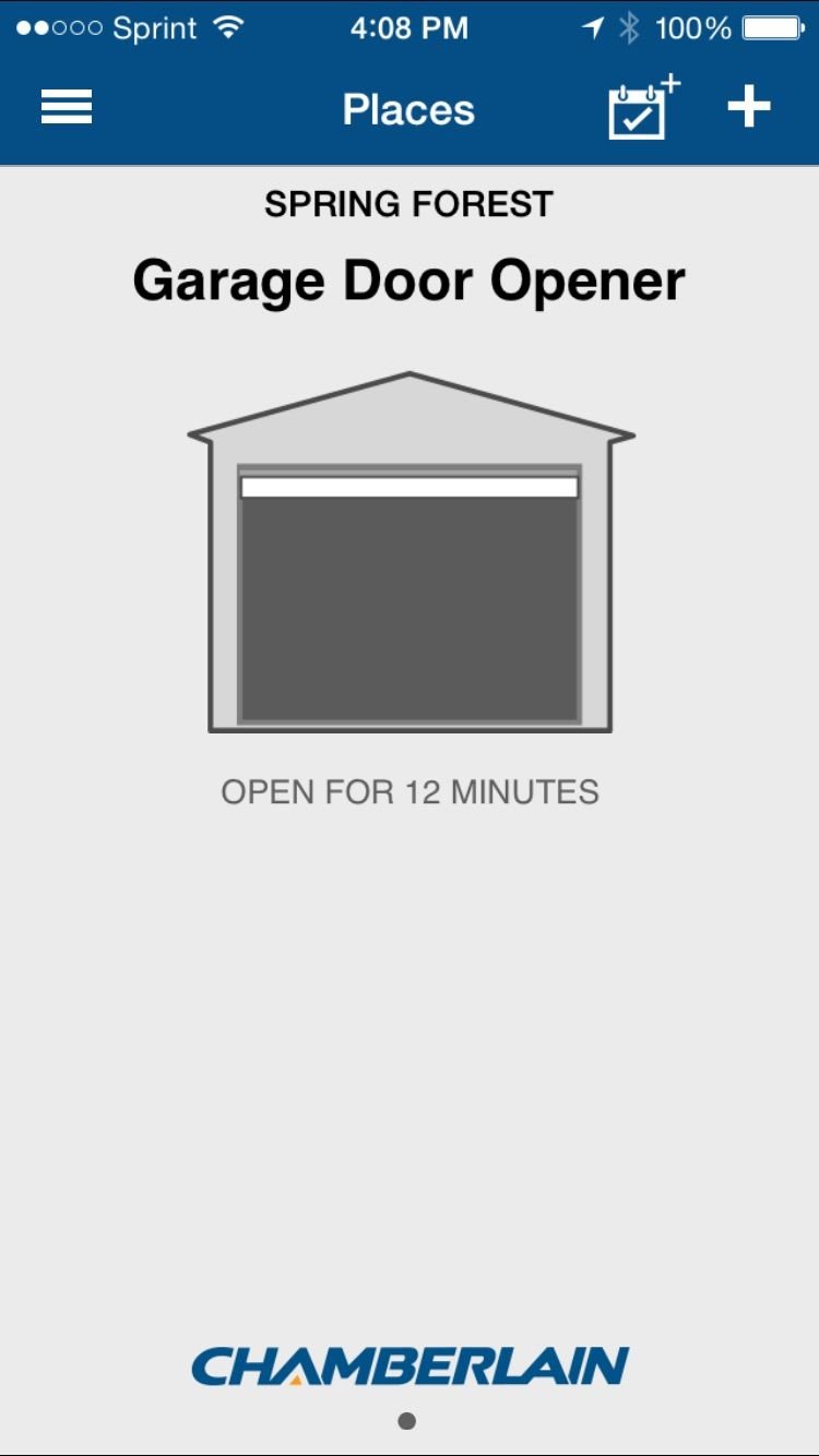

Old Jul 8, 2015 | 08:00 PM

You actually set it up from your smartphone via a Bluetooth connection and it then sets itself up on your wifi. The transmitter installs on the ceiling near your opener (larger of the two units) and has to be within the homes wifi range. The smaller unit is a position sensor you Velcro to the top panel of the garage door. Lastly you have to do a "learn" sequence on your actual opener so it accepts the new device as you would anytime you add or replace a clicker or add a Homelink device.
