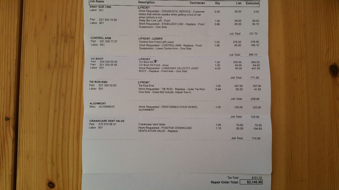

Thanks for the responses guys. I just went to a friends shop and he came up with this estimate. Tell me if this sounds right or off in terms of pricing...
