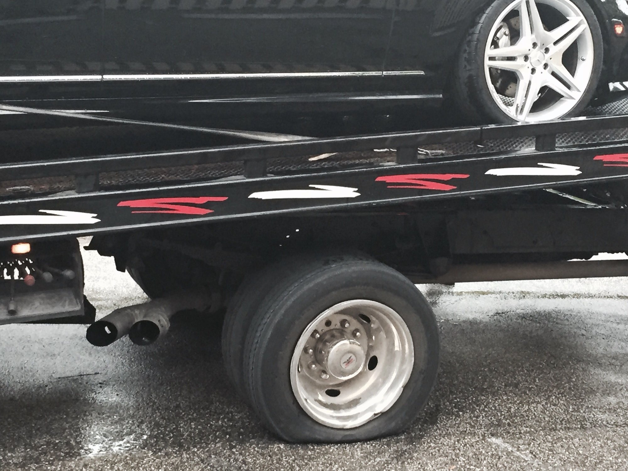

So this is how my whole Saturday went

Why is your car on a flatbed? It looks like the flatbed might need a flatbed too.

No start. Plenty of juice, but no start. Having it towed to MB. First the guy comes out, starts pulling it onto the flatbed and realizes the bumpers won't clear. He leaves for a half hour to get a set of ramps and comes back in the middle of a torrential thunderstorm. Finally gets it on the truck and sees the flat. We ended up going anyway but the whole thing took four hours.
