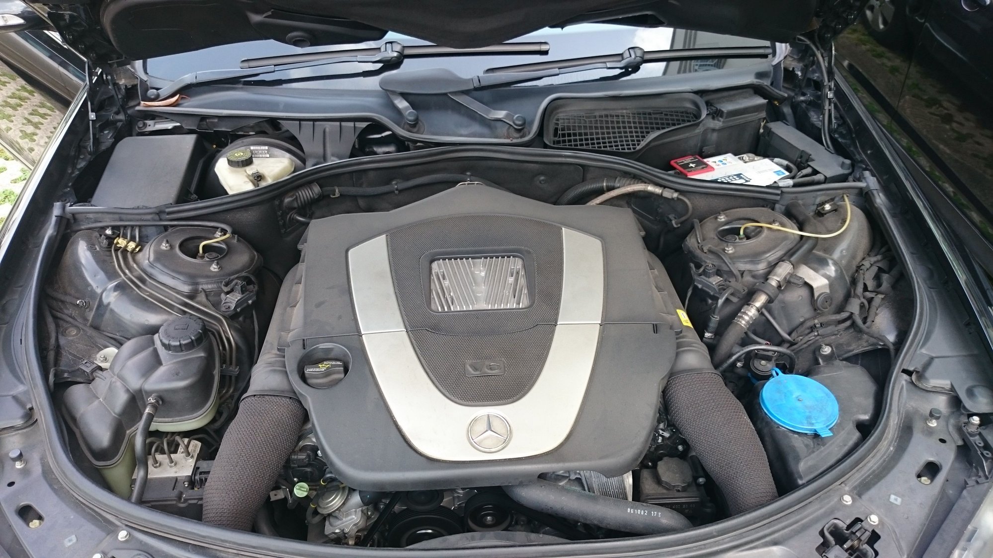

Old Jul 19, 2015 | 01:53 AM
waltergoh's Avatar
Joined: Nov 2013
Posts: 13
E class
My engine bay
Do I have ABS or normal airmatic
Old Jul 19, 2015 | 08:03 AM
Diesel Benz's Avatar
Joined: Dec 2006
Posts: 6,499
Likes: 335
From: Europe
No ABC fluid reservoir. You can see the Airmatic hose coming from the centre/top of the strut.
