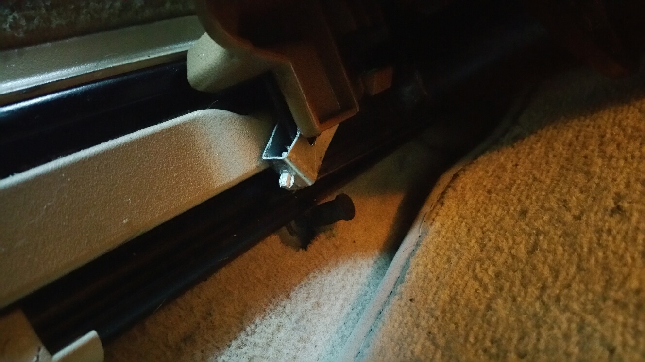

Guys, thanks for pointing me in the right direction. I looked underneath the seat and happened to notice the stainless steel clip just laying on the carpet. From the back seat, I connected it back despite the metal rivet/pin being broken and it worked like a charm.

Thanks for the pics above, they helped too.

The pictures are not too clear as to where the clip attaches under the seats. Can someone tell me exactly on under the seat?

The pictures are too clear as to wear the clip attaches under the seats.

For those with the same metal clip as the one pictured above, and wondering how to do it like I was:
1. Put the front seat all the way forward and upward.
2. From the rear floor, pull the metal clip attached to the cable towards you a couple inches past the plastic/composite nut thing that's connected to the seat rail to give you some slack.
3. Point the clip perpendicular to the side of the car, slip the clip onto the plastic/composite nut thing, then pivot the clip back 90 degrees so that the cable tightens slowly and makes it taut.
4. Enjoy your functioning seatbelt!
