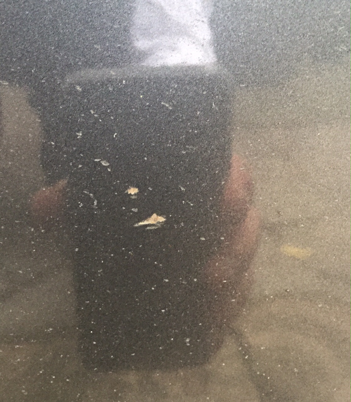

Hi guys,
I just noticed a scratch on the rear wheel arch and it seems like there is a small dot of rust. Is this possible? The car is a 2008 S500. I am attaching a photo below.

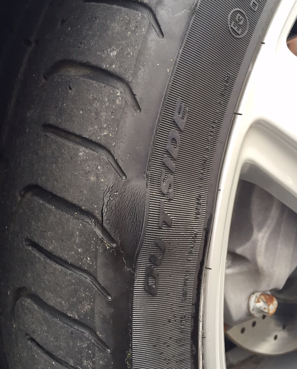

Also, I noticed a bump on my front tyre - do you guys think this is dangerous? Should I replace the tyre? Also attaching a photo.

yes to both.

thanks, I will change the tyre.
But how is it possible for a 2008 Mercedes to rust? I thought the rust issue was sorted by then?
Because there is a chip or scratch then went all the way through the paint & primer, that's how.
To repair, just clay bar the area, or use a good polish to rub the rust off. Then dab some touch-up paint into that spot and you'll be good to go. It shouldn't come back.
thanks!
I thought that a Mercedes from 2008 should not rust.. not very impressed..
All steel with the exception of stainless will rust if the integrity of the protective coating is compromised. Even galvanized iron will rust if the coating is scratched down to the bare metal.

The tire looks bad.
thanks!
Look at any car's brake rotor after a wash, exposed steel oxidizes in minutes.
Unfortunately, when it has been left for a while, the rust often extends farther under the paint than you think. You need to scrape the paint back with a sharp edge to expose clean metal, prime and paint the area.
Just dabbing touchup paint won't work -- you'll get a big bubble later on.
Many YouTube videos will show how it's done.
And also agree that that tire is shot -- looks like pothole damage.
Be sure the wheel is round before you put a new tire on it.
Good Luck!
