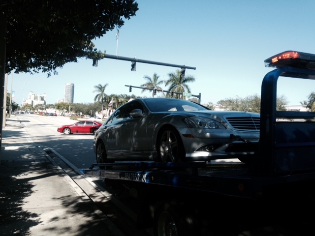

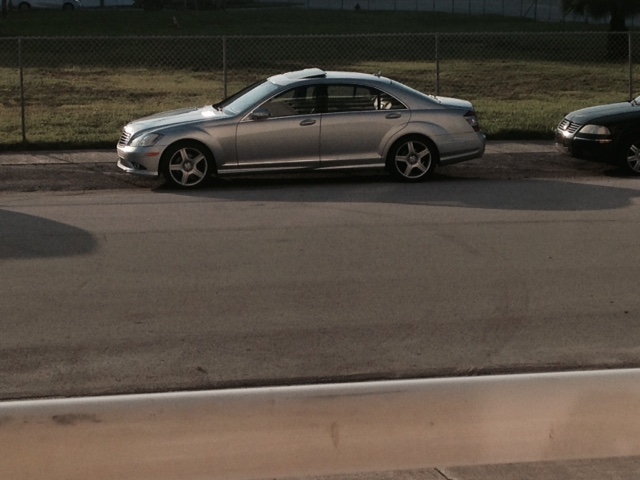

I just bought a 2007 s550 on Ebay for a very good price, over 200k.
It does have all records from day 1 and is truly immaculate.
I picked it up in Atlanta and drove it back to Miami without a hitch.
So after driving around for a few days I stopped and filled it with 93 at Shell and as I was pulling out, it stalled and wont start.
I towed it home and I found good pressure at the shrader valve and when I spray some gas into the throttle body it will start then stop.
I suspect the injectors are not opening.
The car shows no codes or dummy lights.
Come to think of it, it did have an odd bump when idling like it was going to stall that was apparent while in gear, but no codes for coil etc?
Has anyone encountered a similar thing, any advice?
Thanks for the help!
