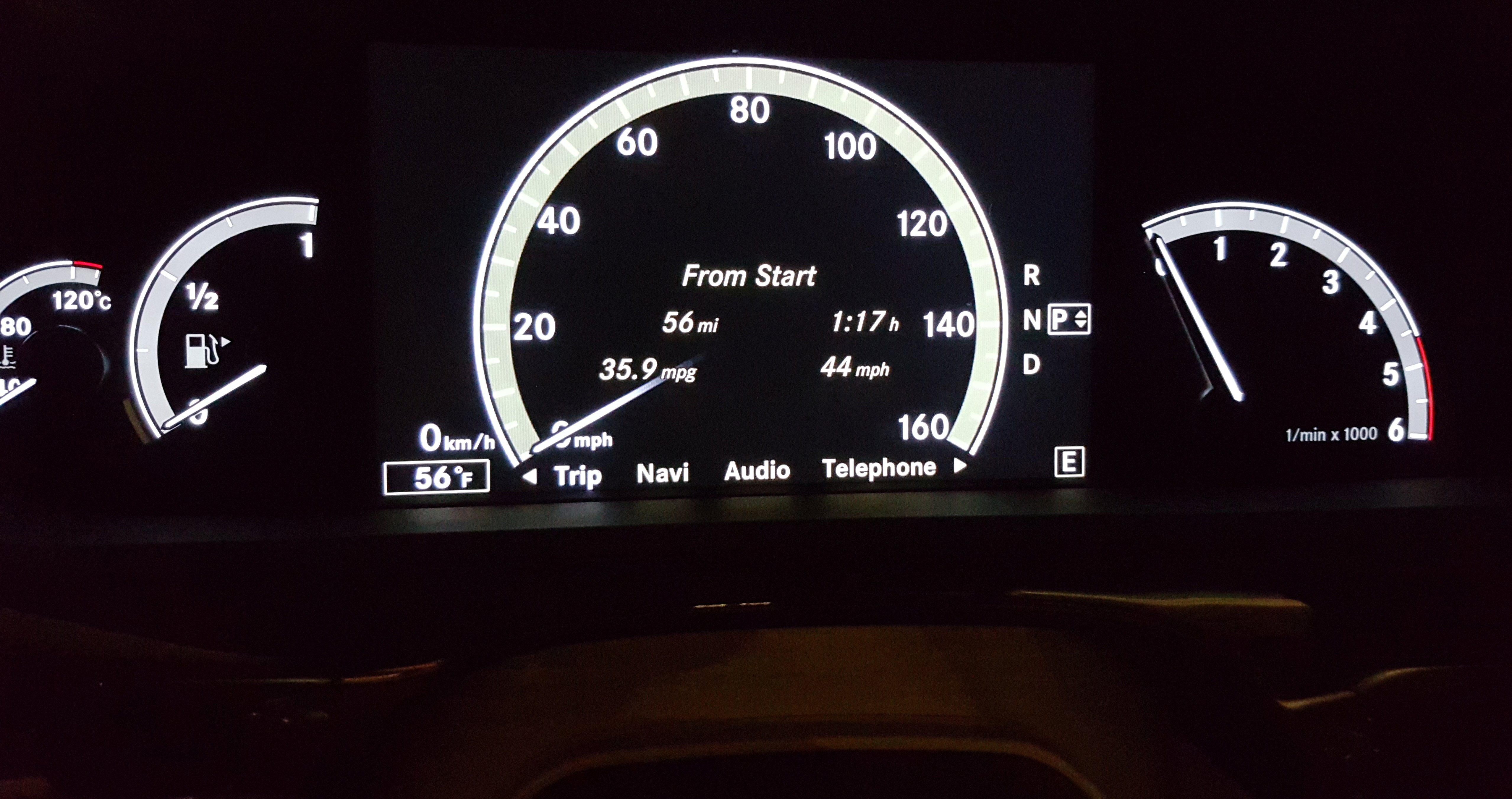

I did move from a 2007 W211 Bluetec to my current 2013 W221 S350. I think everyone has already addressed the concerns you had. I'll add a few bullets to this:
- The OM642 in the S-class is far quieter and more refined than it ever was in the W211.
- I have not noticed any oil leakage from the turbo to manifold gasket, or in or around the oil separator like there was on the OM642 in my old W211 and many others - no matter how many times I changed gaskets.
- The C(E)/S button on the transmission actually does change the throttle response and shift points.
- The 7G-Tronic plus transmission is better - but still suffers from occasional unrefined moments at low speeds, when the engine is cold. But nothing like the neck whipping downshifting in my W211 Bluetec
- The car while significantly larger than a W211 (esp since the USA market only got the long wheelbase version) , never feels that way. It is still highly maneuverable, and gets around parking lots and garages quite easily.
- For whatever reason, the trunk seems smaller than the W211 - not sure if this is true, it's definitely wider but maybe not as deep due to the false rear bulkhead.
See enclosed photo for a recently airport run I did from the East Bay to SFO. Arrived earlier and was playing with buttons while waiting....surprised that it almost hit 36 MPG (US)....despite the usual traffic hassles.
Attached Thumbnails Anyone move up from a 211 Bluetec to a 221 Bluetec? Opinions? Some concerns...-w221_om642.jpg
