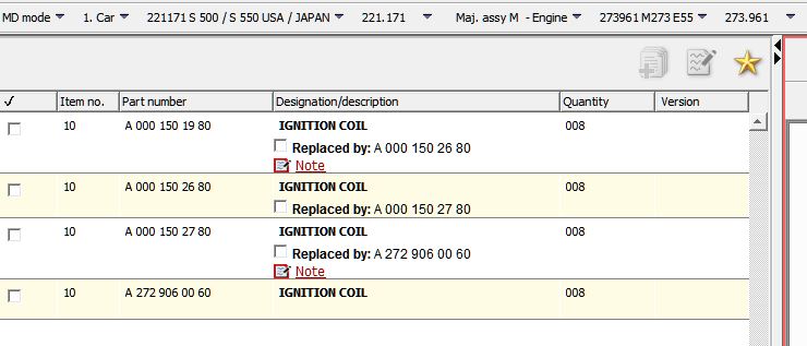

Is this
Is this picture accurate ?? Can't tell which car

here is a picture
