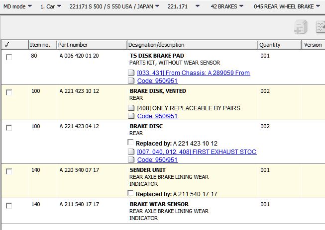

MY10 s550 see attachments.
https://www.parts.com/
http://www.mbdirectparts.com/
https://www.oediscountparts.com
Attached Thumbnails Front brake question-front.jpg   Front brake question-rear.jpg

Manufacturers and distributors catalogues often have fundamental errors in parts like brakes. There is often conflicting information, and it can difficult to know what to trust, even when you drill down to what you think is good source data.
The best way to be sure is to measure the diameter, thickness and height of your own rotors themselves.
Nick
This. Audis are particularly confusing and catalogs- erroneous.
If you have wis it would be the best source to obtain vin- dependent part numbers sight unseen.
