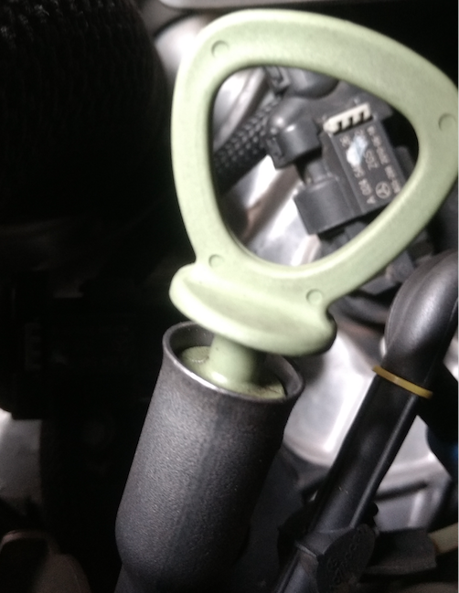

Does not happen while driving within city. Happens every time I make an outstation trip (3Hrs+). 2012 S350 (petrol) with 40K KM (not miles)
Dealer suggested O-Ring replacement, currently waiting for the part to arrive. I suspect the dealer is just guessing. Anyway to diagnose this better and avoid the trial and error drill?

O- ring is certainly the first thing to do (or new dipstick altogether), but if problem persists check crankcase ventilation system for obstruction.

New o-ring fixed it. Got lucky. Looks like this topic interested few folks
