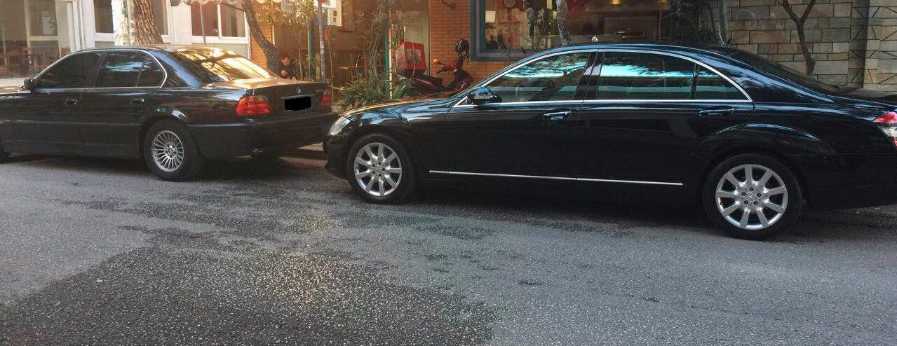

no wood wheel, but got Harman Kardon
parked behind my venerable E38 M62TU44 w/fresh VANOS, and rebuilt frontend timing drive (thanks BMW for plastic tensioners and single timing chain!)
