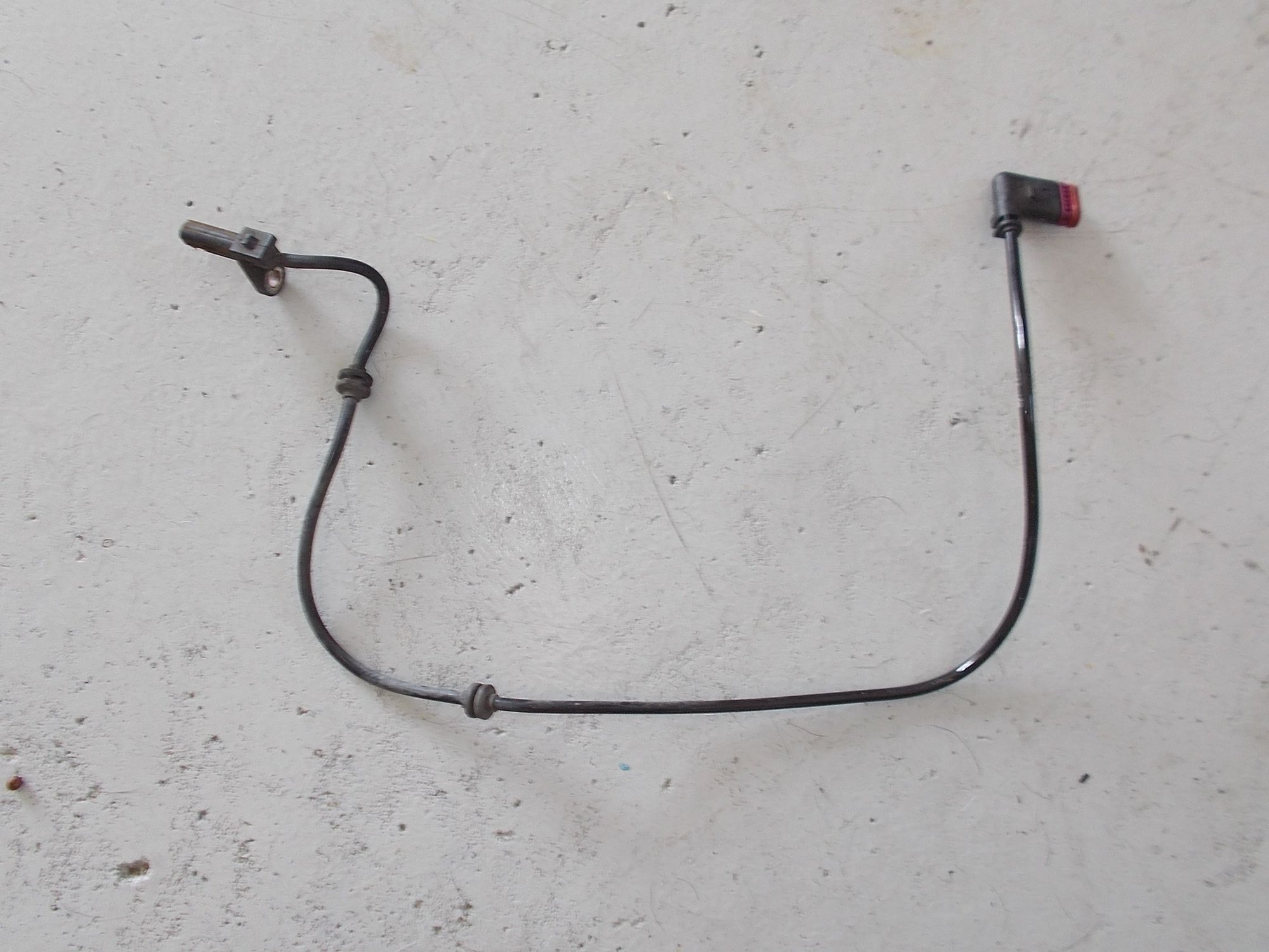

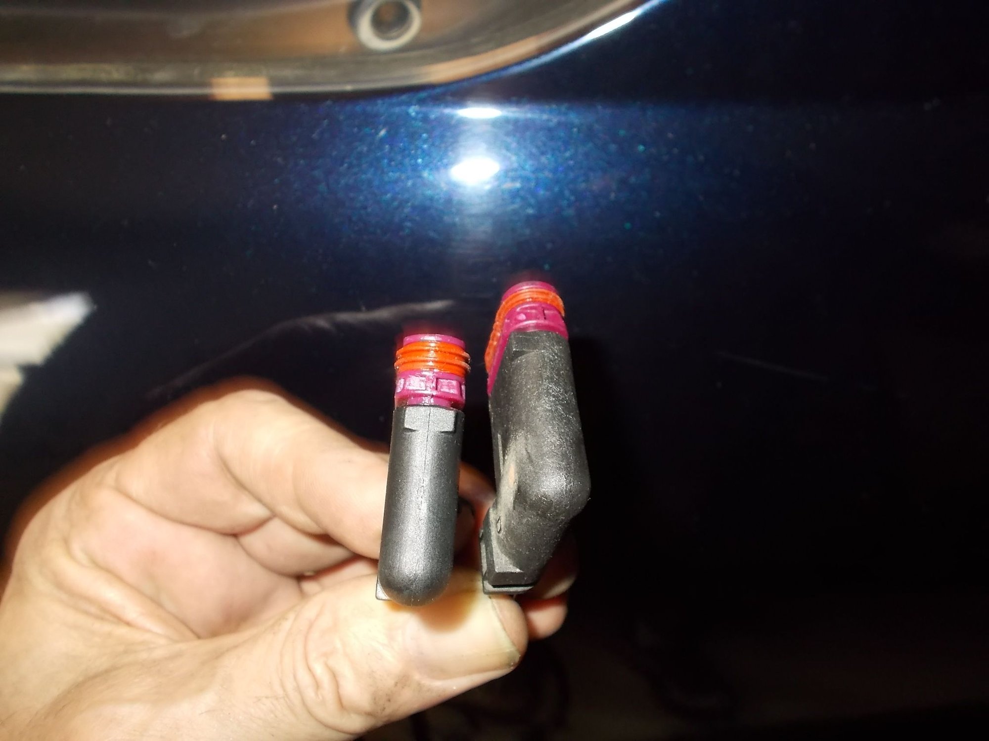

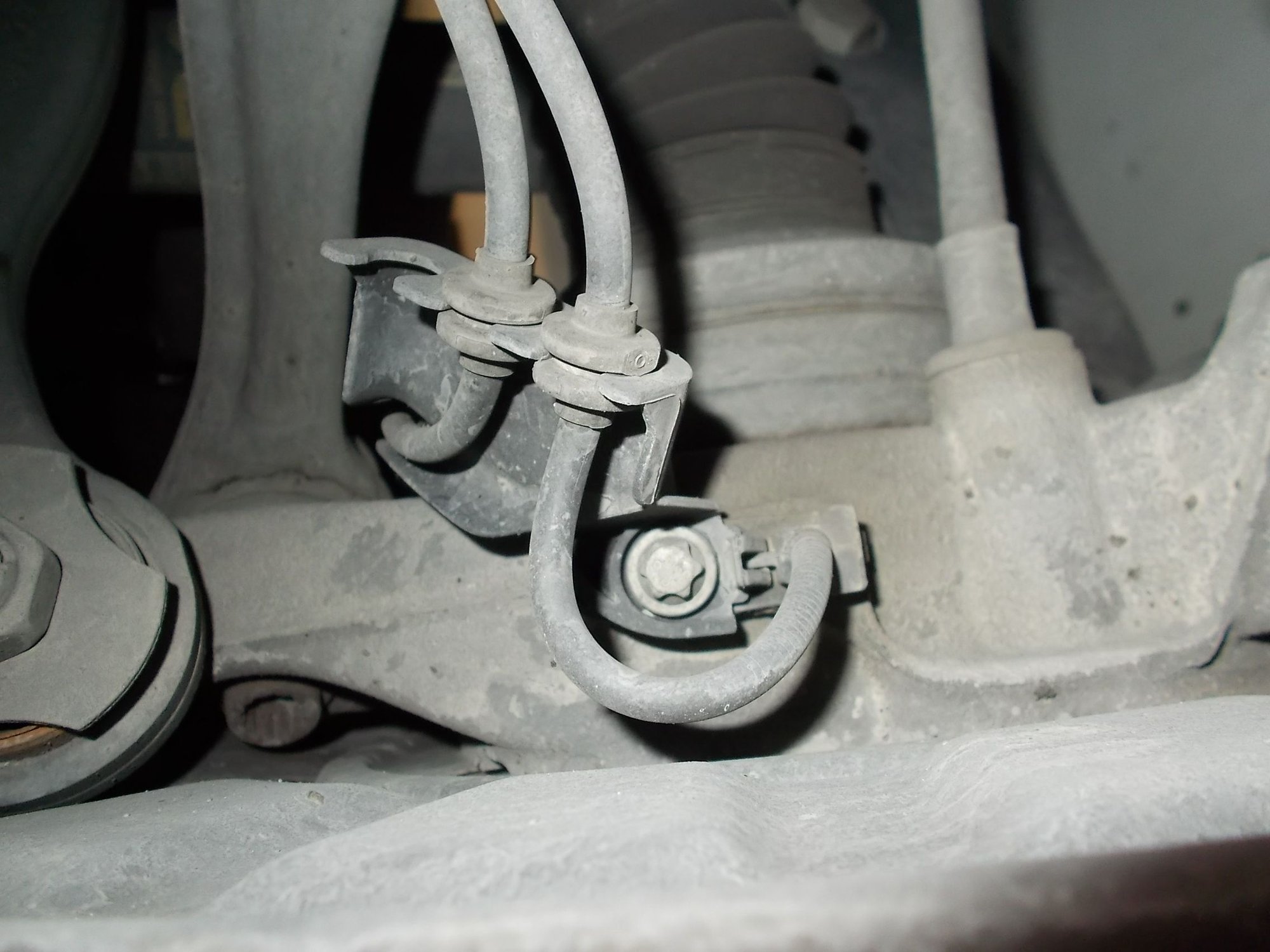

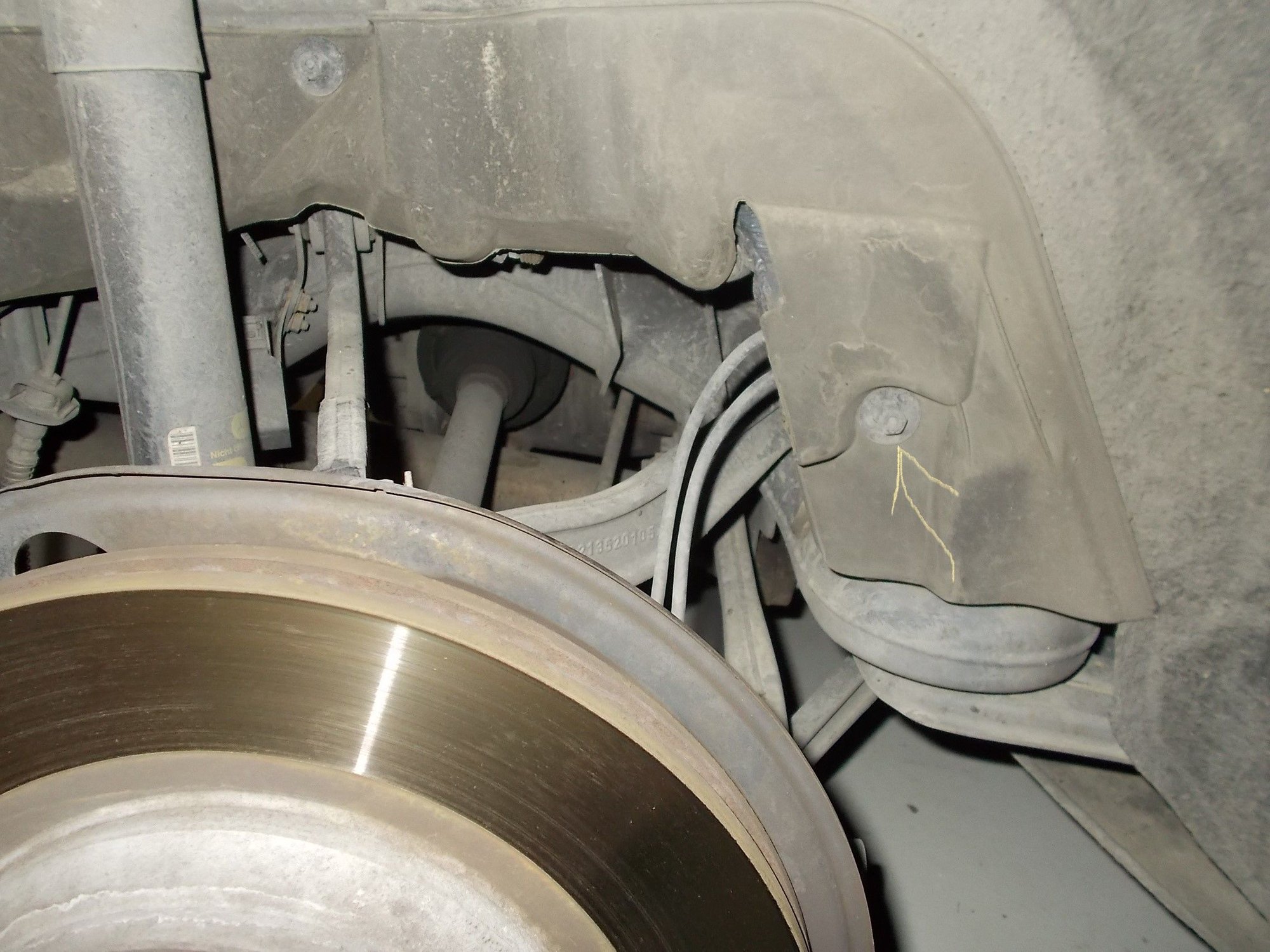

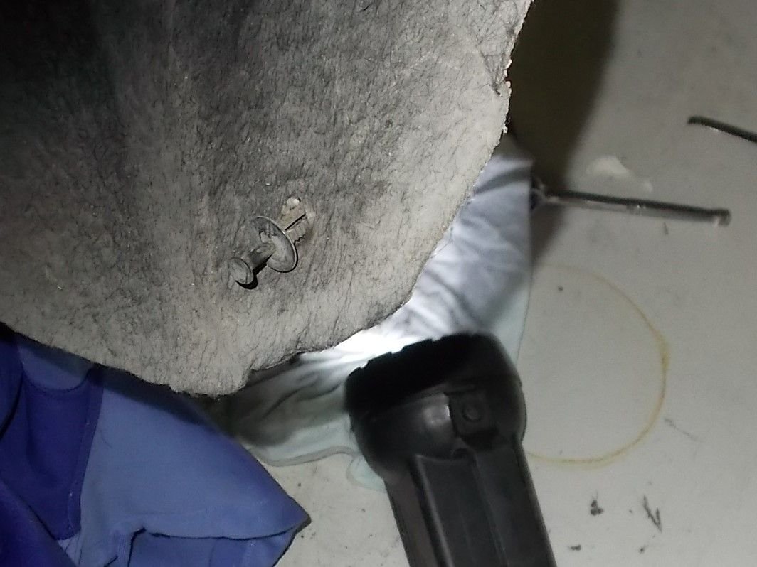

Replacing the Rear Wheel Sensor
To follow up, received the sensors, replaced the offending one and all is good. ABS, ESP, Distronic and Park Assist now working.
This isn’t exactly rocket surgery, but I didn't know that before I started, so took some pics in case someone wants to know what's involved. Sorry, I'm not too familiar with posting pics, so these may be overkill...
Hardest part was removing the 275-20 rear wheel-- used a long piece of schedule 40 PVC as a cheater on a breaker bar to loosen the lug bolts to save my back. They’re torqued at, I think, >100 ft-lb. And, I find using the jack in the truck works as well or better than a floor jack for lifting the car. I'm always weary of what jack point to use—Hint, raise the car with the button on the dash before starting for a little more room.
The sensor is inboard behind the rotor—takes an E10 star socket. Then you have to peel back the inner liner a little to get to the plugs. Removing the 10mm plastic nut and the lowest push-pin fastener is all that needs to come out.
Only thing that may not be obvious is that there’s a metal clip holding the sockets in. The upper plug is for the brake-pad wear sensor. Just pry the bottom end of the clip out a little with a screw driver or take it off altogether (see pic).
The old sensor didn’t show any damage and when I checked its ohm reading with a meter (DMM) set at 2000K ohms, I got about 400 for the old and about 500 for the new. So, I don’t know if that tells you anything. I’ve read you can use the DMM to read the AC voltage output of the sensor by spinning the rotor by hand. IIRC, these sensors work by spinning a series of magnets on the axle and the coil on the sensor generates an AC sine wave voltage that all the computers use to measure wheel speed. STAR/DAS allows you to measure the actual voltage, but there’s no reason you couldn't measure the output manually with a DMM by spinning the rotor by hand. You would have to figure out how to attach the DMM to the pins in the plug and spin the rotor; perhaps with alligator clips...
Bottom line, these sensors are not that expensive online, so if you don’t have STAR/DAS, I’d just get all 4 and start replacing them one at a time. The work involved to test each one hardly justifies the price of each sensor—unless you're paying dealer prices...
In that regard, I guess you get what you pay for. The replacement I bought for $8 works fine, but had two protrusions on the plug verses only one on the original (see last pic). No big deal; just had to grind the protrusions down and the one I replaced fit just fine.
What I don’t know is, if you just replace the sensors, whether the ABS/ESP will just reset without clearing the faults with the STAR diagnostic. EasyPhil’s link gives the STAR procedure if it doesn’t. However-- I'm just guessing here-- I think the ABS/ESP will reset when you reach door-lock speed unless you have the N47-5 codes EasyPhil was getting. I had already cleared my faults and had not driven to door-lock speed prior to replacing the sensor.
Hope this helps… Regards...Mark

https://nemigaparts.com/cat_spares/e...56/63w/54/640/ part 170 looks like 1 $17 check model I guessed
Thanks for your reply. Will get it check out. Thanks alot.
