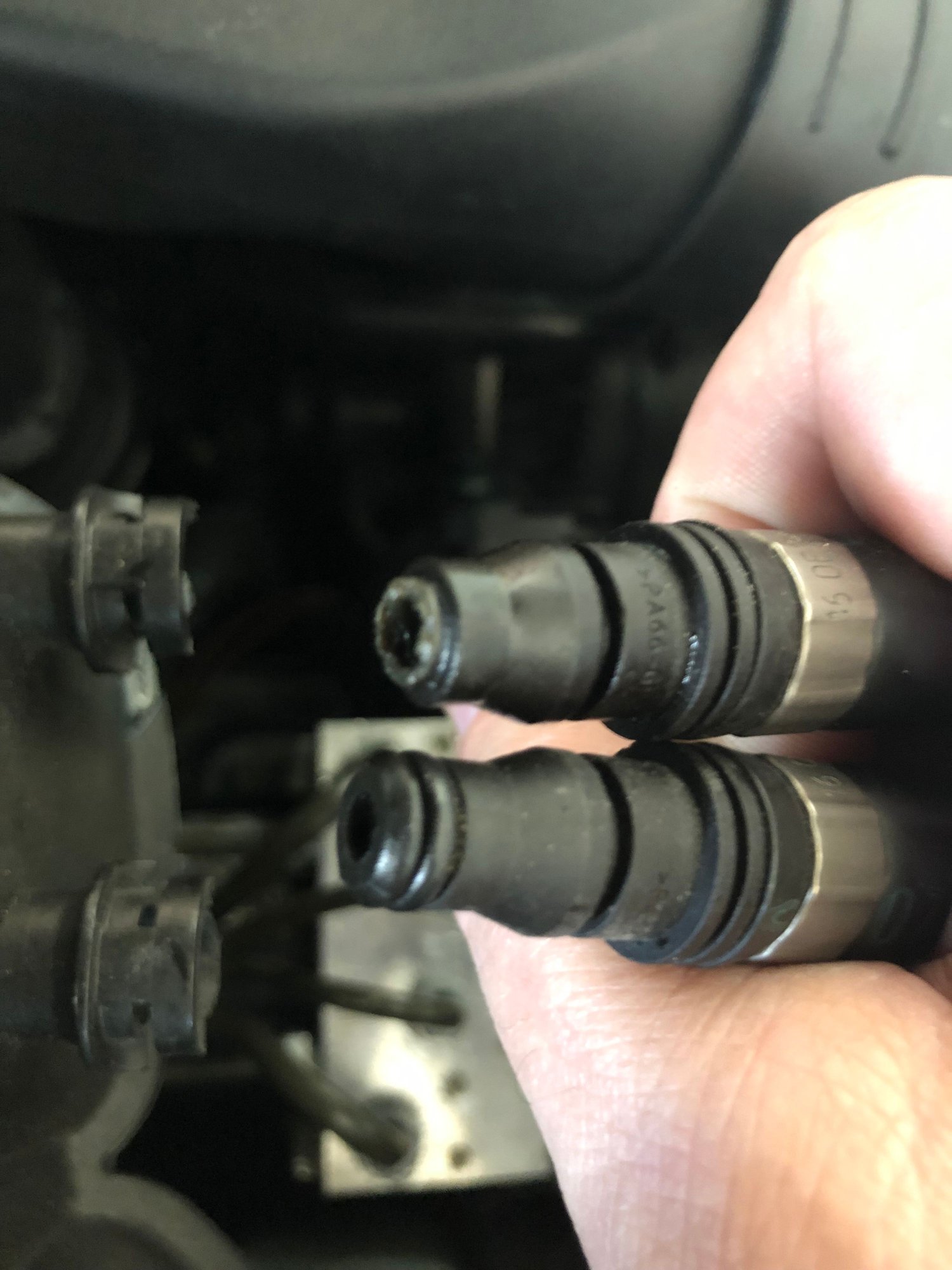

Broken end on coolant reservoir vent hose

Be very careful when you install those hoses back into the reservoir. Those two plastic connectors, formed into the reservoir, might be extremely brittle after 12 years of heat. I was just cleaning my engine bay and while scrubbing around that area they disintegrated into pieces. I had to buy a new reservoir .

Yeah... the repair guy mentioned that also. I’m actually going to stress it a little. If it needs replacing, I want to do it myself IN THE GARAGE at my leisure, and not at a dealer somewhere out of town while on vacation.

OP when it leaks coolant again if not sooner....
The reservoir that pair of hoses connect to is every bit as brittle as the hose that broke and not expensive.
No one wants to learn of this 300 miles from home.
Perhaps charge cooling circuit is different for S-600 vs my S-65? I have had zero issues bleeding it. Got to have it open a few times. Patience and letting the charge cooling pump run got it done. Handy spots to bleed it at on heat exchanger in front and at charge cooler cores.
Food for thought.
I've checked it -- it's fine. Not brittle at all, at least no more than that particular plastic is to begin with. For that matter, the hose end is not particularly brittle. It seems to be in good shape, just broke at the O-ring groove. The car is 13 years old this month, but only has 49K miles, so it's probably not as bad as a lot of them this old.
