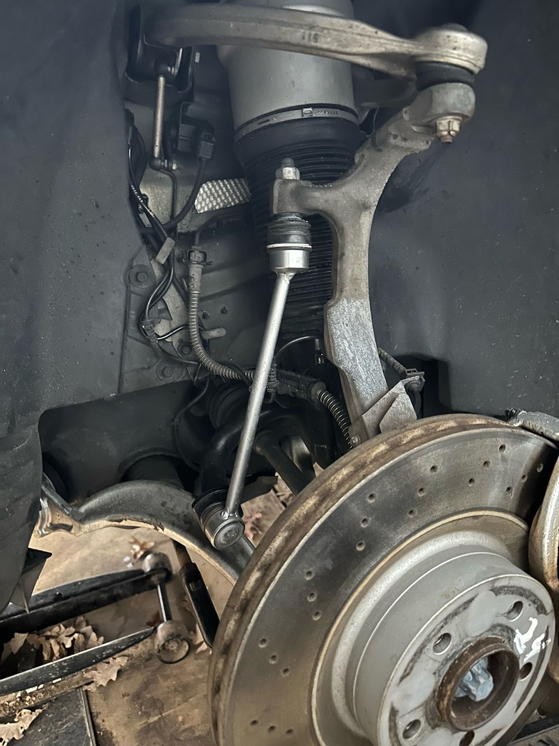

2010 CL550 4matic with the same problem, the worst part is i just replaced A TON of parts this week!(forward and rearward lower control arms, outer tie rod links, sway bar links, air suspension springs/struts..these are all brand new parts, this car is well maintained) it makes the noise whether stationary or driving, in the video im just lifting and lowering the suspension. it was fine for a few days i believe, and then this started. also, this video isnt great..it creaks/squeaks much more when driving/turning the wheel.

heres a better video, this is while turning the wheel..any opinions are greatly appreciated.

In this video it makes big “ snaps”.. Are you sure you torqued the lower control arms bolts on the car frame side correctly AND at correct car level?
Sounds like something snaps with car level changes, which could be the arms mounting core that turns when rubber around the core gets enough torque with car level change.
Arms mounting bolts have high torque to lock the joint core in place and torquing of the bolts needs to be done when gar is in the correct level so the arms can move up-down in both directions without putting too much torque on the rubber around the cores. For the level I use the zero level that is set to the Airmatic.

Hey arrie. Yes, before changing all lower control arms I measured the distance from the center of the hub to the bottom of the wheel well(it was 15-15.5”) after installing all the new lower control arms I used a second jack to bring the hub to that exact height again before torquing them. Also, after replacing all these parts I brought it to a shop, just to have an alignment done. I’m worried maybe they did something wrong.
also, I’d like to be as thorough as possible. I replaced the outer tie rods, not the inners. I doubt that’s the issue but I’m trying everything, could that be it?

What torque did you use on the arm bolts?
I’m a bit at lost with inner and outer tie rods. What do you call those?

torqued to 80Nm stage 2 150 degrees..it’s the same torque for the forward and rearward. I’m at such a loss too. What would you suggest I try?
also, if it helps. These are what I replaced, not the inner tie rod it’s threaded to.
