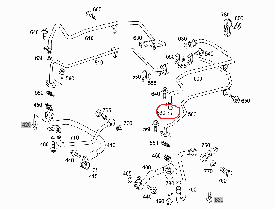

Today I fixed the cooling system problem -- the one for which the shop proposed removing the left side turbo and replacing the stainless steel hard coolant lines. Twice, a it turns out from re-reading the estimate -- there are two coolant lines, and they had four different part numbers listed for some reason. Anyway, it did turn out to be nothing more than the O-ring on one of the coolant lines, as I thought it might be. There was a notable leak when I vacuum tested the system; after I replaced the part it's air tight with no leaks at all.
Shop estimate to repair cooling system: $3281.23
Parts cost: $7.88
Tools & Materials: $101
Shop time (service bay rental): $120.00
Total spent: $228.88
Total Saved: $3,052.35
And that includes the
cooling system fill/test kit cooling system fill/test kit
, which I'll no doubt use many more times. The full story is http://dale.botkin.org/2020/08/16/cooling-system/ (blog post).
I also did most of the ABC work today, but it isn't quite finished so I'll post more about that later.

Very nice works. Curious, did the coolant system fill test kit helped you to locate the bad o-ring? Or how did you figured out the location of the bad o-ring? Sounds like needles in the haystack.
No, I had seen that when I replaced the coil packs a few months ago. I knew it was seeping a little bit, but it has apparently gotten quite a bit worse. I even had the part, it's an oddball non-standard size O-ring. I had tried to replace it before, but wasn't able to get enough movement on that coolant line to get in there without disconnecting another coolant line that would drain the intercooler circuit, and I know what a pain in the *** THAT is. This time I decided that there really was no choice, I can't just keep dumping coolant in there and letting it blow all over the bottom of the car. If I had skinny little girly hands it would have been a lot quicker and easier, but I've got to try to shove my XXL boxing gloves in there...
The vacuum tester will tell you if you HAVE a leak, but not where it is.

Do you have the part number or a diagram of that cooling circuit? I'm interested in understanding on the phenomenon of dumping coolant when cold.
Totally agree with you on self maintenance. I ran into couple issues with works from dealership: a V8 engine oil filter on a V12 (no filtering for >5000 miles); missing brake lid cap after brake flush service (discovered after 3month so it needs another flush). If you don't look at it once in a while you will just never know.
My theory is that, as the engine cooled down, it allowed air to be sucked into the system. Now you've got air in the cooling system that expands and causes numerous problems. I cannot quite understand why, though, it ONLY dumps coolant (in volume) overnight... that part is just plain weird. But by all evidence, it was indeed leaking coolant while driving -- although it wasn't enough for me to notice other then when it would dump it overnight. It's the oddest cooling system problem I've ever dealt with. Everything makes sense except the one big symptom... and I'd love to fully understand that one.

Sounds like you are doing coil packs on the same side as the leak. Wonder if leaked air caused CEL misfired when coil packs isn't 100%.
No, I replaced the coil packs a few months back. The driver side was in pretty good shape, the passenger side showed some corrosion around the plugs. Something had gotten down in there, maybe coolant long before I bought it. Plus, the passenger side valve cover gasket had been leaking oil down into the plug recesses. Anyway, diagnostics pointed to the coil packs, so I bought a couple of rebuilts from V12ICPack.com -- the guy seems to know his stuff. I figured even if the coil packs were not causing that problem, it was only a matter of time before they had to be replaced. They're not known for longevity, I guess. But you have to remove the coil pack to get to that stupid little O-ring.
