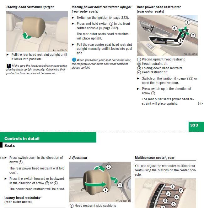

Are you pressing the same button? That button only lowers.

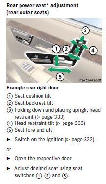

They are supposed to go up when the rear seat belt is latched or when you use the headrest control on the rear door.

Unless of course OP has adjustable rear seats (233) which does not seem to be the case: https://mbworld.org/forums/s-class-w...ml#post8069731

By George, I stand corrected. Holding the center console headrest button down does indeed stand them up. Didn’t know that, thanks for the tip.

Mine goes up too when the button is held. I stand corrected.
Always fun to learn something new.
