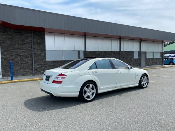

2001 s500l
2007 s600 Guard L Original price
I have searched hi and low to find the original price of this car.
I might be buying it. 60,000 miles.
Other than being a heavy car what are the disadvantages?

That's interesting, I've never seen a 600 come with the AMG kit.
IIRC, they had trouble supplying Distronic units in 2007, so they added the AMG exterior package as compensation for those vehicles without it.
