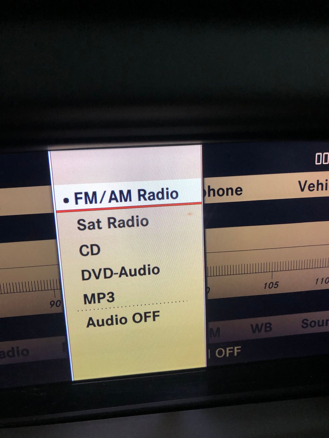

I spent something like $12 and an hour or two installing a Bluetooth module that connects to the AUX input of the M-B stereo system. It's great -- the ONLY thing it won't do is control playback with the steering wheel buttons. You do have to have ant AUX audio input enabled. You can check that by scrolling through the audio selections -- AM/FM, satellite, etc. If there is no AUX selection, then it needs to be enabled using the diagnostic software. We recently did a road trip out through Yellowstone, Devil's Tower, hte Black Hills, etc. I was able to stream Amazon Music everywhere we had cell coverage, which was nice. The sound quality is "just OK", certainly good enough for podcasts.

The owner sent me this photo. Looks like aux is not enabled. I wonder what MP3 input does.

Plays MP3 files from a PCMCIA memory card... and yes, you can use an DS card in a PCMCIA adapter, but the whole thing is so klunky I wouldn't bother. It also won't play MP3 files from a CD or DVD. If I were buying again... I'd look for 2010 or newer, to be honest. A lot of the electronics features on the '07 were bleeding edge back then, but are are way out of date. Oh, also -- it's a Sirius receiver, NOT Sirius/XM. That means lots of random dropouts, even when in perfect conditions on the open road. So the satellite radio is not much use. The FM works fine, though it's not HD.
