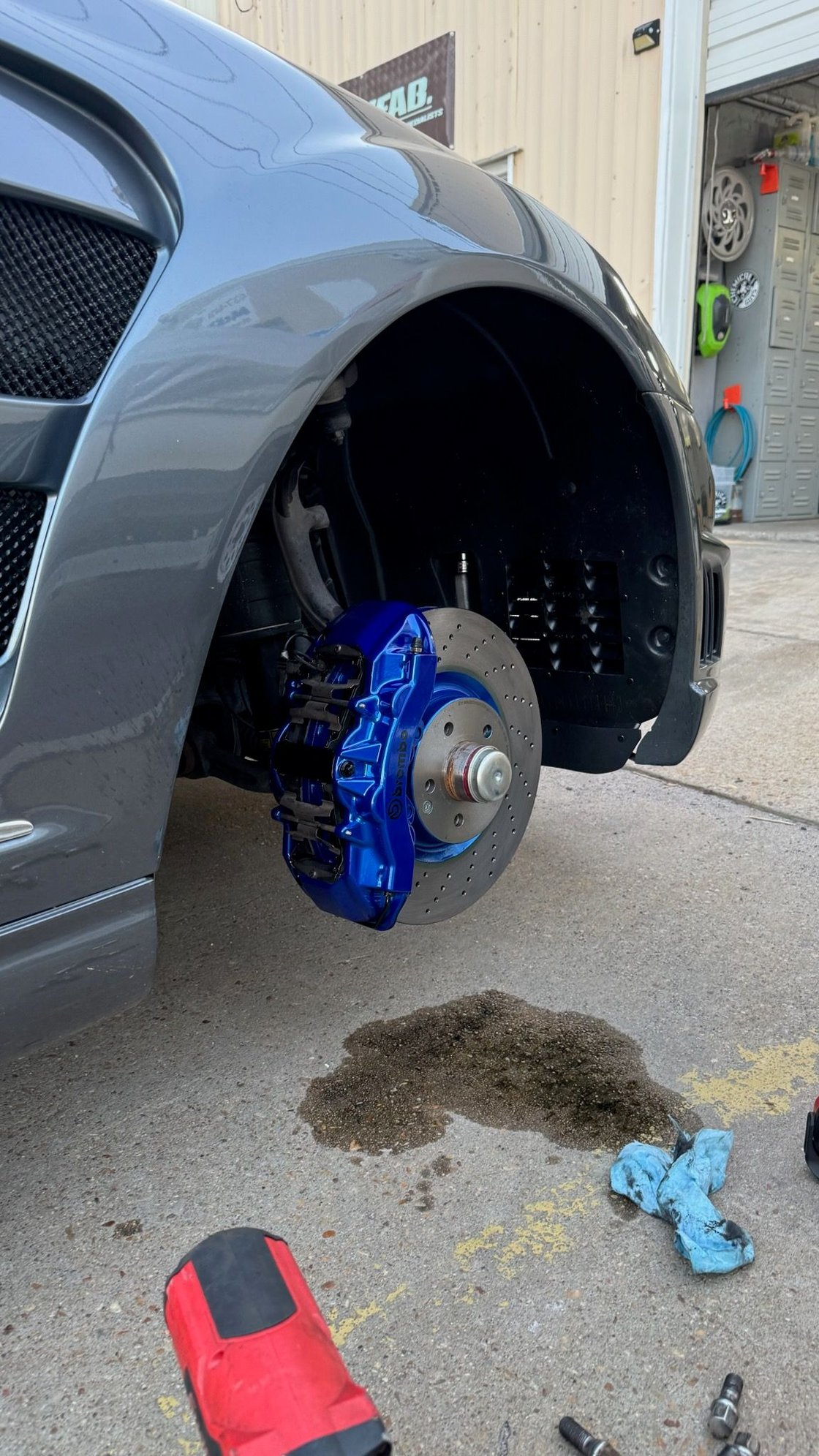

E55 AMG caliper swap! Gathered info from an older post and thought I would share.

I have 255 front and 285 rears. It stops great no issues.

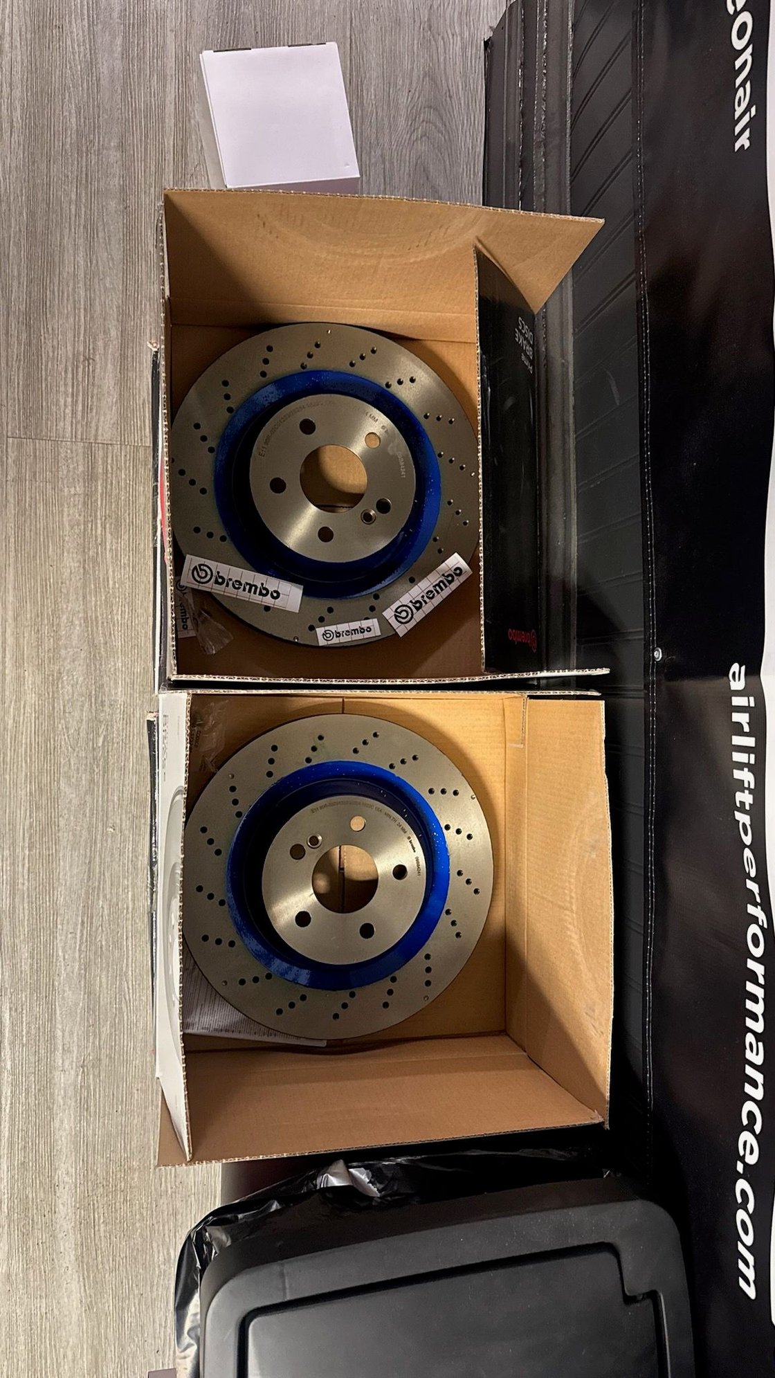

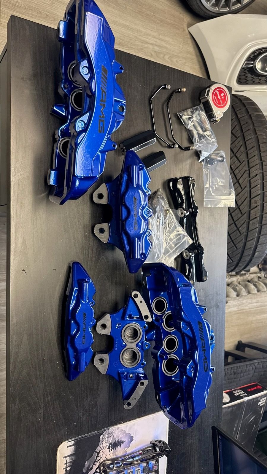

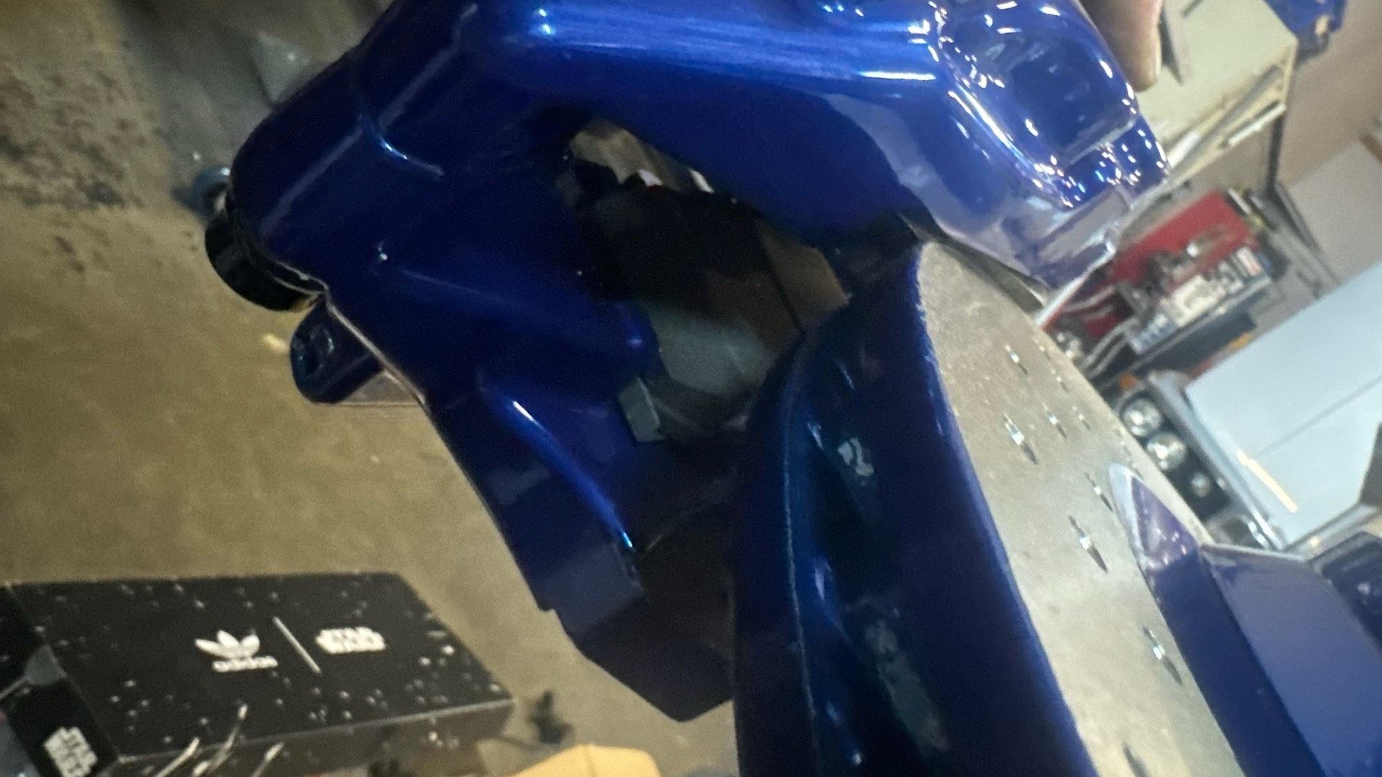

07s550 - SL55AMG rotor won't align with E55 AMG rear caliper
Hello All,
I am having an issue hopefully someone can help me with. I have a 2007 Mercedes s550. I was trying to find out if any of the other models of brakes would fit my car. My installer conducted some research and found that the E55AMG front and rear calipers will fit the 2007 s550 but you must use E55 AMG front rotors and SL55AMG rear rotors due to the parking brake setup. No problem with setup on front but the rear SL55AMG rotor will not align/center with E55AMG rear caliper. But it will align/center just fine when its off the car. Pictures attached. The rotor is about 1/4 inch forward of the caliper center line. Does anyone know if something else must be done for this to work. Possibly an adapter needed for the rear caliper? Any assistance would be great.
