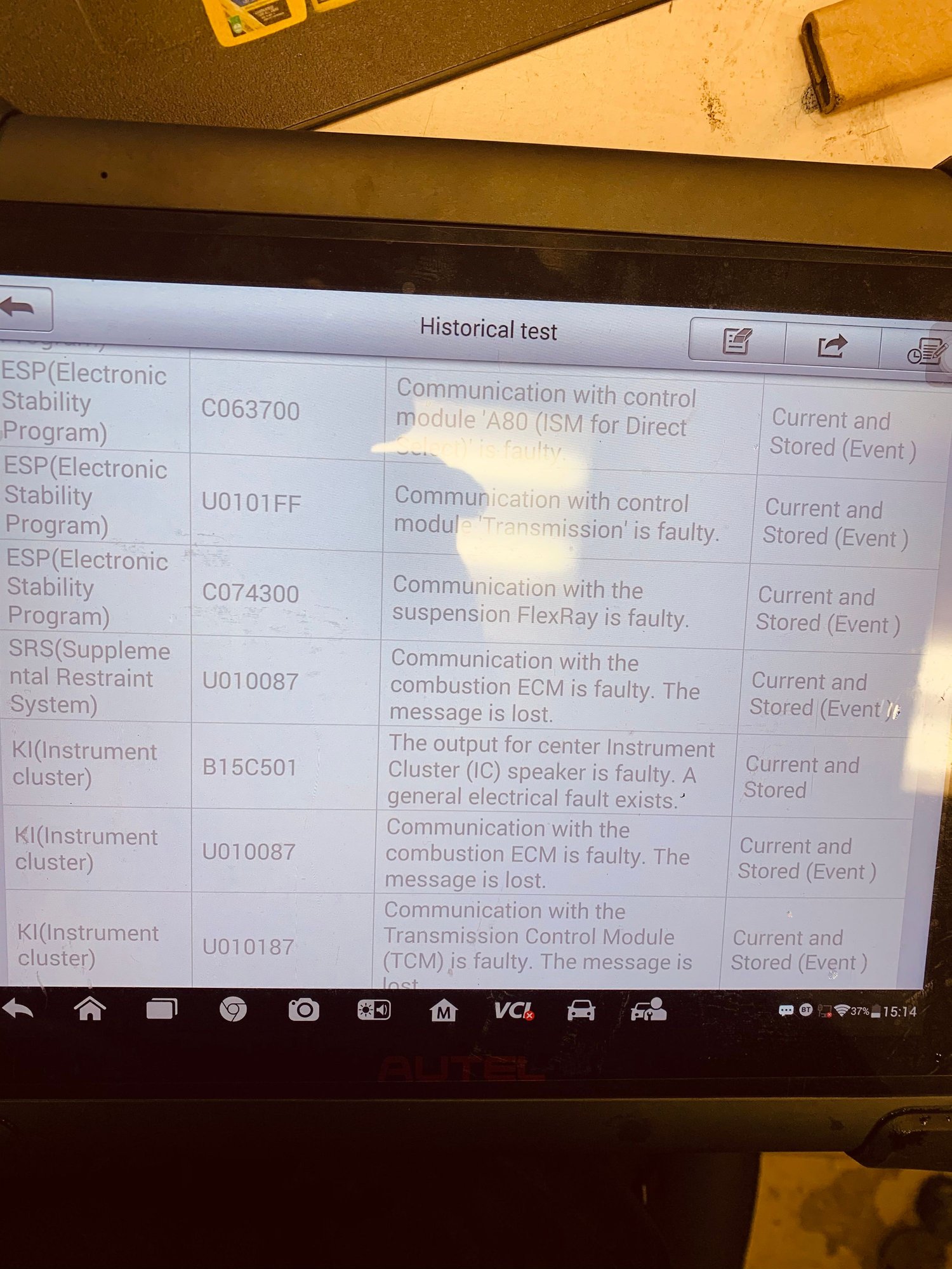

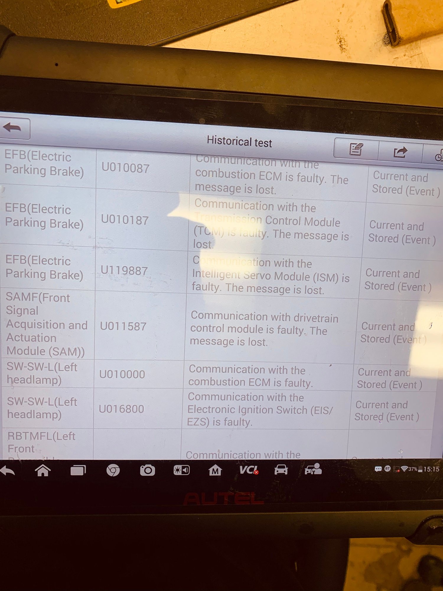

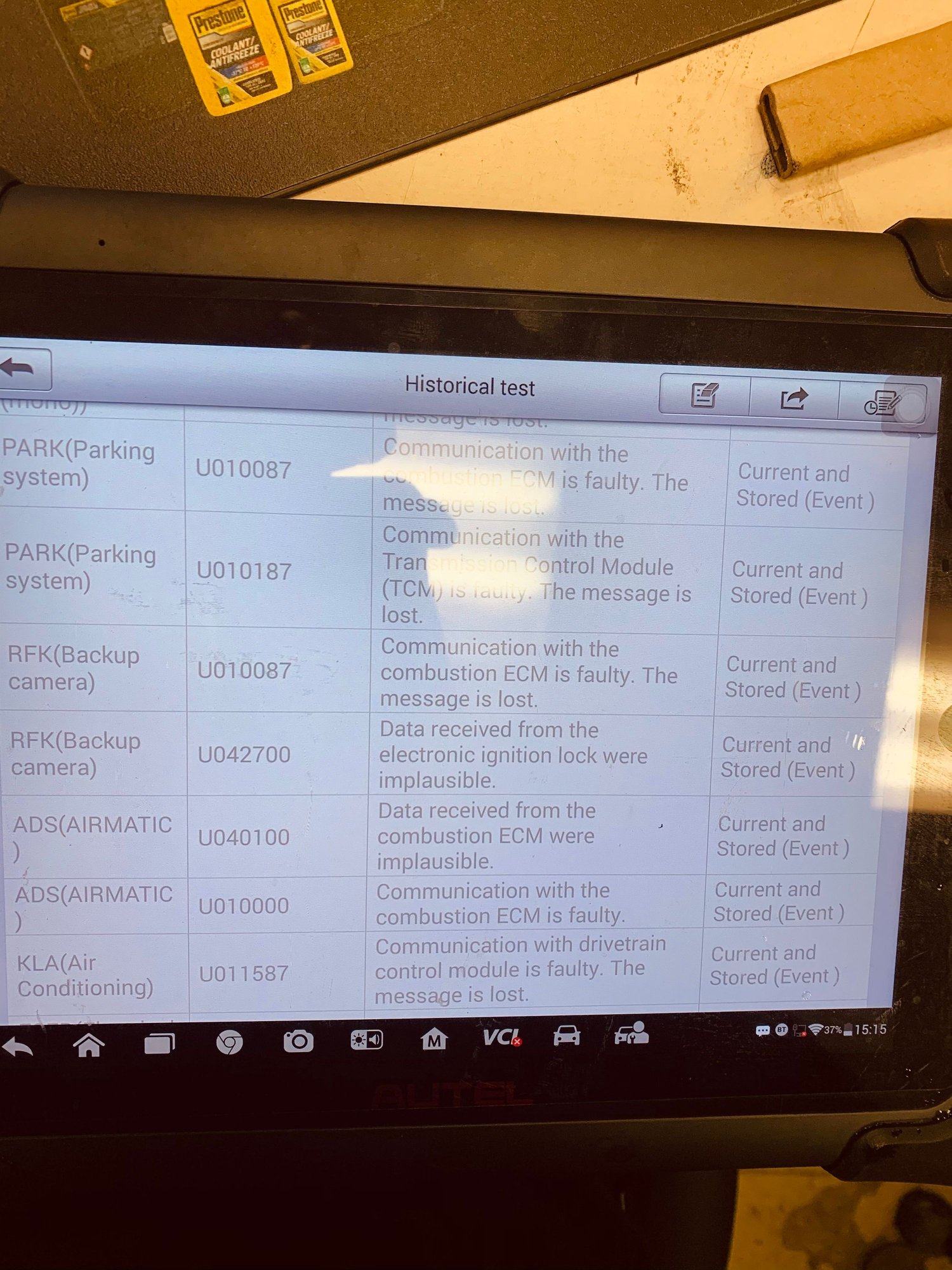

Hi here is the codes using an autel maxysis
Old Jan 15, 2021 | 10:29 AM
MikeJ65's Avatar
Joined: Aug 2020
Posts: 1,326
Likes: 365
From: Gretna, NE
'03 SL55 Black, '03 SL500's Aegean, Mars Red, Tazanite, Alabaster, '11 S550 Flint Gray
Are you able to connect directly to the engine and transmission modules with your scanner? If not, you need to start by checking for power at those modules. It is possible that you have CAN bus issues, but it looks more like power problems to me. Once you have established that everything is powered and communicating with the ECU and TCU, clear all codes and start fresh. If you still have a no start, start with the immobilizer and go from there.

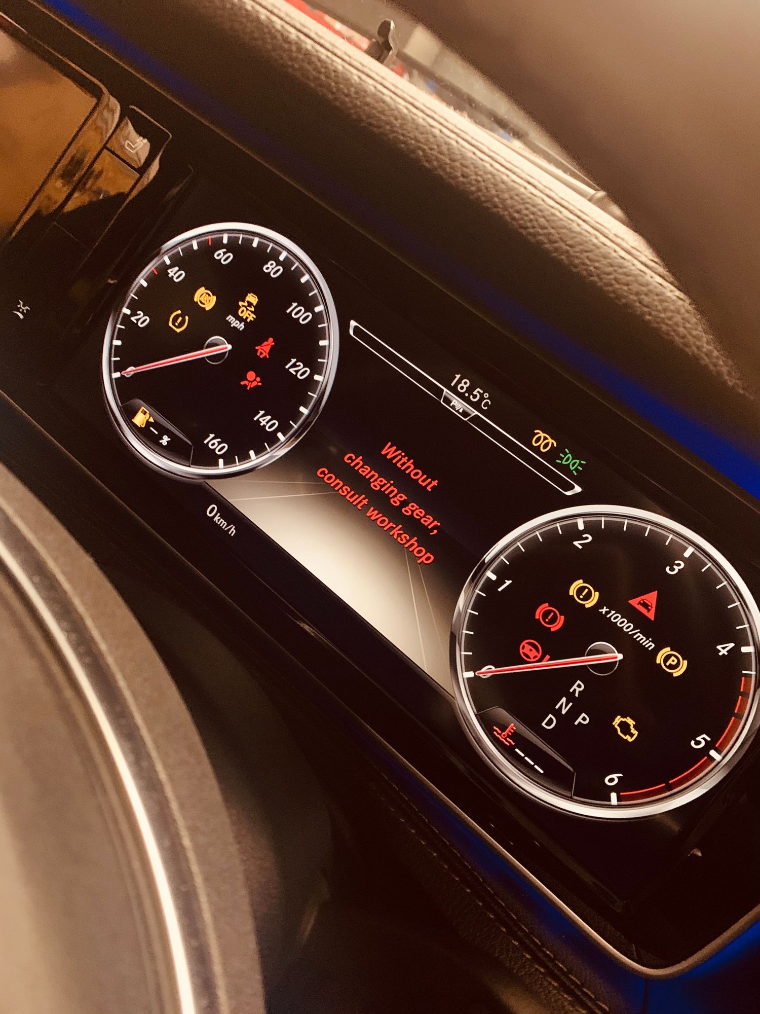

Fuse number 432 rear fuse box is the one that is no signal on it at all
this is what I get with ignition on
