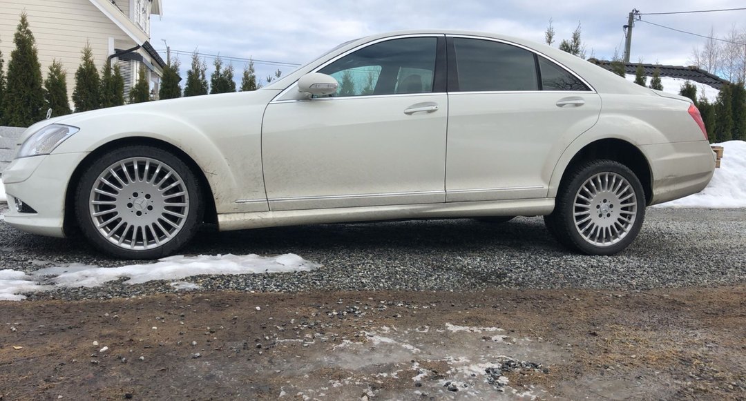

I was driving on highway, and sudnly i got message on screen FAIL ( picture of lifting car).
Rear of the car lifted as higst possible and its stuck, wont go down. Can someone help me what that is?

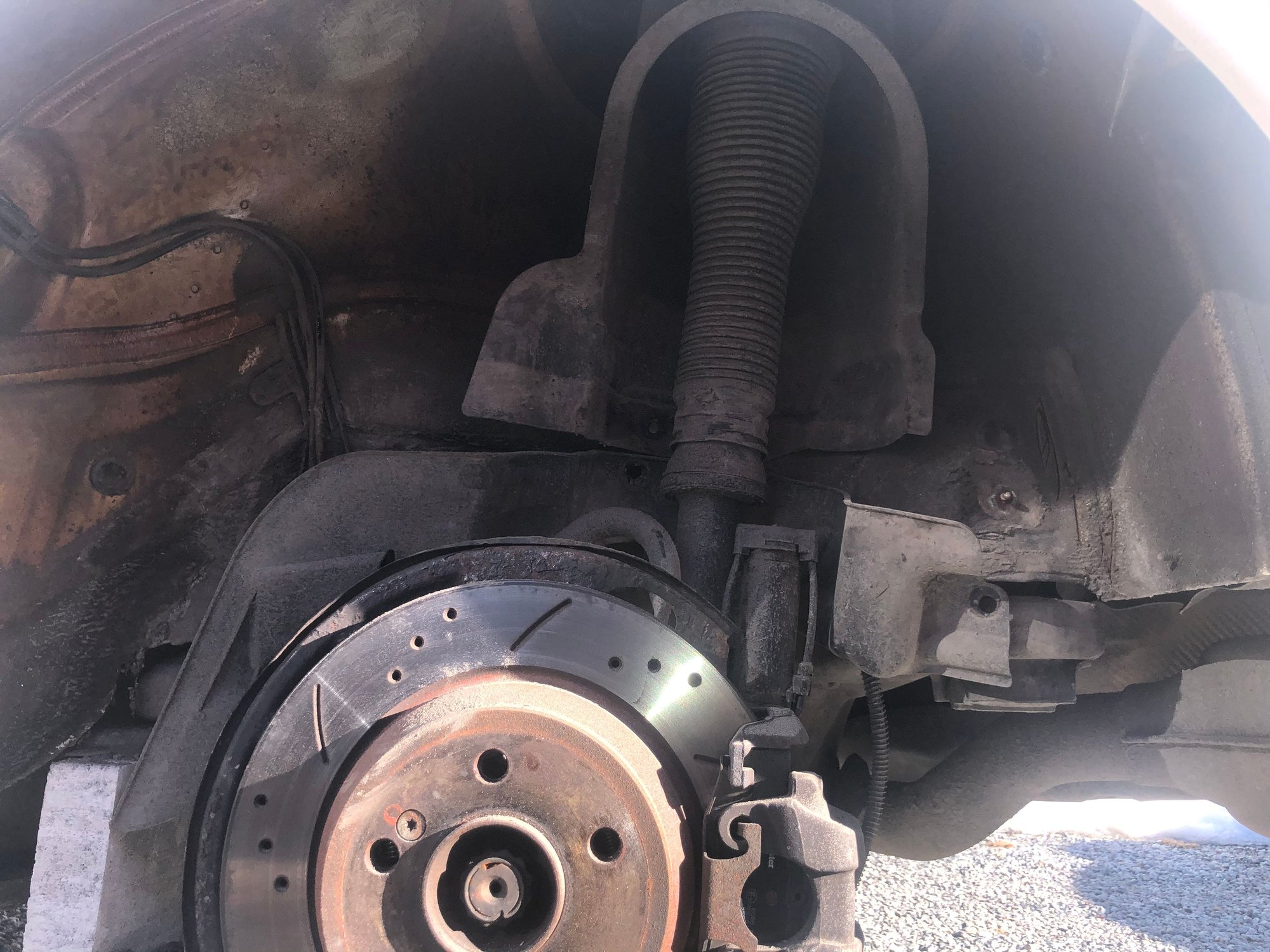

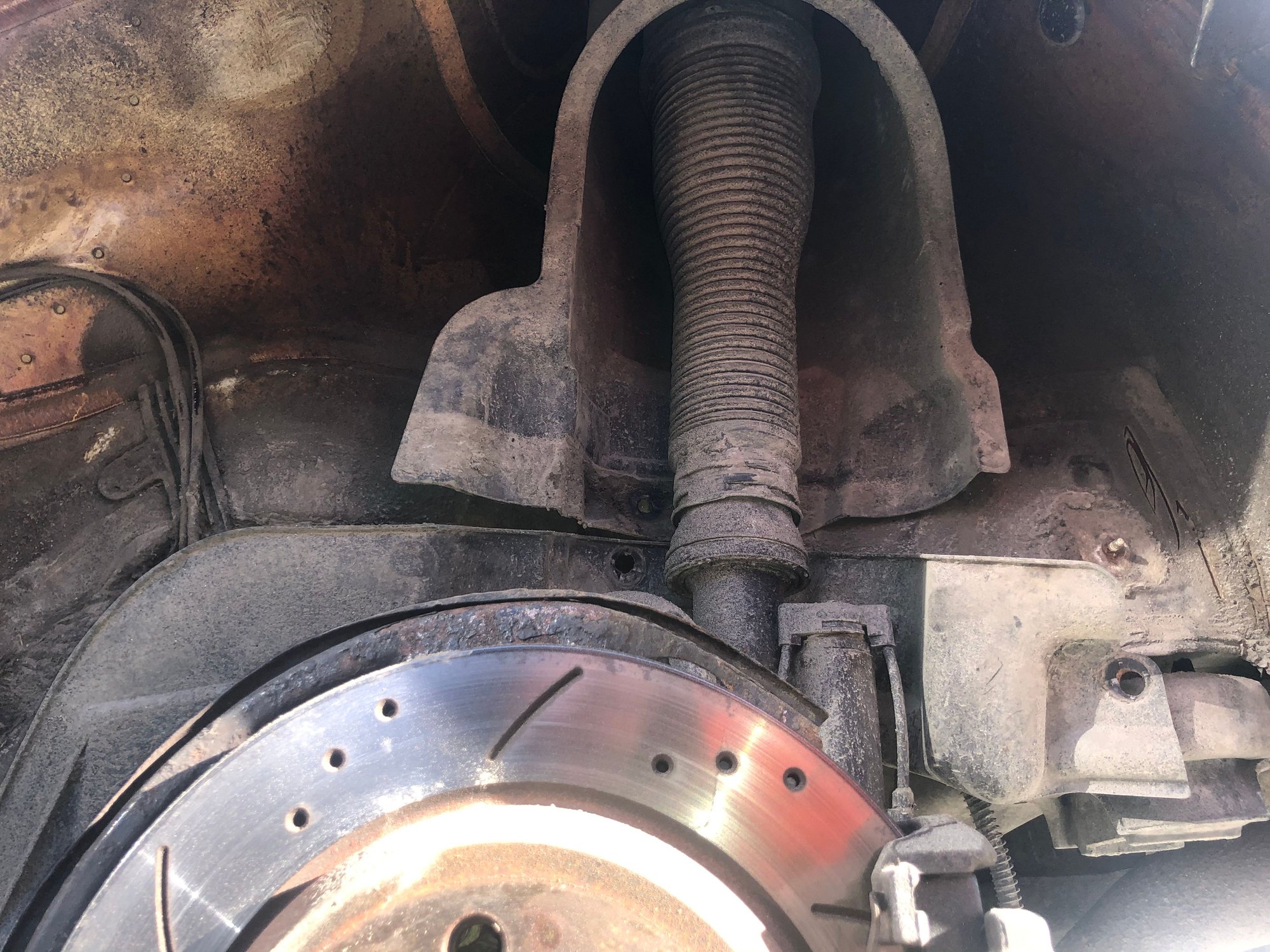

Old Mar 17, 2021 | 10:27 AM
millamg's Avatar
Joined: Mar 2021
w221
There is no rod ad rear axel. I checked.
Rear axl
Rear axl
Old Mar 17, 2021 | 10:55 AM
EasyPhil's Avatar
Joined: Feb 2009
Posts: 713
Likes: 214
From: Brooklyn, NY
2007 S550 4Matic 2013 S550 Base
It's in the middle of the rear of the car attached to the rear sway bar, you have to be under the car with a flashlight and is not visible from the angle of the photos you have posted. Get all the way under the car or get it on a lift and you will see it.

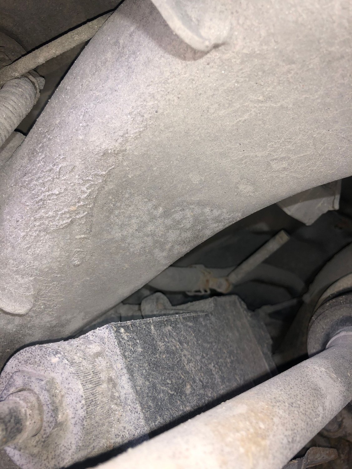

Old Mar 17, 2021 | 11:42 AM
millamg's Avatar
Joined: Mar 2021
w221
Originally Posted by EasyPhil
It's in the middle or the rear of the car attached to the rear sway bar, you have to be under the car with a flashlight and is not visible from the angle of the photos you have posted. Get all the way under the car or get it on a lift and you will see it.
This one ?
Old Mar 17, 2021 | 11:49 AM
BOTUS's Avatar
Joined: Aug 2014
Posts: 5,319
Likes: 1,675
S500
its well hidden, from left, look in 18", in front of the rear wheel.... as per the last photo
its sits ABOVE the park brake module
Old Mar 17, 2021 | 11:58 AM
BOTUS's Avatar
Joined: Aug 2014
Posts: 5,319
Likes: 1,675
S500
that looks like the bracket that usually snaps off is OK and the link rod just fell to bits on the sensor end...
you could just swap the link using the new ball and socket on the sensor end and pop the other plastic ball joint on to the bracket that's still on the anit-roll bar.
But double check its integrity if all four of the silly 2mm bits that locate the ball to the clamp are not fractured and the new socket moves nicely on the old ball you could get away with it... otherwise its super nasty. There is no way u can clip the clamp on the anit-roll bar in situ...
Old Mar 17, 2021 | 12:44 PM
EasyPhil's Avatar
Joined: Feb 2009
Posts: 713
Likes: 214
From: Brooklyn, NY
Originally Posted by millamg
This one ?
Clearly broken.

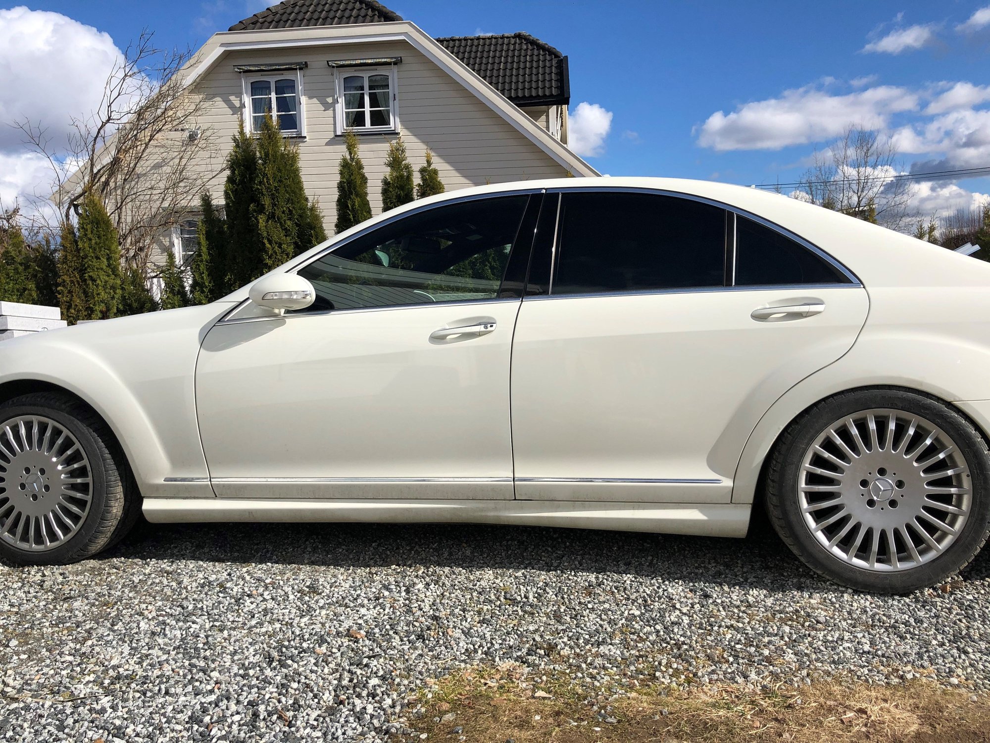

Old Apr 9, 2021 | 09:25 AM
milamg's Avatar
Joined: Mar 2021
Posts: 8
From: NORWAY
W221 S320 - W221 S65
Just replaced the ROD and nothing happend, Turned ON the car, Nothing. When i hold the LIFT UP butten. The car lowerd rear. All the way down.cant drive the car , the tires will scratch body. WHAT TO DO?

Old Apr 10, 2021 | 06:07 AM
milamg's Avatar
Joined: Mar 2021
Posts: 8
From: NORWAY
I just replaced the orientation as it should be. The car did get up a litte bit , and the lift up butten work as well. But the car is still low at rear.
