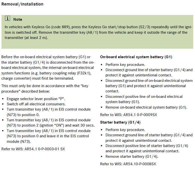

Used car sales in Georgia are “as is” law only provides for a three day right to rescind in the case of door to door solicitation sales, vacuum cleaners, encyclopedias. If this is your only code check both batteries (engine compartment & trunk), and alternator. Battery replacements, search MB part #s 2305410001 (12V/35AH) & current 0019828208 (12V/92AH) or previous 00554110001 (12V/95AH) which should also yield compatible aftermarket.

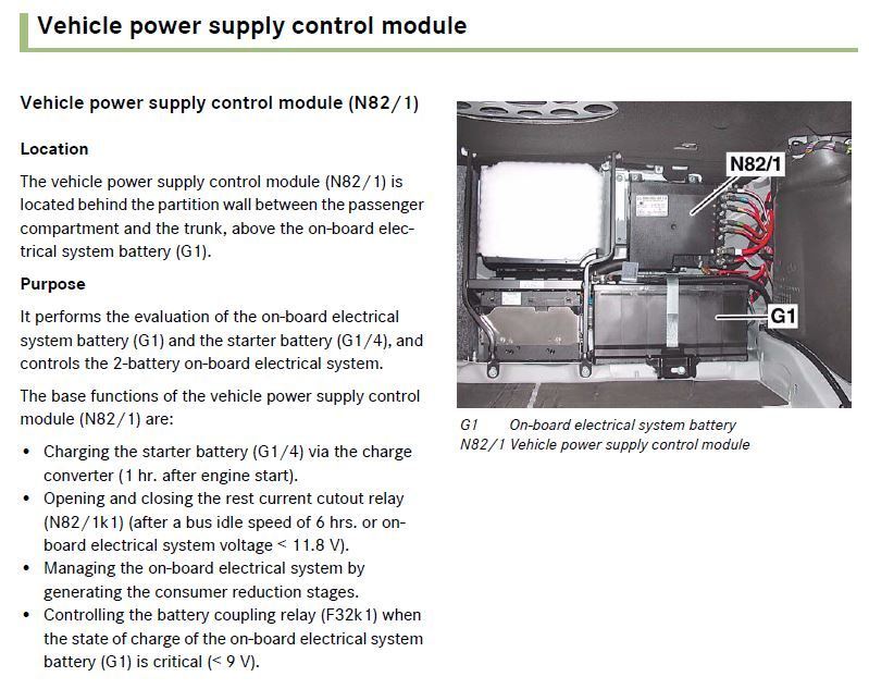

the module above the big battery in the boot controls how they both charge, it can play up

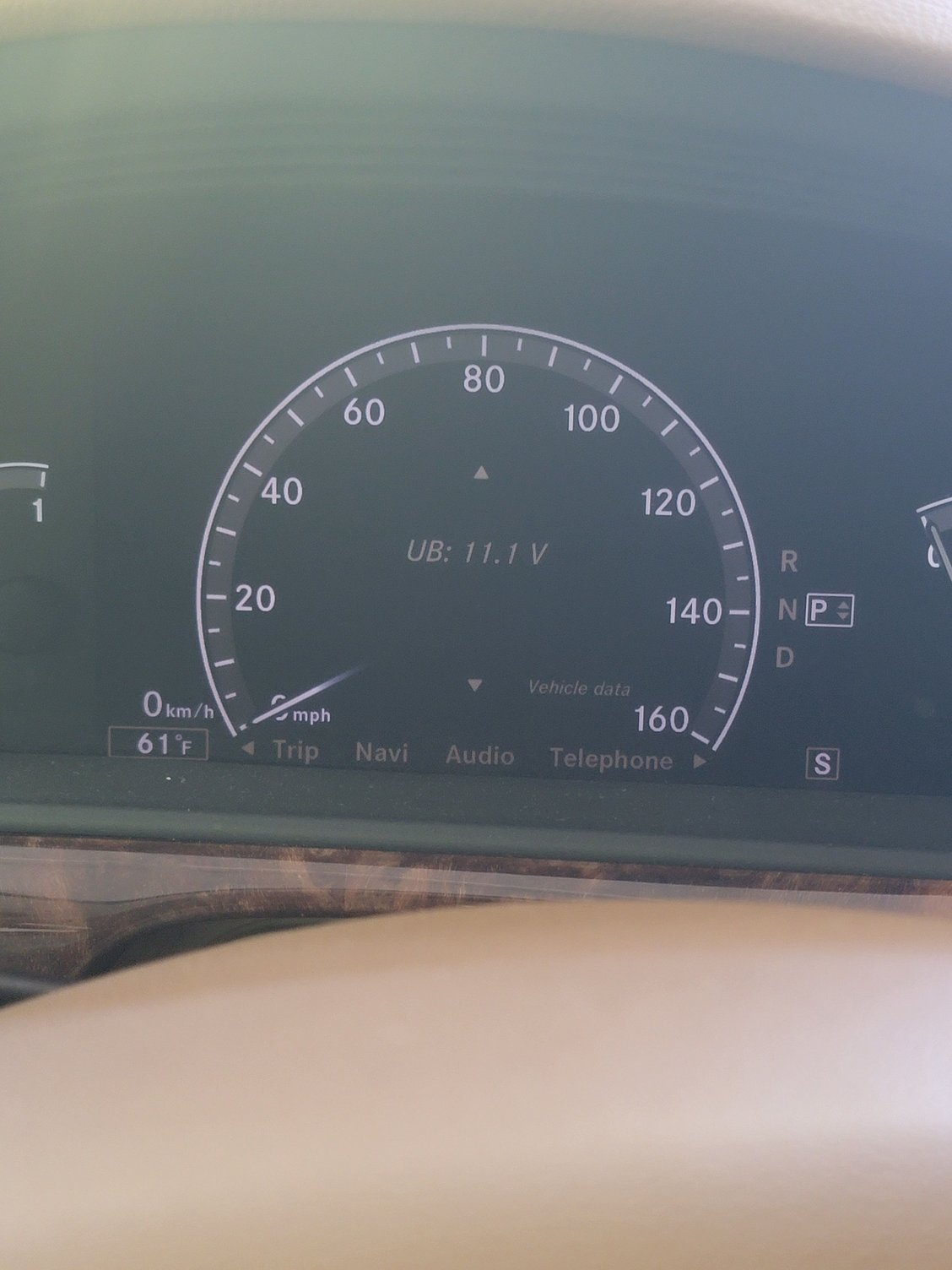

so we got a new battery and the problem still exists but no check engine light. still have code p0563
Old May 7, 2021 | 04:14 PM
Chris Lamb2's Avatar
Joined: May 2021
Posts: 40
From: Alabama usa
2007 s550
Old May 7, 2021 | 04:39 PM
konigstiger's Avatar
Posts: 15,901
Likes: 4,630
From: North Scottsdale, AZ
'71 Pinto
What about the alternator. Some more info to better understand system.
Old May 7, 2021 | 04:47 PM
Joined: May 2021
Posts: 40
From: Alabama usa
2007 s550
the alternator with the meter says it's fine, I do not have the keyless go option. I going take a video of exactly what it does, we have an appointment Tuesday to have it diagnosed on a star system.
