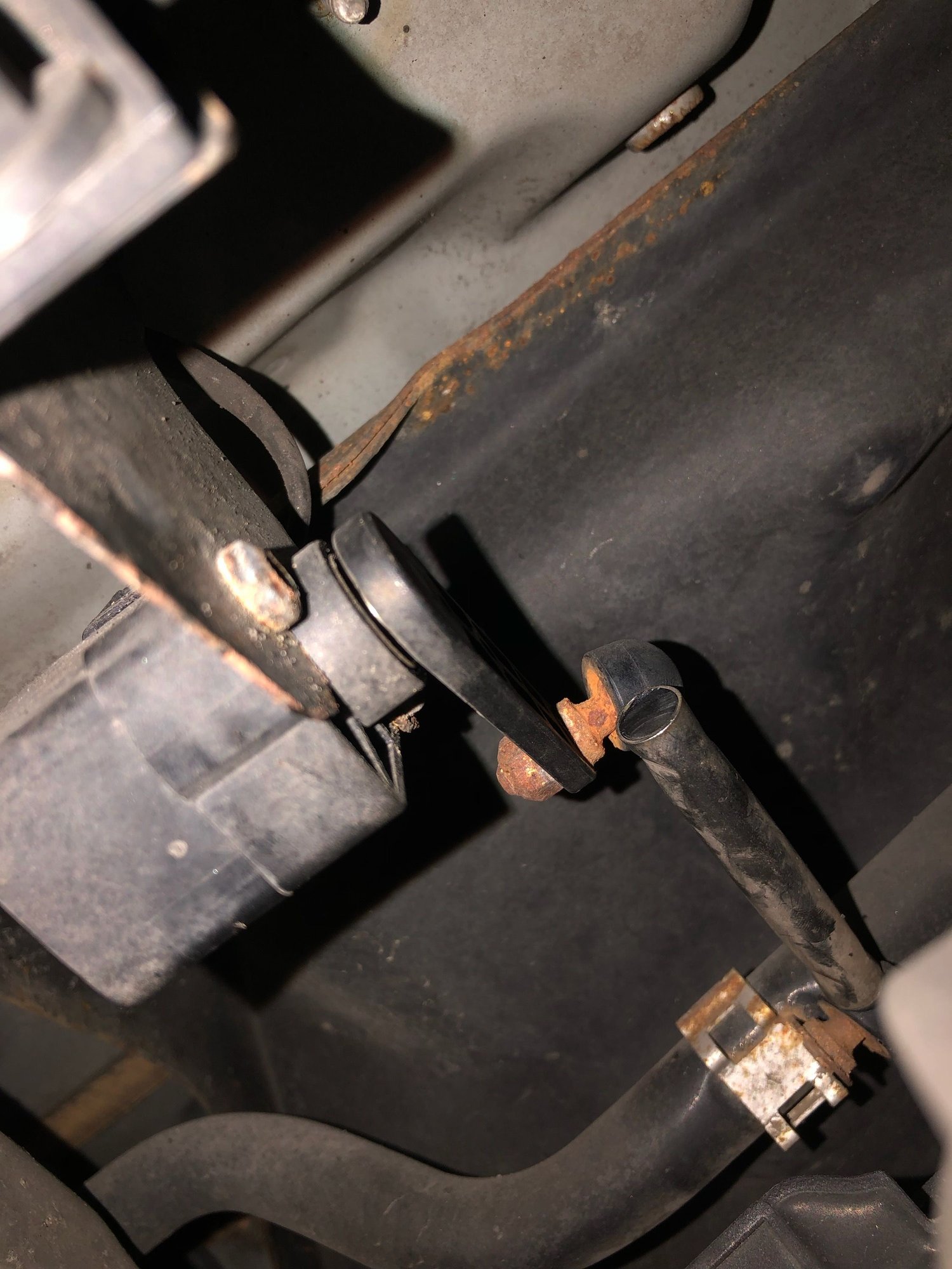

Hello all! I just went over several bumps in the road (well over 10) and my rear struts are both locked out at full inflation and very high. Should I disconnect the battery to reset the height to get the struts to lower? I have a 2010 4matic

I suspect you have airmatic and the level sensor snapped off (normal) - we had one just the other day did this.... BUT that is odd and a great failure mode that is likely to last about 20 second before a bump causes the sensor to fall (as its snapped off) and the car will crash to the floor where you MUST NOT drive it or it will write off the air bags
the install of a rear sensor is a horrible job - cheap part really nasty to fit - look back 2 months lots of pictures of a white one jacked up

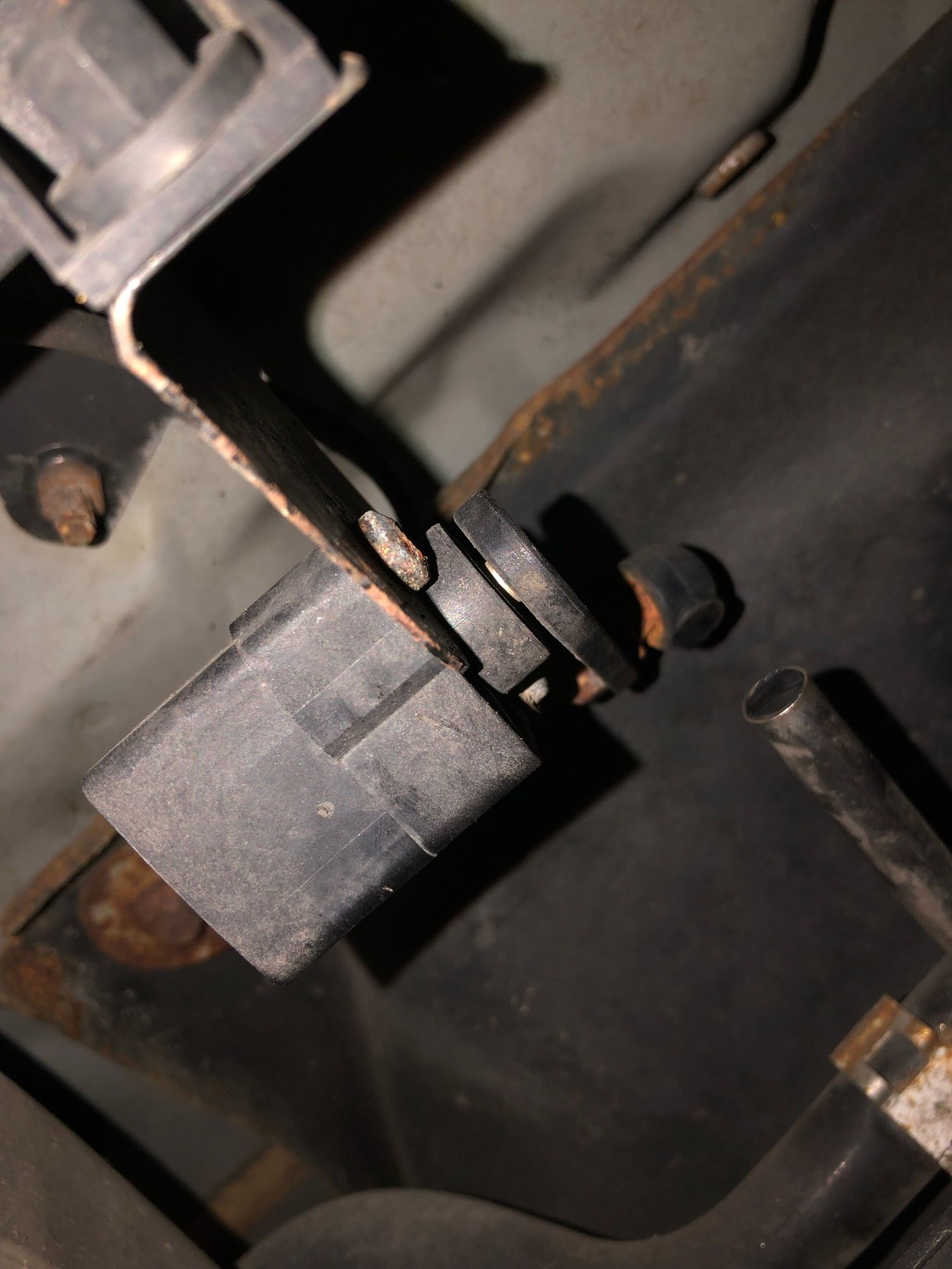

Spot on! I just snapped a few pictures of the snapped part! Is it that difficult to get to as it doesn’t seem that way at first look

I have a airmatic by the way and I am searching for the part now.
Mercedes in Maryland wants nearly $300 for the sensor and the aluminum/metal rod, need some help finding it at a better price...

the part is $30 you don't need the sensor, usually just a link rod (the way a metal ball can seize in a plastic joint has to be seen to be believed)
the NASTY part is the ball attached on the anti-roll bar. Its a clip on job and impossible to do in situ - on mine the 4 little metal bits that allow it to flex a smidge all just snapped off (you could be an animal and try and leave that ball if all 4 elements seem intact) there's a flat on the bar so the ball sits in a given location to help the ride height come out in the right place
some loosen the ends of the bar and tilt so more room, but that damages the anti-roll bar bushes - totally undoing the roll bar so the arm is rattling about free might be the right way... to not bugger up the bushes and clip that nightmare bracket on

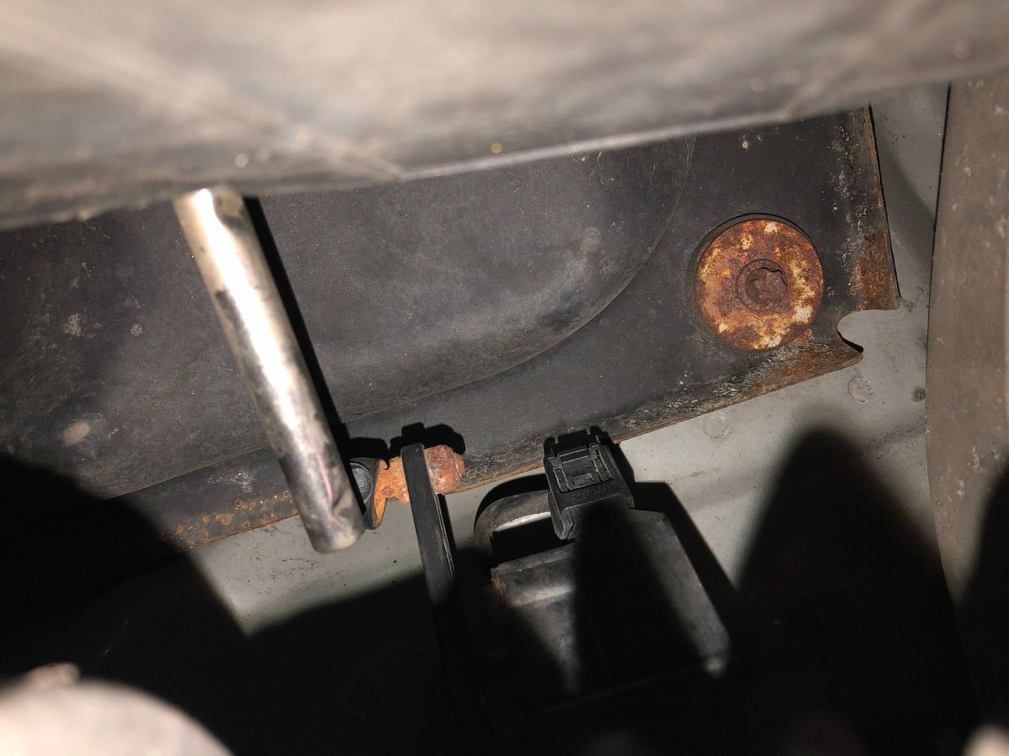

how the hell did you get such great photos, you can't see anything when under the car ????
you're not telling me the park brake mechanism in on the other side of a LHD car are you ? on RDH the sensor is on the left of the car, and the park brake (also on the left side) sits over it. And a 10 min job becomes 4 hours

The rear struts of the car are still fully locked and extended, so I was able to snap some quick pictures. I didn’t try to move anything as when I do, I will have the car on a lift.

My driver side is on the left side of the car ( when sitting in the car I’m to the left). The sensor is on the left side of the car as well. I’m hoping this does not mean my job will turn into 4hrs, does it?

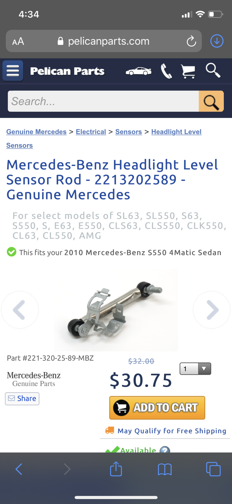

the part is available separately - its a link rod with two ***** attached they are about $30 (should be $10 !!!! the plastic bits pop off the ***** easy enough - when new ) it doesn't show on the part drawings I've seen and it doesn't look like the bit in the pdf doc konigstiger gave. ITS NOT part 10
one bolts on the sensor arm and the other has the mad anti-roll bar clip on bracket attached - it might be the worst possible job on the car - dealer destroyed 2 trying to fit on my car
more like this
https://www.mercedespartscenter.com/...amp-2213202589
https://www.pelicanparts.com/More_In...-320-25-89-MBZ

thanks Botus! Would this be the part number 2213202589? Check out the pictures please and lmk if you think any of this is my needed part ... https://www.pelicanparts.com/More_In...-320-25-89-MBZ

Not sure why I didn’t see your post prior to mine on my pc but showed up on my cell... thank you! I found that previous thread you spoke of as well... pasting it here for anyone else who is experiencing or will experience the same issue (hopefully you won’t!) Also is this a 10min job or 4 hr that you posted about?
https://mbworld.org/forums/s-class-w...ic-2007-a.html

Appears I have the parking break mechanism in the way of the rod and sensor....not sure how to remove it and am now in search of an Indy shop in n the Aberdeen to Baltimore Md area to do the job, any suggestions I could use them....

its a fixed length you fit it (with the lever the right way round), the car gets over itself.... in fact it should have been sitting funning as it was seized … you have two (different part number) on the front that are an easy job - they will be seized as well - if you found the other post he managed to muddle up the link and fit I guess on the wrong side
the rear is a nightmare - but if you disconnect the rear anti-roll bar at all four points (if those bushes are easy to reach its should be quite do-able). leave it with the bushes in the middle connected and its impossible without damaging the new metal bracket
unless they modified the actual sensor with a spring so it goes full height instead of full down you MUST NOT DRIVE IT EVEN 10 YARDS
