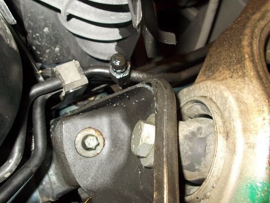

I noticed some oil spots in my driveway from my S600. There was also some oil in the garage which I didn't notice because the floor is painted. I checked the ABC reservoir and it's correct running and not running. (Not relevant here, but IIRC, you can tell if your ABC accumulators are good because the ABC dipstick will go to the upper mark when not running and drop to the lower mark when the accumulators are compressed with oil after starting.)
Anyway, the power steering Pentosin was a little-- a few ounces-- low, so I'm assuming that's the source of the leak. Here's something I found in a parts diagram:
#8 is the PS, but I'm not sure exactly where all the hoses run... With ABC, the V-12 has lines running everywhere. IIRC, the ABC and PS share a tandem pump but are isolated from each other.
So, I put the car on jack stands and removed the belly pans. I started the car and ran for almost 30 minutes, hoping to see the source of the leak. I got not one drop of fluid!!!
That's looking up at all the spaghetti running under the left front. Note how the accumulator is damp from oil, along with other lines, like the dripping must be coming from above.... Clearly, it's leaking but I can't see from where and can't get it to leak while up in the air.
So, I'm out of options and wondering if there's a common failure point on the PS system???

Dale, today, I removed the air filter box, wheel and fender liner to get a better look. That didn't help very much but I was able to get eyes on the tandem pump and connections. Good thing or not, I'm pretty sure there is no pentosin coming from the pump.
I ran the engine again with wheels in the air after wiping down the damp spots. Could still see no leaks... So, I put the wheel back on and lowered the wheels on to 2 X 6's so I could still get under the car. Ran the engine, turned the steering wheel and raised and lowered the car with the dash switch.... Still no obvious leak; not even a drop accumulating.
I'm baffled??? I'll try putting a few miles with the undercarriage covers off and report back... It's raining out, so don't want to muck stuff up w/o covers.

I would try to wash the engine from underneath first. Especially the area where the leak is. Just use caution and cover any electric connectors down there. I have done it plenty of times when looking for a leak. That would make things easier and pinpoint the leak. As a matter of fact my friend just purchased a 2007 S550 last week that it is seeping pretty good on the front passenger side. So we washed it and now he is driving it without the belly covers. This weekend will go under again to spot the leak. Good luck!

Wait a tic... have you checked both the sides of the engine to make sure you're not just seeing a seeping valve cover gasket? THAT most certainly IS a known issue. You ought to be able to see enough of the ABC/PS pump to know if it's covered with oil or not. I had to replace my starboard valve cover gasket; the old one was hard and the side of the engine was soaked with oil. That can kill your coil packs as well, so it needs to be fixed if it's happening.
Another common source of leaks is the electrical connector on the front starboard side of the trans, but usually transmission oil is pretty easily identified by its color... unless it's REALLY bad off.

Just so y'all don't think I imagined this, the pic's in post #1 proves there was oil dripping and I'm sure as hell it was pentosin.
As mentioned, I wiped off the drips, ran the car on the ground and couldn't see any leaks. Well, it finally stopped raining here and, I made a 90 mile round trip with belly pan and left inner fender liner off. It's 93F outside and ran at triple digit speeds (kph, of course-- Ha).
Not a drip insight. WTF... Even most of the damp spots are gone. (I'm guessing pentosin will actual evaporate, especially in the Texas heat.)

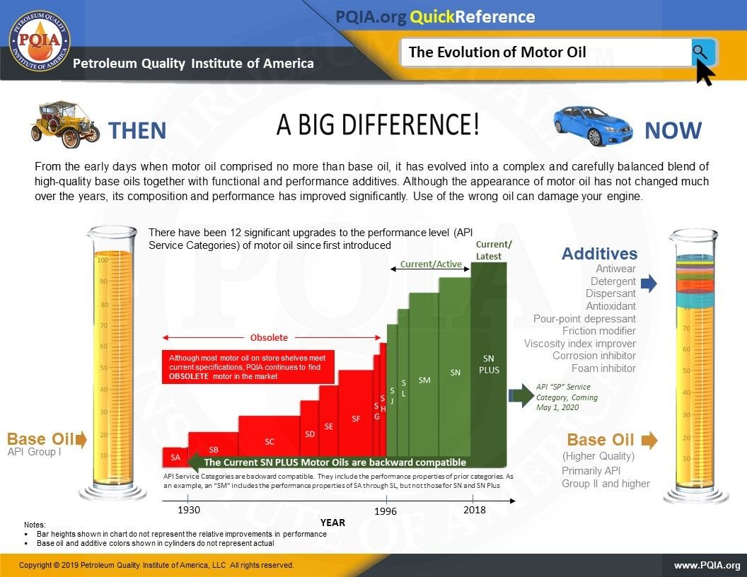

the world of Oil is so different from when Mobile one came out everyone else moved on to signify the step change - maintaining an old name isn't helpful
and if you watch the first video the America slags of the USA API standard as obsolete - and mentions that ACEA categorisation is far better.... the car comes from an ACEA not API region

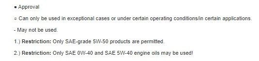

Muster 221.176
Class S
Model Saloon (2005-09 - 2013-06) V221
Sale designation S 600 (5.5L 380kW / M275)
Note Restriction: Only SAE 0W-40 und SAE 5W-40 engine oils are allowed! When using certain specifications/SAE grades reduced engine oil drain intervals have to be considered, see operating manual or service booklet of the vehicle.
Oil change quantity (with filter) 9 Ltr
MB-Approval 229.51

Dale, I don't remember where I came up with Mobil 1 0W-40. I know it was recommended in my 911 and had some laying around. I'm sure I verified it was correct for the V-12 but frankly, don't recall. Thanks for the confirmation. (BTW, for the V-12, 9.5 quarts is the exact measure for oil when draining from the oil pan drain plug-- which I prefer to the suction method. With no dipstick, it's hard to get an exact read on how much oil to add.)
BOTUS, here in the States, Mobil sells something they call "European Car Formula." I don't know if it's any different from plain ol' Mobil 1, but it is MB 229.3 and 229.5 approved.
Here's something else I found in the MB Maintenance Booklet:
Engine type MB sheet number
113 229.5
156 229.5*
272 229.5
273 229.5
275 229.5
642 229.51
*Restriction: Only SAE 0W-40 or 5W-40 engine oils may be used.
Just to be sure, I checked the MB guidance and it seems they aren't sure or changed their minds:
Their booklet says use whatever weight is correct for the climate. But their spec says:
I think Mobil 1 European Car Formula 0W-40 is the safest bet....
