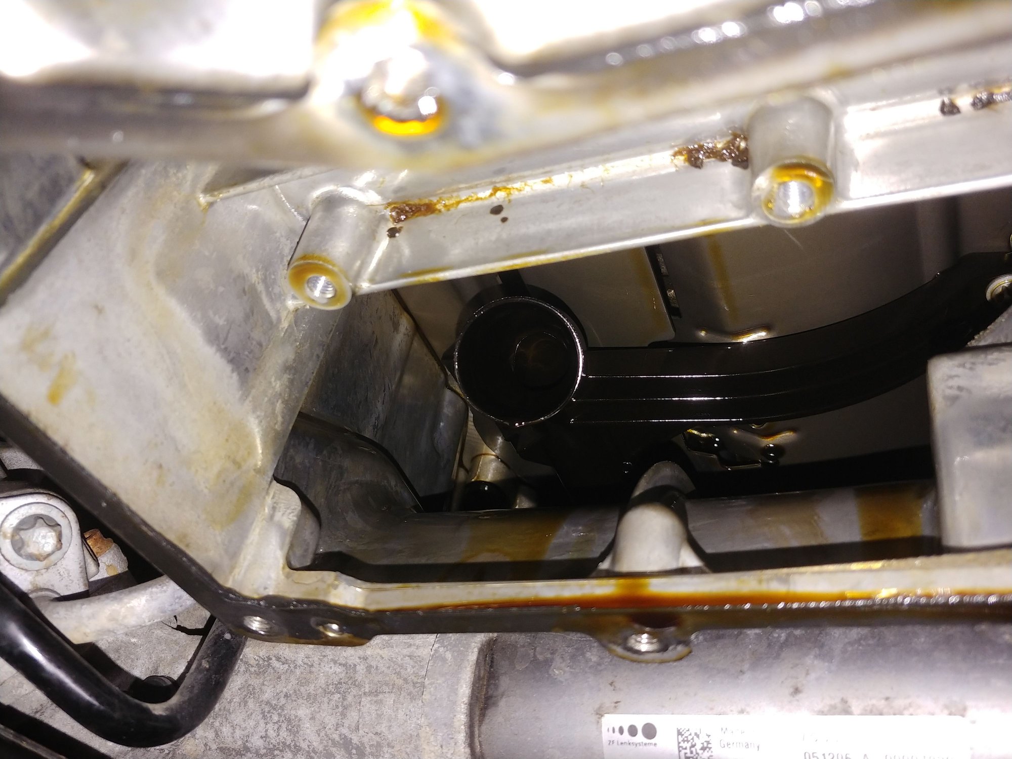

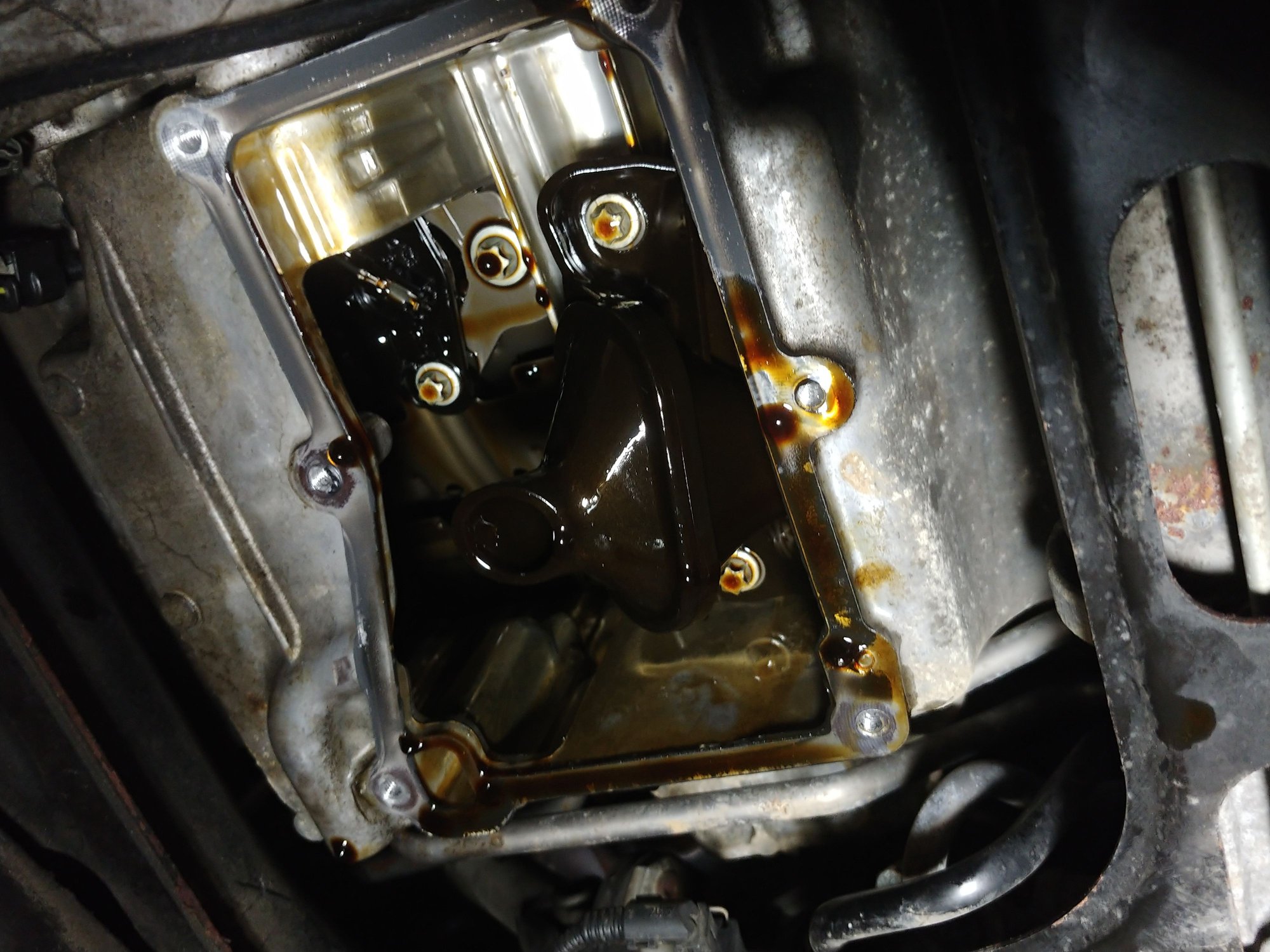

Alright took a closer look. If I am not mistaken the plug is in a totally different place on the 4Matic and is near the 6 bolt lower oil pan cover. I can tell because it is a 2 pin plug with only 1 wire used. I looked at my new sensor and it also has only 1 wire used. So I am feeling good about this again. In the middle of rear brakes at the moment but will get back to this....
Old Dec 30, 2021 | 06:46 PM
kevm14's Avatar
Joined: Jun 2020
Posts: 2,138
Likes: 870
04 E55 AMG (totaled), 07 S550 4Matic, 14 E63S

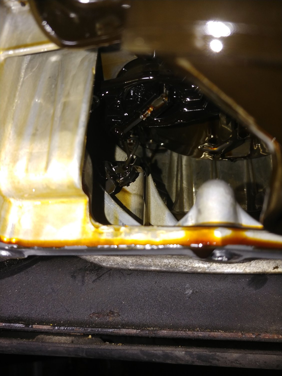

Pulled that pan. The sensor is up there but it is very tight. I think I need to pull the oil pickup so I can at least get my hand in there. But I need an O-ring in hand so I will be confident I can get it back together...

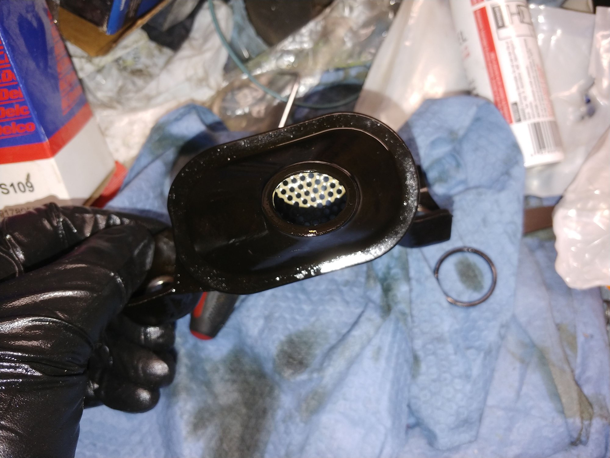

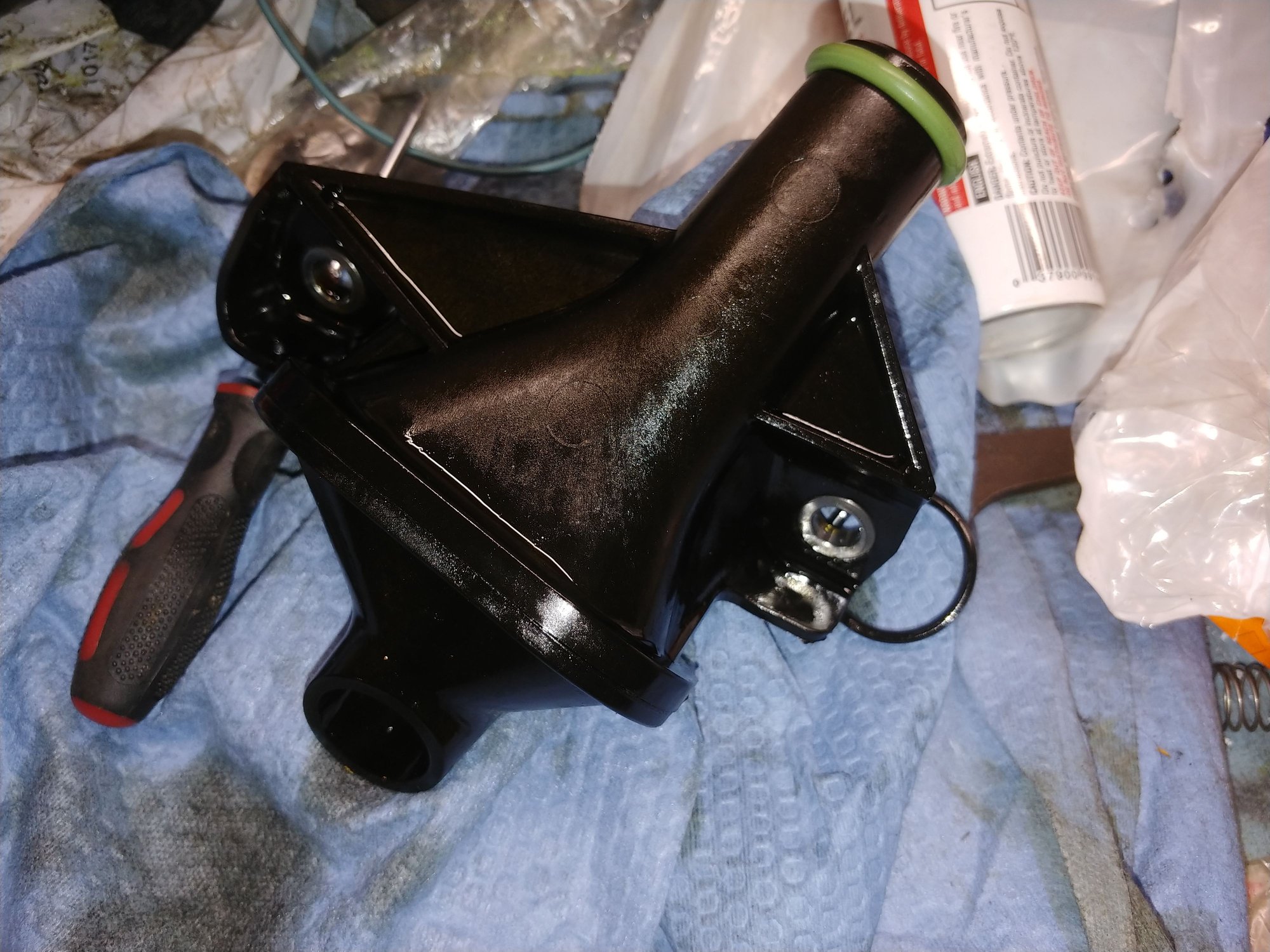

Got the two O-rings. Looks like the smaller nitrile one fits. I tried to squeeze the thicker Viton seal in as I know that's a much better O-ring material but it just didn't want to go in and I didn't want to break something.
With the pickup out of the way it was definitely easier to tighten the plug bolt on the oil level sensor. Still annoying as I still had to do it with a closed end wrench (fun fact: a 5/16" works on an E10 head). But I got the sensor back on.
Then I did the pickup. Also easy. Wish the black O-ring fit a little tighter but oh well. The old one was square and starting to get fairly hard (not totally brittle yet). Kind of seems like a service item you should do every 10 years. I know it's a big deal on my E55 and NOT easy to get to on that car.
Also it took a long time to clean off the pan and cover surfaces to prep them for new RTV. Maybe the most annoying part of the job. But I got it done, goobered some stuff on the pan cover, smeared it with a clean glove finger and slapped it on. Torqued to 10 lb-ft in some kind of pattern.
I let it cure for an hour (went on my walk) and during that time it occurred to me that I did not put the drain plug back. That was correct, I had not. Geez. So I put on a new copper washer and put the drain plug back. 25 lb-ft is what I did. Then I attempted to dump 9 quarts of oil in.
I say attempted because this is where I made my patented stupid mistake. I added a full 5 quart jug of M1 0W-40. Then I picked up the other jug and added 4 quarts. Only problem was I grabbed the 5W-30. So now I have to do another oil change but honestly it's not a bad thing because I was working inside the oil pan and despite my attempts to be neat and tidy I am sure I got some crap in there that was on my gloves or something. So I'll do another oil change soon and chalk it up as a flush.
But the good news is everything seems good. No leaks. Once I do the second oil change I'll worry about checking the oil level on the dipstick, hopefully see a perfect oil level, and then I guess hope I don't see the "check oil" message until the oil is actually a quart low or whatever.
I think there is an engine VIN break that specifies which to use. I suspect the Viton is for newer ones (begins with 60 I think) and mine is the older one (begins with 30), since I have an 07.
New sensor bolted in
Oil pickup tube
Oil pickup
Oil pickup screen
Identical jugs but different labels. They were next to each other. My bad.
All sealed up and torqued (i used 10 lb-ft)
