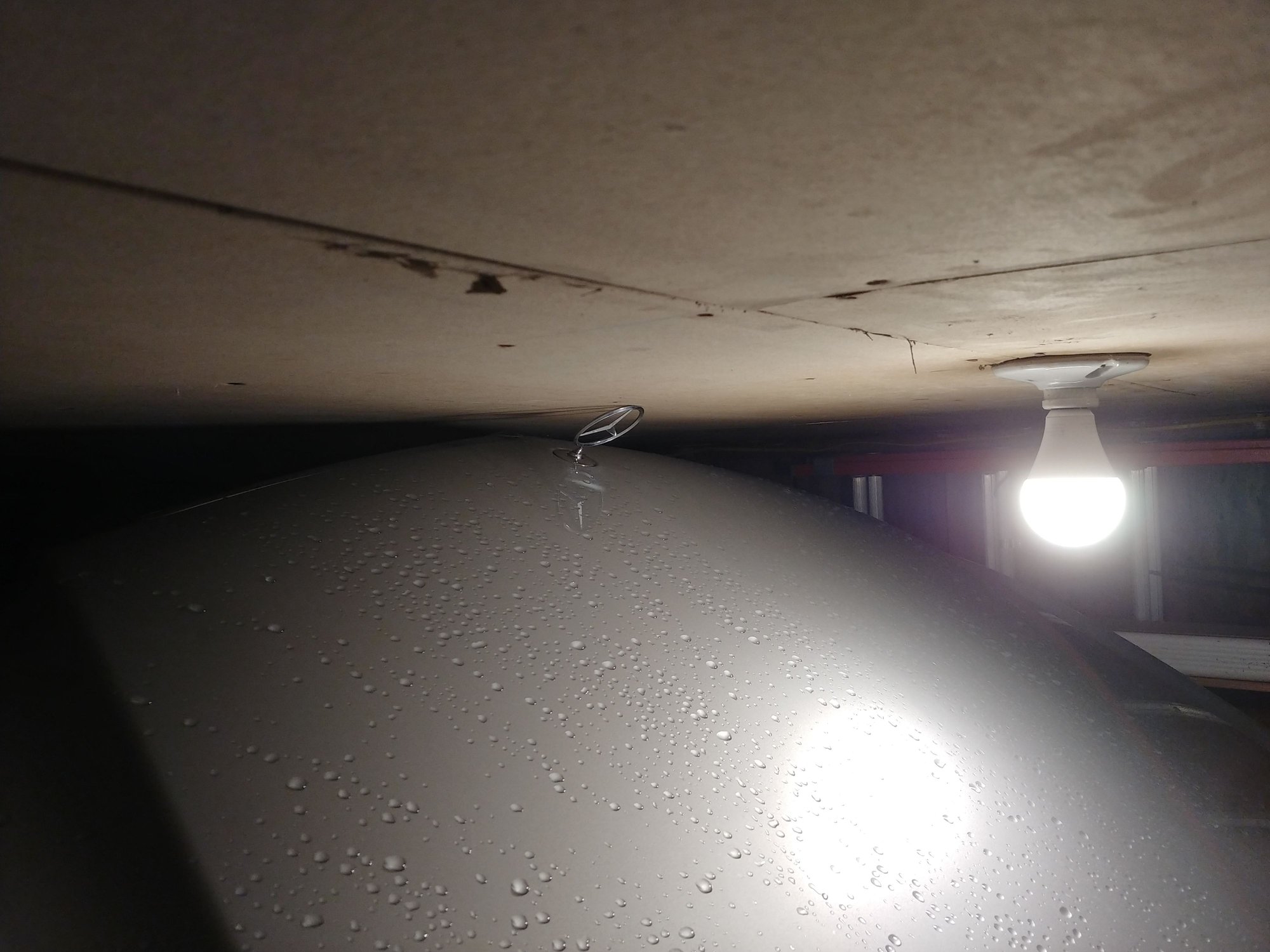

It is on a Quickjack 6000ELX
Tons of room and enough to use a creeper
Star just touches ceiling. I know my garage ceiling is low...
