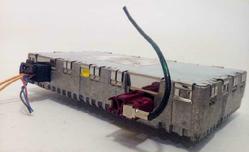

the DAB tuner sits on the left rear wing behind the amp and tv toward the tail light - would be interesting to know the part you have.
its sits at a funny angle ready to read the label - not inline with everything else - well it does on the S class

On the video i posted is that not the DAB in front of the amp?
Also whats the red flashing light?

no that's the TV tuner with 4 antenna's that go to the rear screen
the red flashes I guess is light leakage of the info going round the MOST orange fibre optic network - you haven't cracked one of these have you that would make things play up - not sure it supposed to flash either

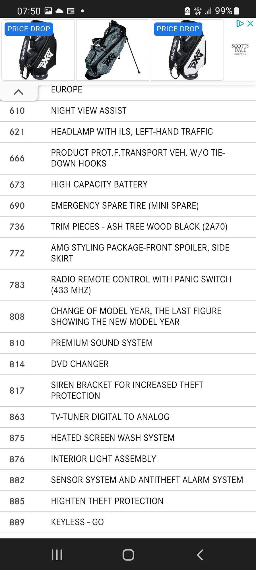

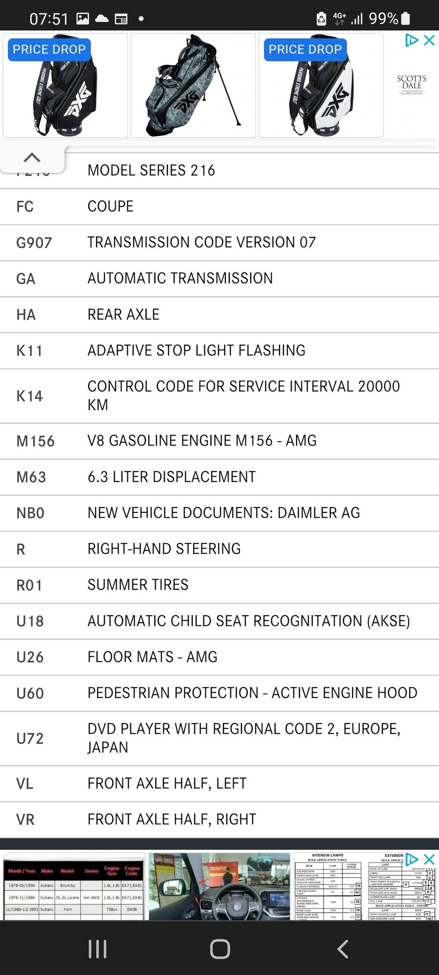

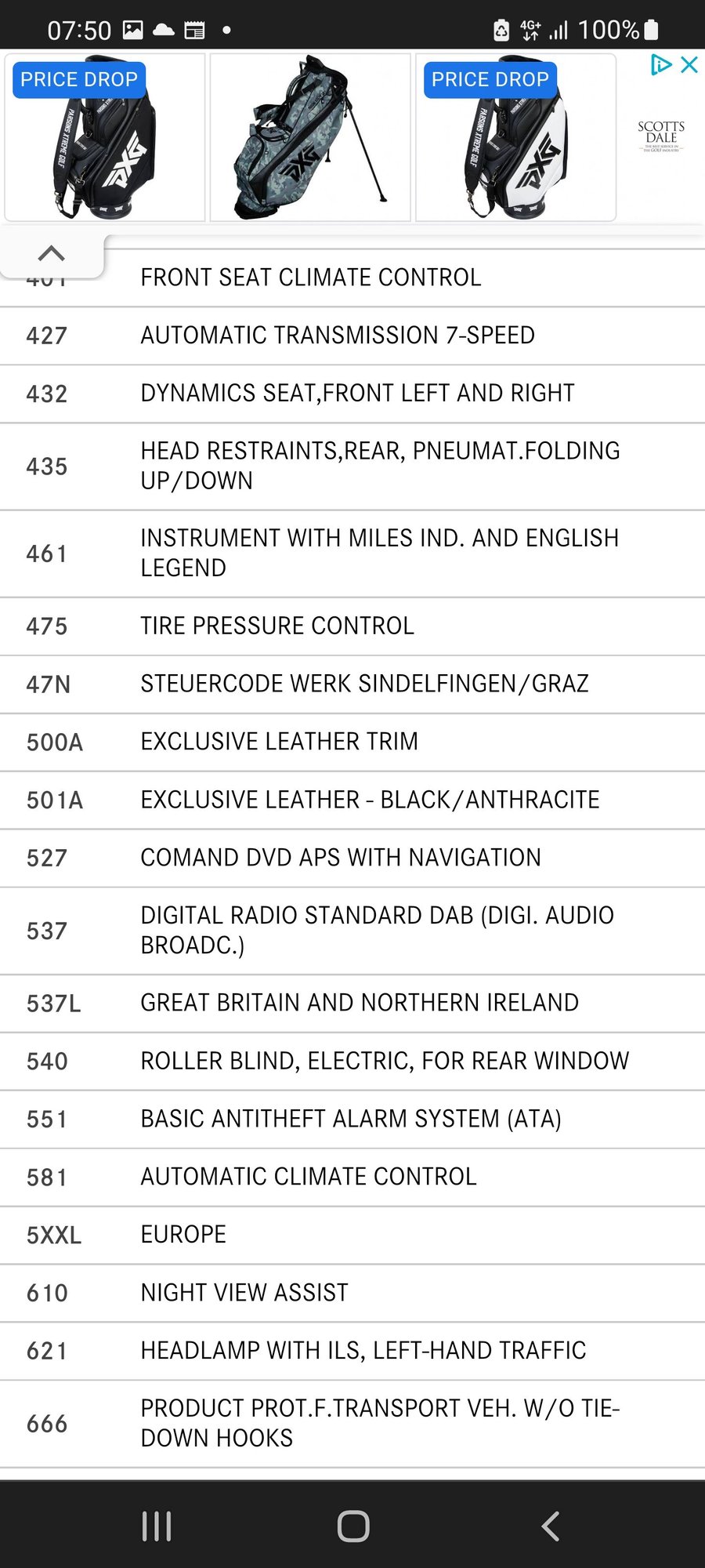

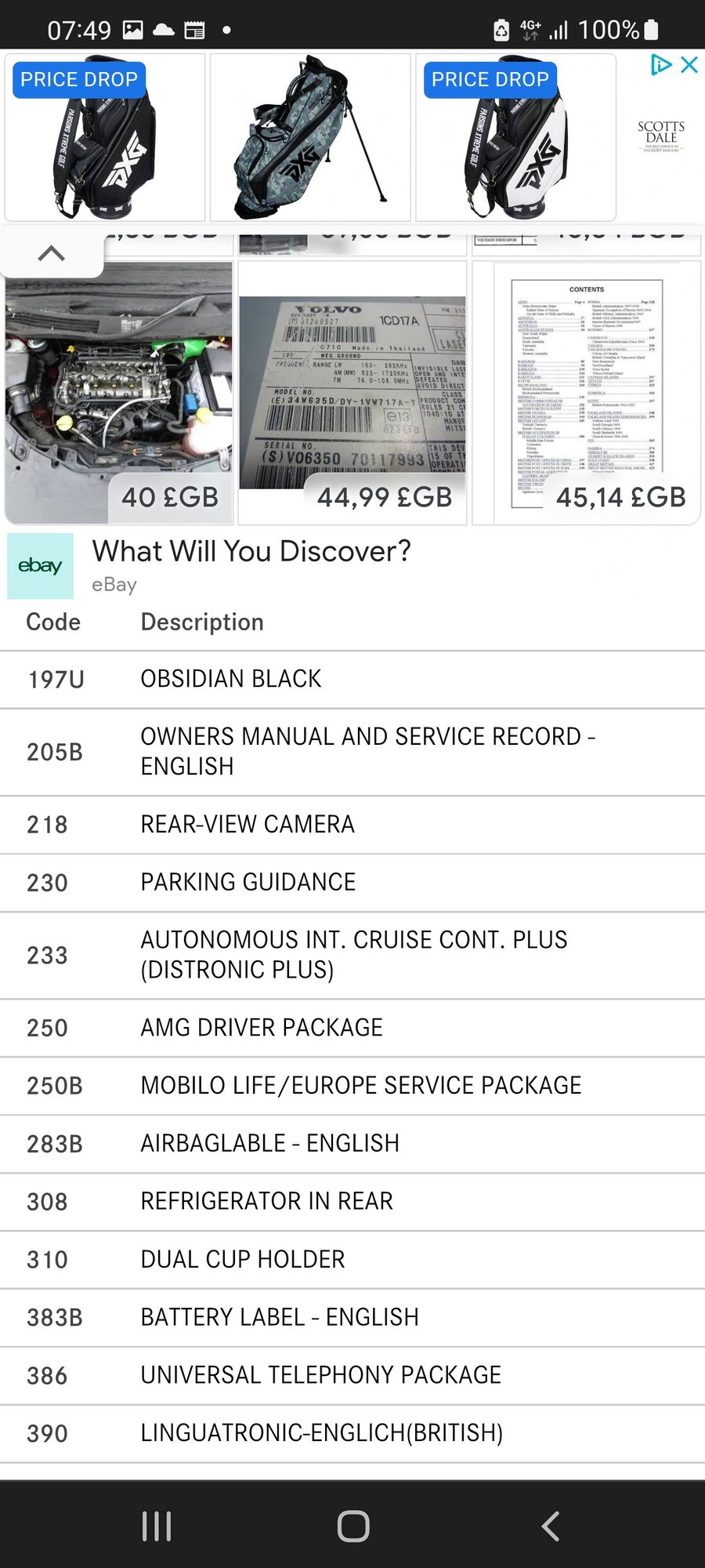

interesting - never heard a DAB unit fail - please post a picture of the label ???
DAB and AUX have nothing to do with each other
was DAB original fit ? - they can be an issue with the DAB position being inserted into the correct sequence of the MOST - I gather that's NOT supposed to be the case - but it was on my car that also has TV and its this that created the fun when it DAB was retrofited - if you go here and input the chassis number it will list what it was built with and or had professionally / legally added
https://www.lastvin.com/
NOTE due to some pretty dim Merc numbering you should see 537 TWICE if its really got DAB fitted correctly on a UK car
512 COMAND APS WITH DVD CHANGER
513 TRAFFIC SIGN RECOGNITION
517 HD RADIO
518 UNIVERSAL COMMUNICATIONS INTERFACE (UCI) / IPOD INTEGRATION KIT / MEDIA INTERFACE
527 COMAND DVD APS WITH DVD WITH NAVIGATION
530 COMAND DVD APS USA WITH NAVIGATION
536 "SIRIUS" SATELLITE RADIO COMPLETE SYSTEM
537 DIGITAL RADIO STANDARD DAB (DIGI. AUDIO BROADC.)
538 ATTENTION ASSIST (FATIGUE DETECTION)
540 ROLLER BLIND, ELECTRIC, FOR REAR WINDOW
not the
537L GREAT BRITAIN AND NORTHERN IRELAND
Here is the position. Behind the amp and tv tuner more towards the rear light. The DAB was the last thing i looped out, i had everything looped then when the DAB was looped it all came back on, minus the DAB. Then by a process of illumination i was able to rule out everything else. So no everything apart for DAB and AUX is working.
Interesting why the AUX isnt working? Command thought it may be the fact that although ive looped out the DAB i did put the plug back in minus the fiber optic so the system is still looking for the DAB. Interstingly the Bovee i have plugged into my AUX light up so i know its getting power, my phone connects to it but when i select AUX and play a song the sound just comes out of my phone!
I wanted to give something back to command for the help they gave me over the phone and they said they have a new dab unit for £517 but i can grab one off ebay etc. What they did say was it will need to be coaded in by someone with online Star, so thats going to be a nighmare up my way, everyone ****s them self when i mention the Audio system in these. I cant see why it would need coading? Im just gonna pick one up and see what happens, what do you think?
One thing for sure, and i checked, that the other amp i had the place in poland repair now works! Not bad either €300 worh 12 months warrenty
