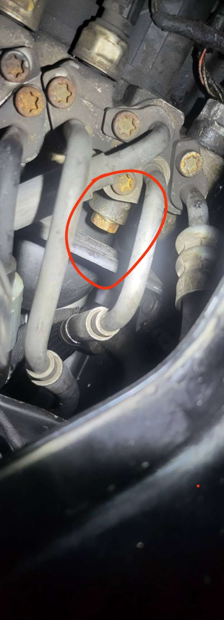

W221 Valve block ripped o ring
HI everyone,
I have a leak on the valve block, O ring that has ripped.
I'm trying to replace the o ring but its hard to reach.
Hope to get some help. how do process on this bolt with the o ring leak
the bolt that has an ripped o ring

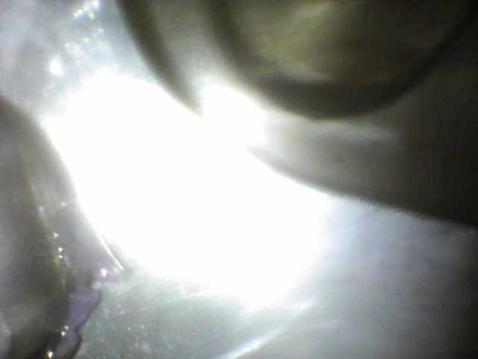

ripped o ring
ripped o ring
ripped o ring
ripped o ring
ripped o ring
ripped o ring
hard to reach, blocked by metal bar
