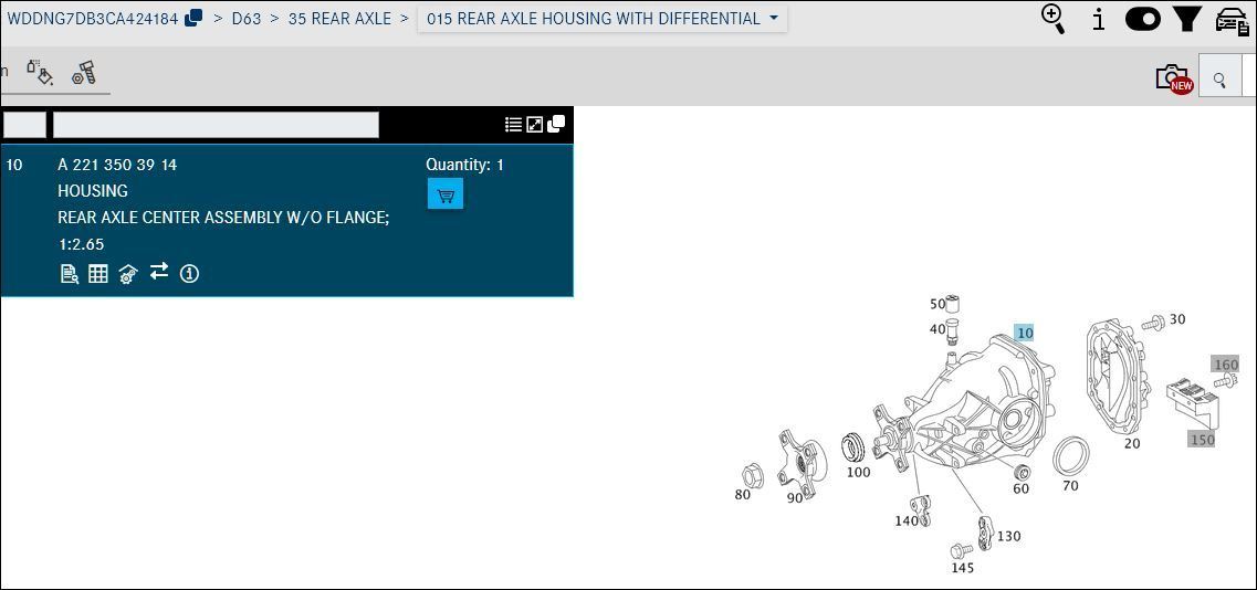

That seems to be the consensus. Need some help deciphering part #'s if you or anyone can help. The part # I was given by my parts department was 221350391480. I've been scouring ebay and have found a variety of differentials available for the 2012-13 S550 with the M278. All of them share the part # 2213503659. Obviously this does not match but its consistent across the ebay diffs I've found. I'll link an example below.
https://www.ebay.com/itm/16431223652...66ce%7Ciid%3A1
Old Aug 6, 2022 | 09:55 PM
chassis's Avatar
Joined: Sep 2018
Posts: 14,678
Likes: 4,578
From: unbegrenzt
2017 GLE350 4MATIC
From memory the ratio is stamped in the axle housing. Maybe also the ring gear diameter. It's been a while since I was under my vehicle looking at the rear axle.
EPC the the gospel here. Crawl under your vehicle and take note of all markings. Then use EPC using your VIN and confirm the part number and gear ratio.

Provide VIN.

Provide VIN.
WDDNG7DB3CA424184. Hello from Scottsdale!

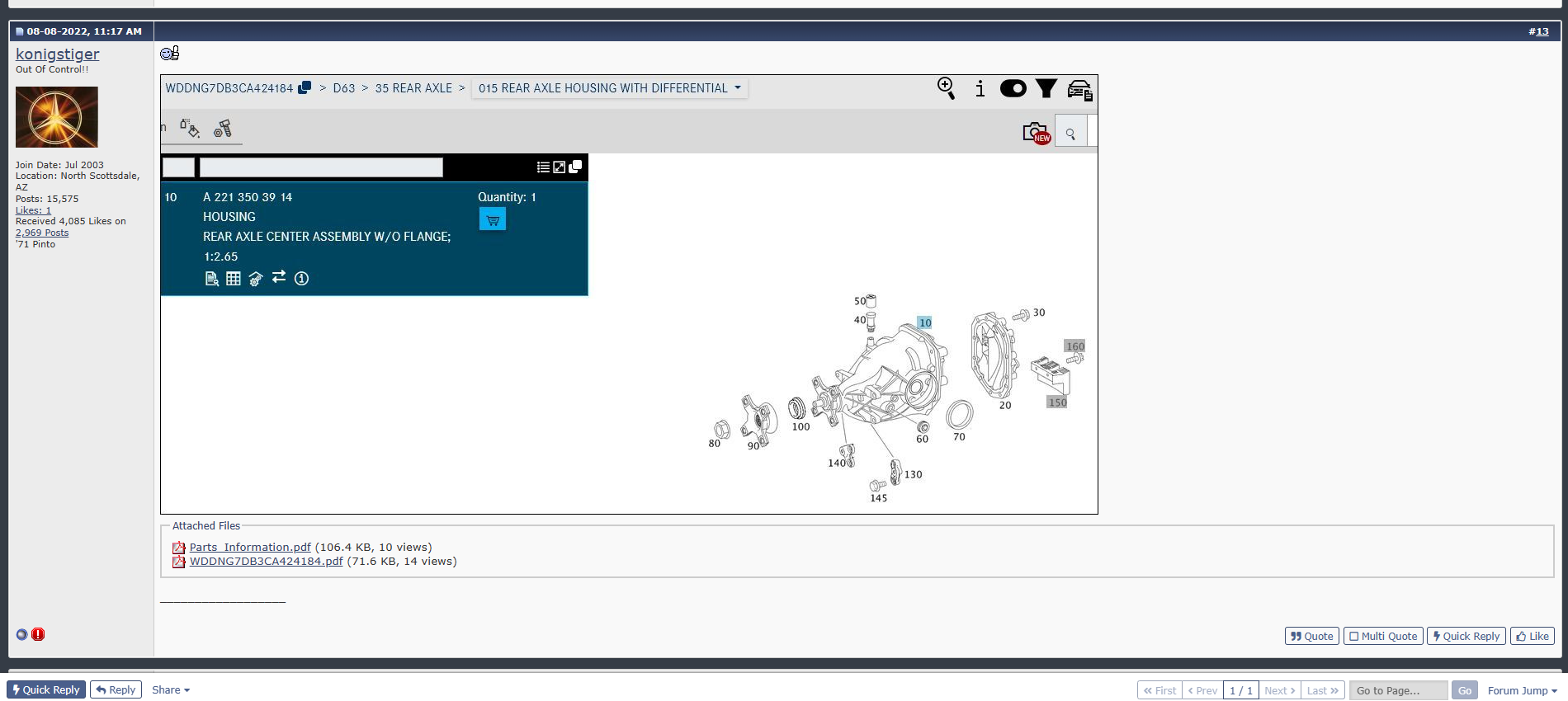

File Type: pdf
File Type: pdf

And Konigstiger provided the part numbers in this thread up above.

No pics of bearings in that screenshot.
Mercedes part numbers will be different from the SKF part numbers on the bearings. Use the part number on the bearings when inquiring at a bearing shop. MB part numbers at MB. If OP is going to replace bearings a pinion seal will be needed.
