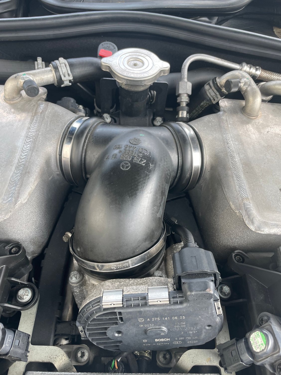

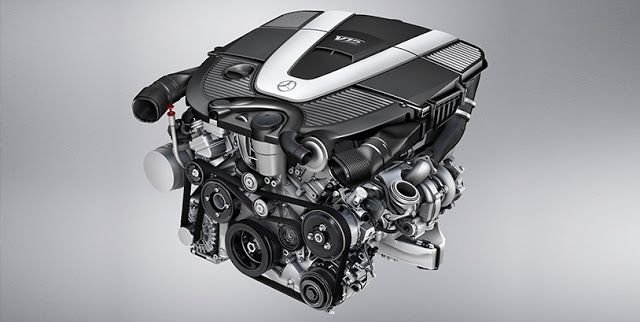

That is what I was hoping to hear. Abs sensors are fixable at short notice. The throttle is bit bigger issue. I think my car has two throttles. One has actuator. I think they are not so easy to access and clean or remove and clean. I am not sure where exactly they are.

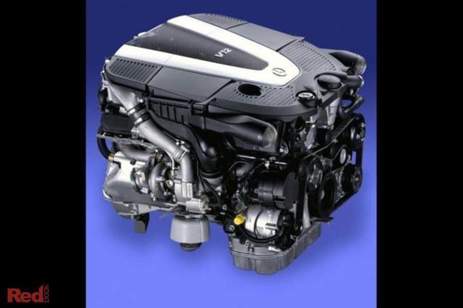

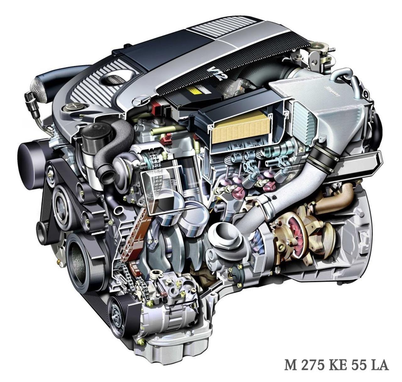

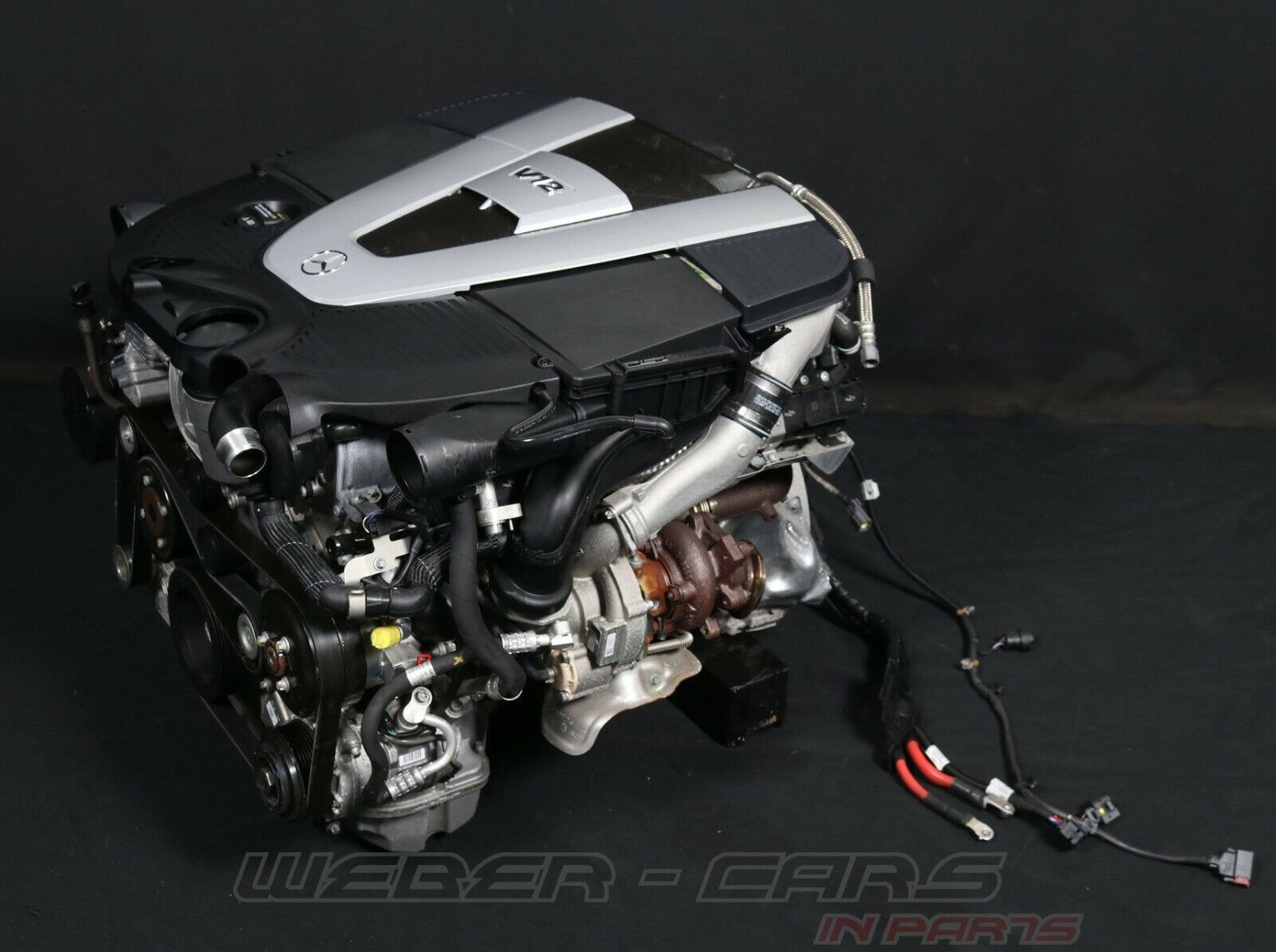

Only one throttle body on the V12. Under the Y Air Pipe at the top of the engine. Keep us posted.

On your second pix, look directly under the V12 insignia and you will see part of the Y Air Pipe connecting to a square component. I would do the ABS wheel sensors first. Your throttle body issues may clear.

started working on the throttle. Need advice how to get out the Y piece in order to access to throttle. It is hard plastic. Not sure whether one of the metal parts left or right has to be released first or can it be done without doing it. I released o rings. But it has no space for maneuver. tried also to rotate it vertically but no success.

if all three clamps are loose, get some silicone spray on the back 2 in the pic - will it rotate upwards and get you clearance ?
otherwise at least one of the "intercoolers" (guessing no idea what they are) will need to move
check that water level somewhere - on a V12 its usually an empty boost cooler bottle under the engine cover - and it throws errors and drops shed loads of performance as its always empty...
